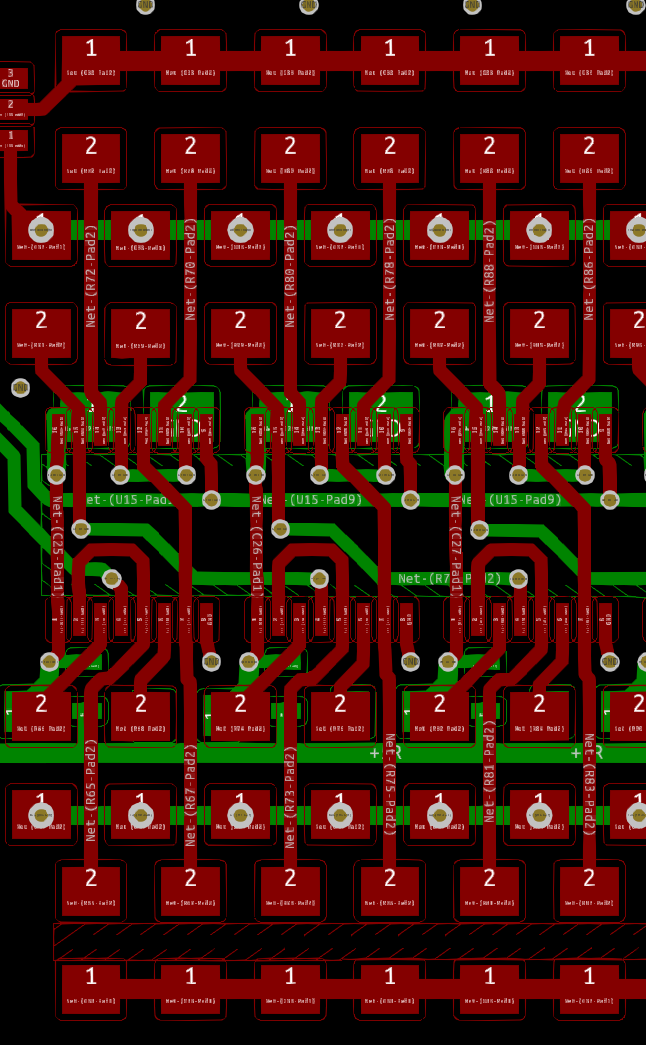

I assembled the DSC layout on the differential FF 74VHC175.
Works badly. I again hear noise (murmur) as in the original non-differential DSC1 scheme. The overall noise level also deteriorated compared to v2.5 and v2.6.

Just looking at your pcb & I first thought you had the wrong pinouts for the 175 FF but I think I see what you did & I'm wondering if it might have a bearing on the imbalance between Q & Qbar outs?
Correct me if I'm wrong but you seem to have no output resistor connected to Q1 output - instead you connected it to D2 (under the chip?) & the output resistor is connected to D2. This is the same scheme used throughout. I wonder if this is one additional source of imbalance between Q Vs Qbar outputs?
Maybe others can answer the implications of current being sourced/sunk at the Q pins but the pcb trace having the D input pins as spurs off this trace.
Alternatively, when you think about the design - connecting D inputs to Q outputs means that every pulse at D input will result in the pulse also being present on the connected Q output & causing a voltage spike through the connected resistor. Could this be the real source of the extra distortion? Normally it wouldn't matter when using FFs as a shift registers but when we have resistors connected to the Q outputs, it does, no?
I do not think that the resistor can significantly influence. I have retained measurements of the non-balanced version of DSC1. Very similar to the measurement of the version with FF. And most importantly, both options have an unpleasant correlation noise.
Yes, you are right, not all resistors are connected directly to the outputs of Q. With two-layer pcb it is difficult to do otherwise. But this is a minor distance ~ 3mm.
I want to say that the main problem is correlation noise, which was not in the previous version on AHCT595!
The fact is that in the scheme for FF we get a pseudo differential scheme. The signal is formed on a single shift register.
A variant with AHCT595 tru balanced. There are two symmetrical shoulder registers. And all the noise that appears due to mixing of a weak useful signal and analog noise is well compensated by the balanced circuit.
This correlation noise is very annoying. It appears as a tail after loud signals and looks like a murmur.
It seems to me that this option with FF is not worthy of further attention.🙁
