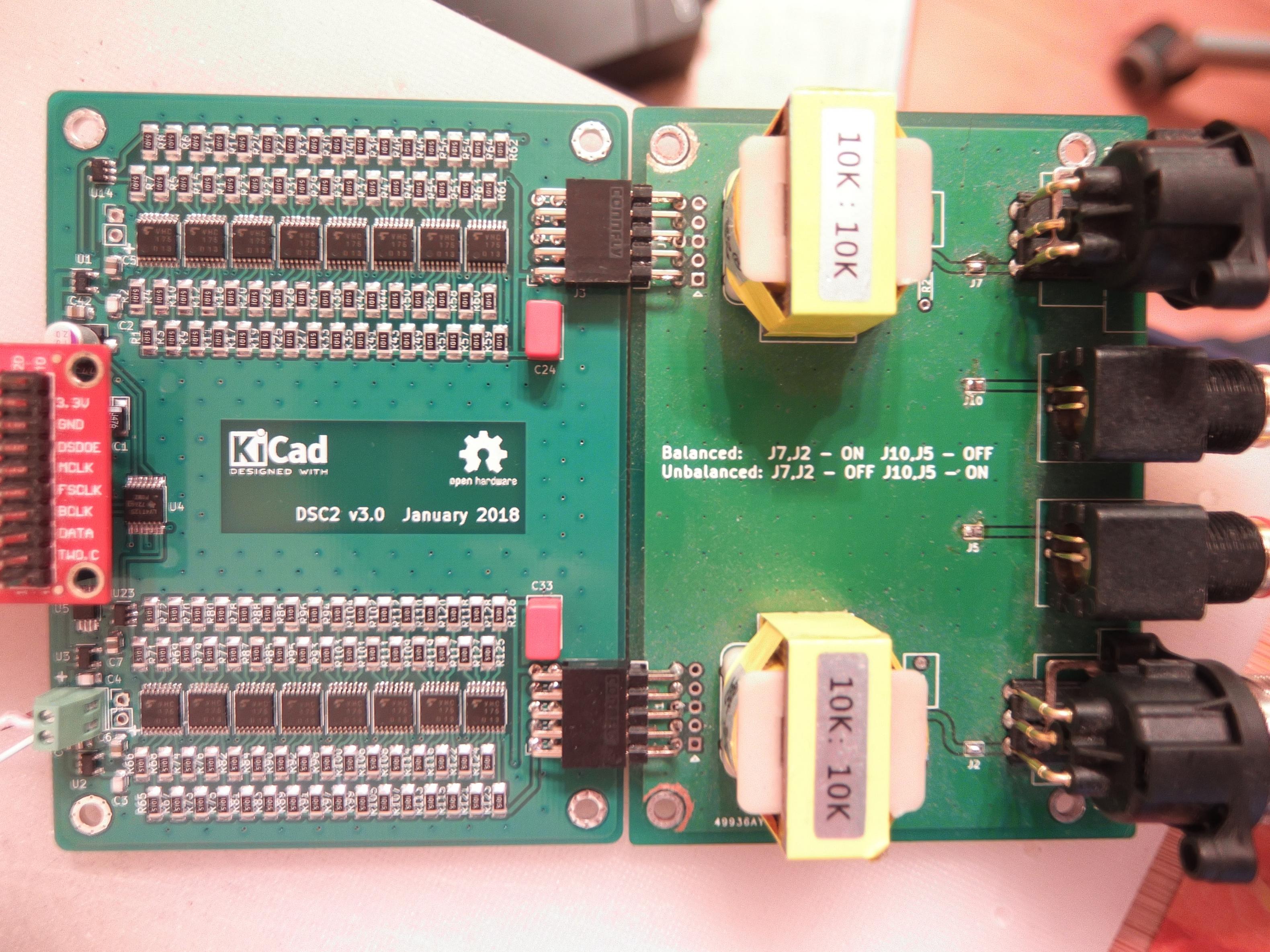

I have a question for you Miska - would it not be better to use differential OP flip flops for a balanced design?
I'm wondering if the bulk of non linearities are due to inherent non RTZ nature of DSD stream. As such I would think the fastest dif OP logic would give best results. Something like 16 x Potato 74G74 dual FF should work well.
Otherwise is it possible to integrate RTZ coding?
Now the DSD stream can be considered as fancy PWM generated by the modulator. For RTZ-like operation, one option I was considering to try out for DSC2 are fast analog mux chips. They have "break before make" behavior built-in. I'm a bit curious how it would perform in practice.
Using such differential FF is probably good option too.
At DSD512 speed, RTZ coding would be feasible with CPLD and provision for it could be easily added to HQPlayer (to take into account the 2x rate difference). So CPLD could "reset" every second sample.
Maybe I should put a small CPLD on DSC2? That would allow some experimentation...

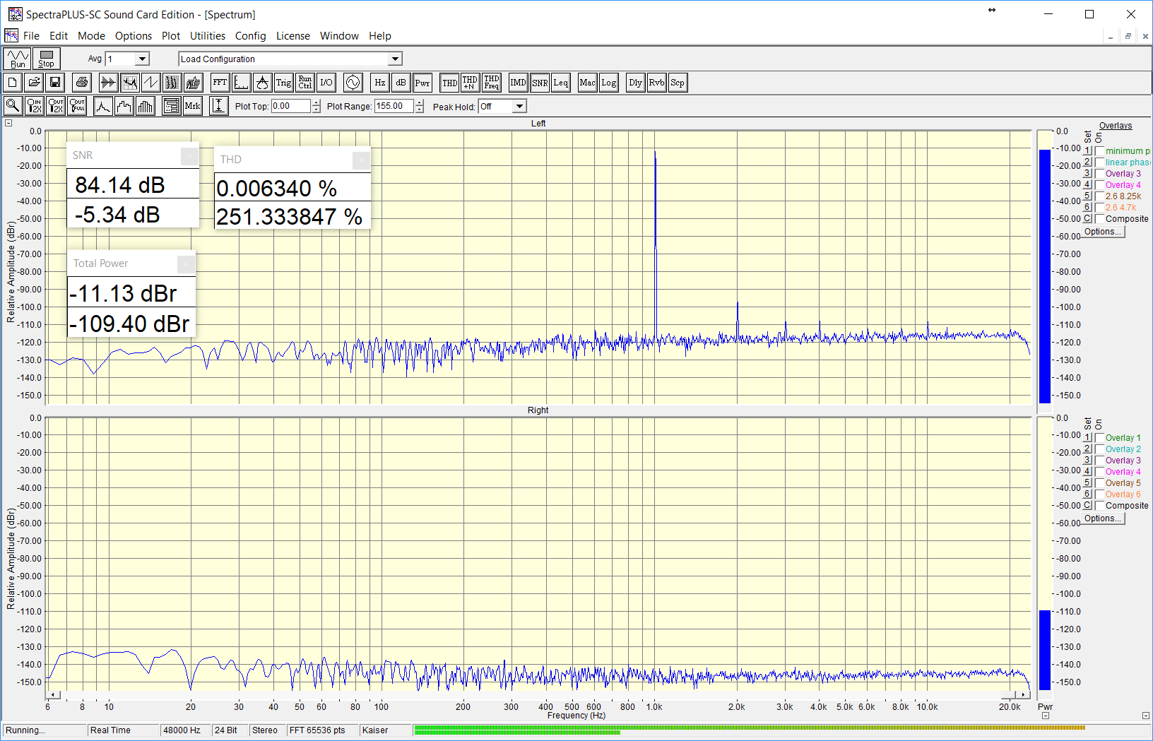

I assembled the DSC layout on the differential FF 74VHC175.Using such differential FF is probably good option too.
Works badly. I again hear noise (murmur) as in the original non-differential DSC1 scheme. The overall noise level also deteriorated compared to v2.5 and v2.6.
That seems odd? Any thoughts on what could be going on?
