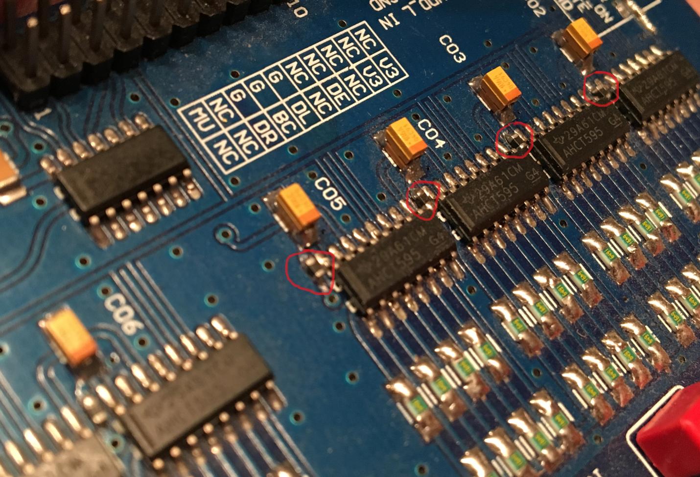

Perhaps noise are coming from the logic gate. I might try to put a ferrite bead after each resistor. There are various beads from Murata. I think it worth a try.
I already did this with a сhinese non-balanced board. The problem of noise has remained.

I have to buy an unbalanced version of DSC1-DAC because the seller was ran out of balanced board, very sad
What I did here is I soldered all components but not IV stage, and take the signal out before IV stage for measurement.
I measured output without playing dsd file; that noise is coming from computer via usb power supply through Amanero board.
I don't think I will finish iv stage of dsc1 dac because it's confirmed that there are noises while playing dsd file. So do you know any iv converter that is good enough for this dac (the signal very small 0,2mVpp with impedance change from 470 ohm to 15K ohm)? Or can I use transformer for isolating high frequency noises, if yes, what is the ratio of that transformer 1:1, 1:5 or other?
Thank you for your patience in reading my issues!
Power the Amanero with a better power supply and use it with an isolator;
