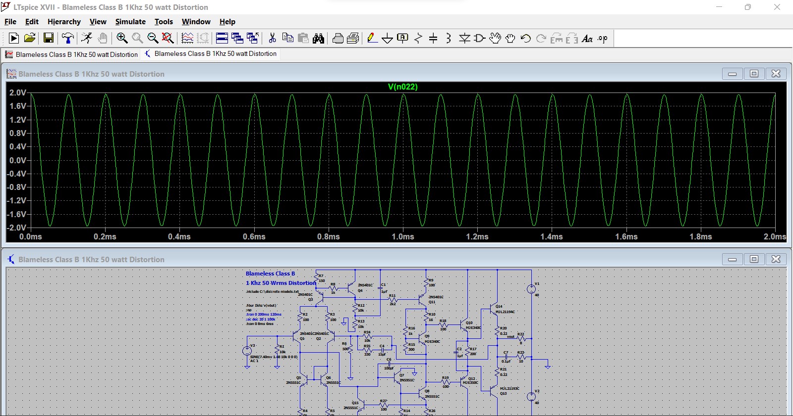

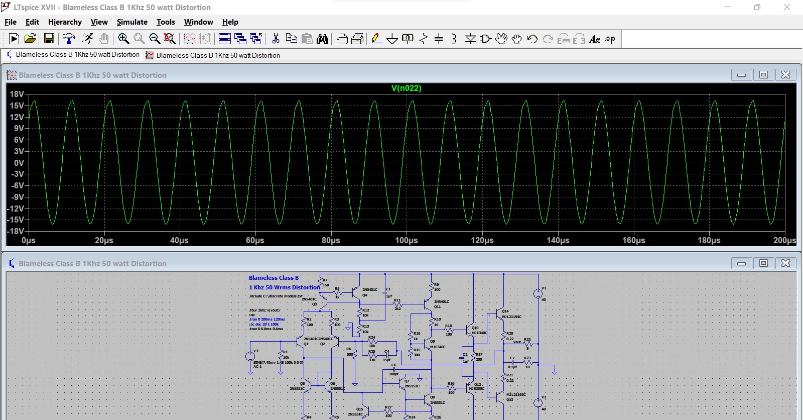

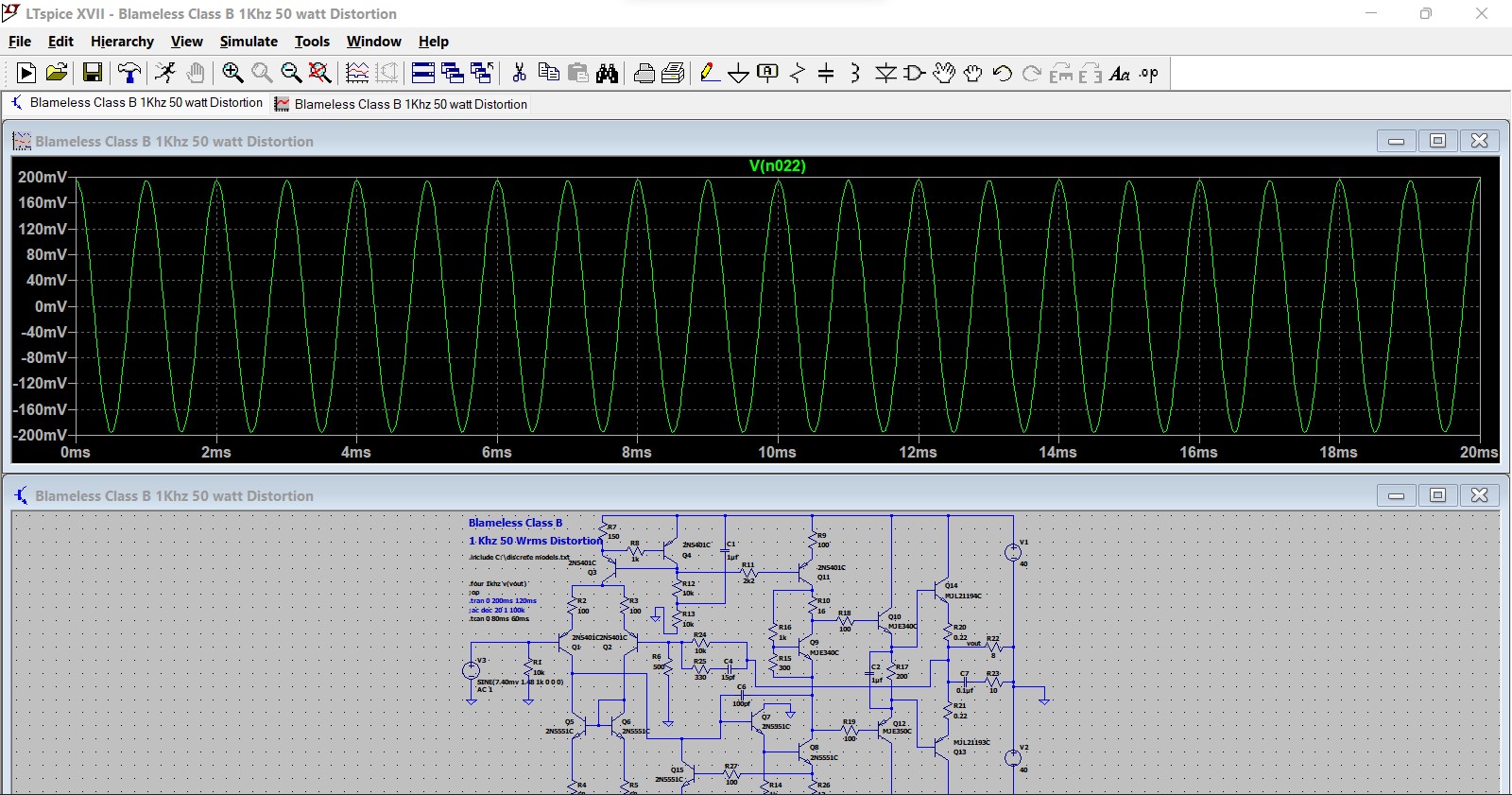

Here is an amp delivering -/+30 volts into 8 ohm.
These show the voltage across the 10 ohm Zobel resistor at 1kHz, 10kHz and 100kHz. At 100kHz you would need a 12 watt resistor and yet for an amp just playing music (even loud music) a 1 watt part would be OK.

Look carefully at the three images. You are looking at the amplitude scale on the left. As frequency rises so to does the AC voltage across the ten ohm. Also look at the time scale at the bottom. The frequency goes up in each one. The 1Khz label is just what the sim was until I altered it to demonstrate this 🙂

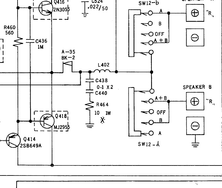

like here you mean?

Yes, but if you stick a scope across the resistor always check first that the resistor is grounded (and connect the scope ground to that point). You'll get into the habit of always checking that 'ground is ground' before connecting the leads.

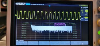

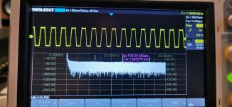

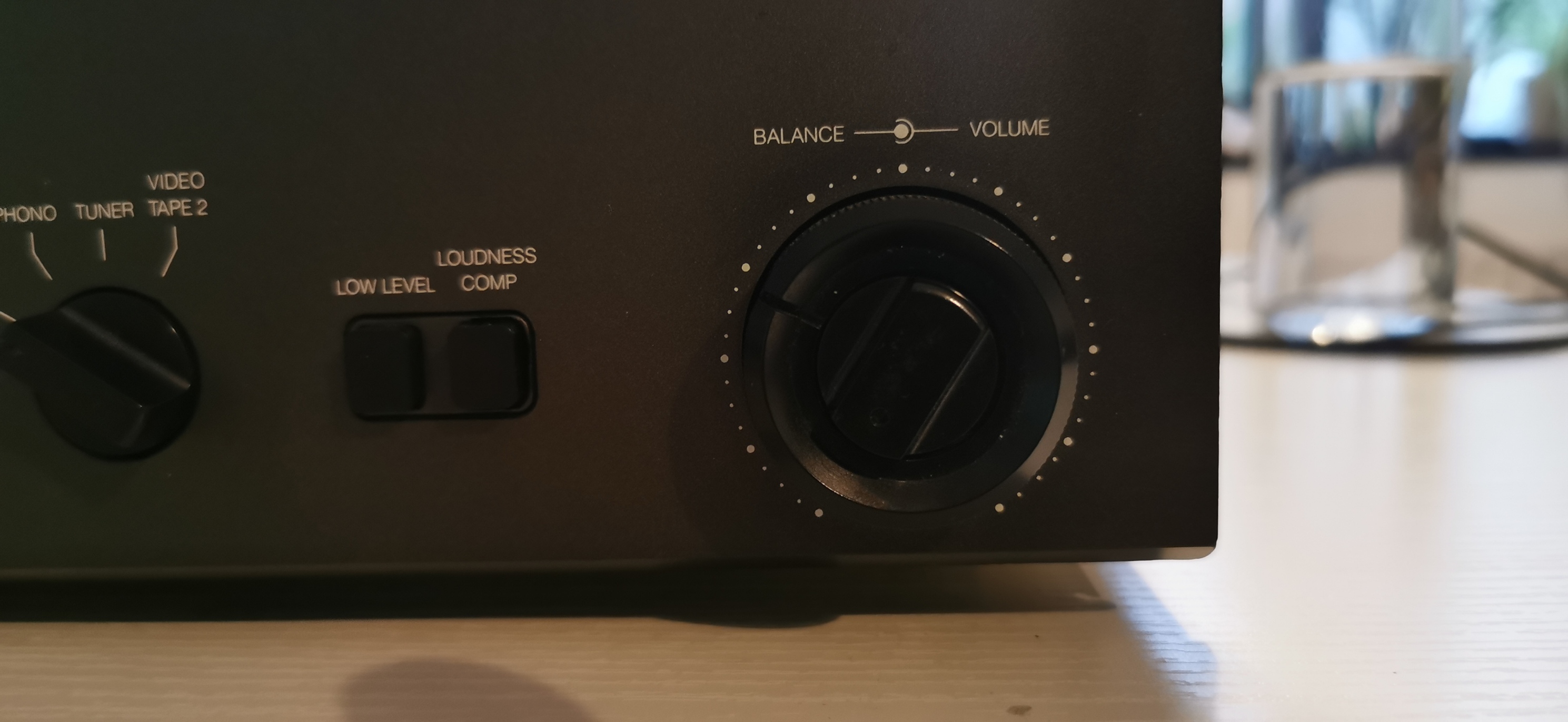

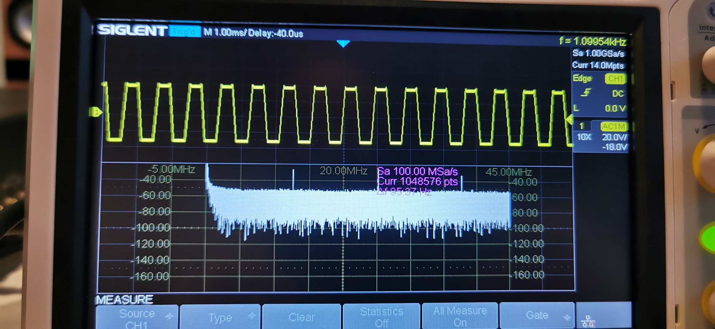

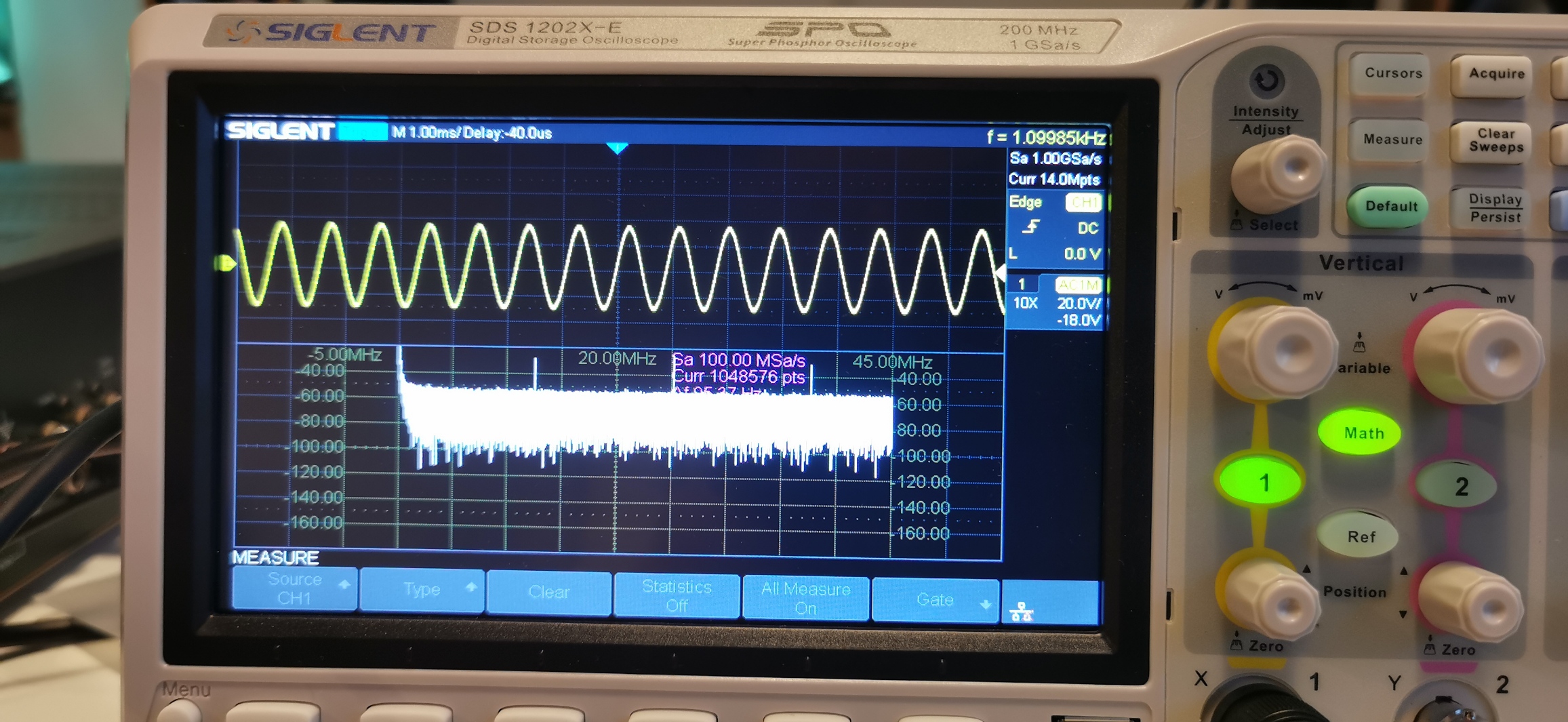

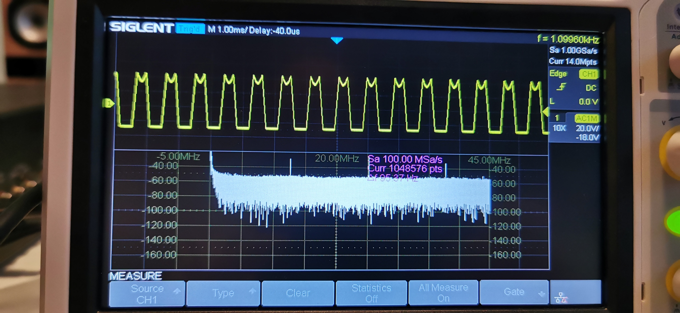

so connected as suggested,1k resistor across terminals and 1k set on generator
pics
1 volume setting
2-amp just before clipping(i presume)
3-clipping? soft clip off
4-with soft clip switch on
but the resistor started to burn
this is my old original NAD 3130 ive had since the 80's(not used since i started learning electronics) and ive never checked it and the off set was 900mv when i tested, so this may be why the resistor is burning?

The soft clip works well 🙂
You can try this next. Turn the signal level on the generator right down and then set the volume on the NAD to about half way.
Now increase the level of the generator to give say 6 volts peak to peak (so six squares of amplitude from top to bottom of the sine).
If you now increase the frequency of the generator up past 20kHz and beyond (you will need to change the range switch on the generator) you will reach a frequency where the output falls away. Stop when the 6 squares of amplitude have become 4.2 squares.
That frequency is the point where the voltage output of the amp has fallen to -3db.

Go back to six squares (6 volts peak to peak) at 1kHz but now switch the generator to squarewaves. How do they look on the NAD?
Never test at high power with squarewaves as they are tough on an amp and the load.
Try the squarewave at 10kHz and 20kHz. Have a look at posts #157 to #161 here:
