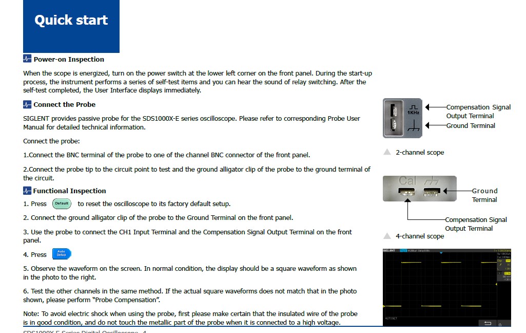

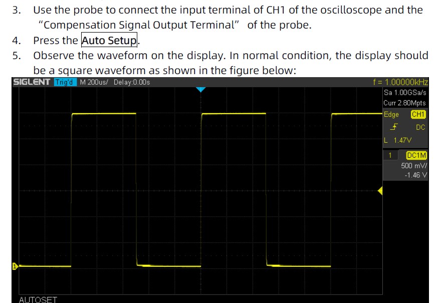

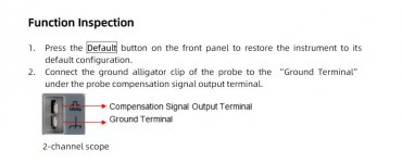

The first thing is to make sure you can get the 'cal' signal to display correctly. Have you tried that? Just connect Channel 1 to the Cal output on the front.
Can you get this far?
And from the main manual:

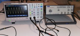

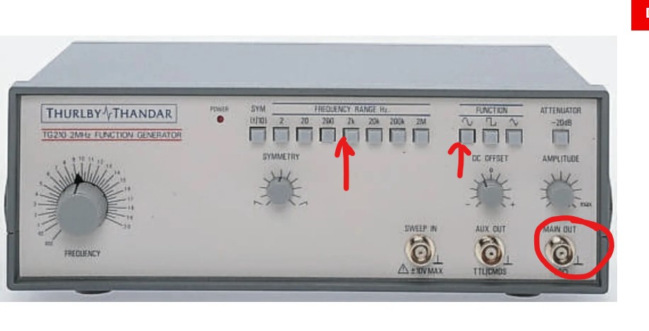

OK, so what I would do now is repeat that exercise and this time, once you have the Cal waveform showing correctly you just disconnect the probe from the Cal signal and transfer it across to the signal generator. Probe ground to any BNC connector ground (the outer part of the socket) and the probe tip to the inner part of the socket.
Press the 2K button and the Sine button. Set the Freq dial halfway round to '10' and have Symmetry in the middle. DC offset in the middle at '0'. Attenuator button not pressed in.
Turn the amplitude control up and down and see if the scope shows a signal.

I would keep the scope settings as they are for displaying the Cal signal. Get that on screen first.
Use the output that says 'Main Output'. The other one is a TTL/CMOS output (logic level output) and the other socket is to allow you to set or sweep the frequency from an external voltage you apply. You wont use either of those two at the moment.

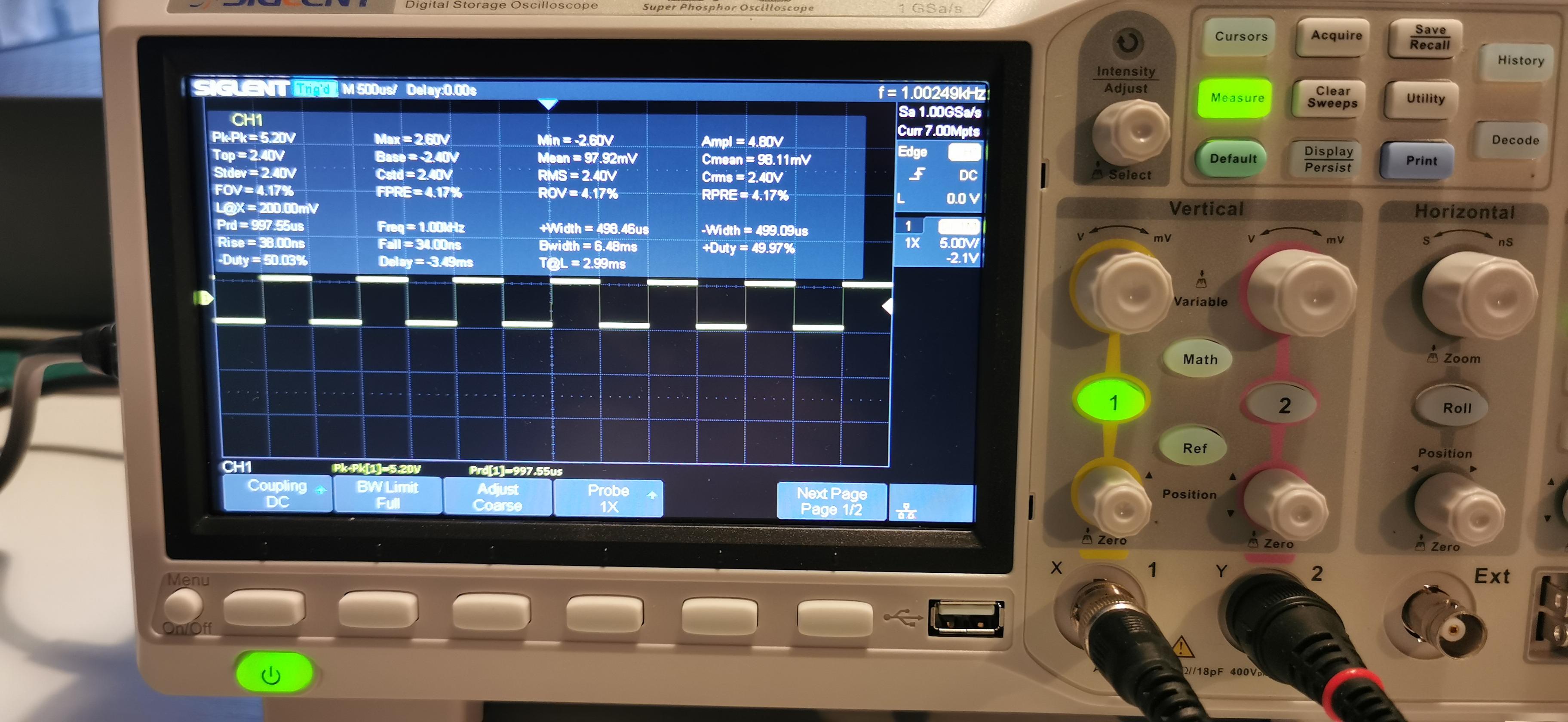

so this is what i have, is this correct?

:up: that looks good.
I would advise you get familiar with the basics now. You should be able to set the vertical controls manually to your chosen level of 'volts per div' rather than using the Auto feature.
The same applies to the horizontal settings which are time per division.
Have a play with those and try and calculate manually what you see. For example one cycle of the 1kHz sine you have in the picture takes up two squares horizontally. Look at any point on the sine and move along until that same point occurs. Count the squares.
So you have two squares horizontally per cycle. I know that for 1kHz that means each division is 0.5 milliseconds in time. That is the time it takes the 'spot' to travel from left to right to cover one cycle. Two times by 0.5 millisecond per division is 1 millisecond in total. That is per cycle.
We find the reciprocal (use a calculator using the 1/X function) which is just the time (1 millisecond) divided into 1. That will tell us the frequency.

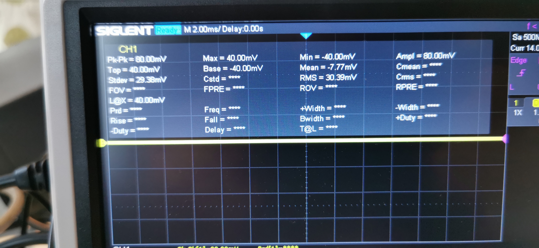

im a bit confused here by what i see on the scope.
If the peak to peak volts is 80mv wouldnt this be about 56mv rms? but on the screen it shows 31mv? my multimeter shows 35mv :(

80 millivolts peak to peak is 40 millivolts peak. Divide that by 1.414 to get the rms value which is 0.040/1.414 = 28 millivolts rms.
That is a very low value for most DVM's to resolve. You might get more accuracy at much higher voltage levels, say 10 volts peak to peak or more.
Try the attenuator on the generator. 20db attenuation should reduce the voltage by a factor of 10. So 10 volts peak to peak becomes 1 volt peak to peak when you attenuate it by 20 db.
