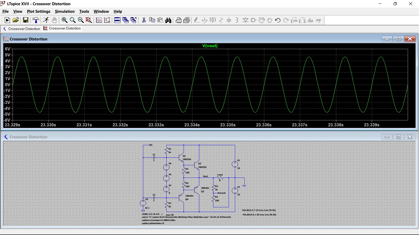

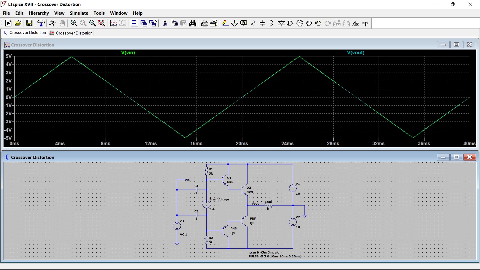

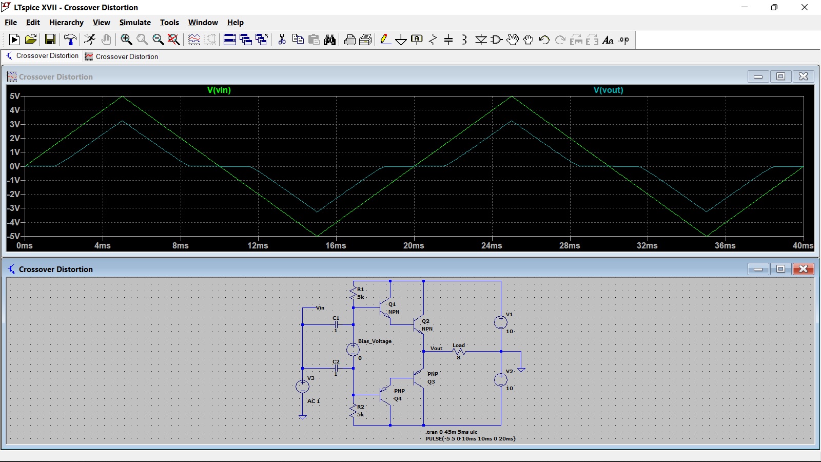

Here we go...
This shows a triangular wave. Look at the input voltage vs time (just like your scope will show). With no bias voltage the transistors can not conduct until the input voltage has risen (or fallen) enough to turn on either the upper or lower pair of transistors.
When we add a bias voltage we bring the transistors up to the point of conduction so that there is no 'dead zone'.

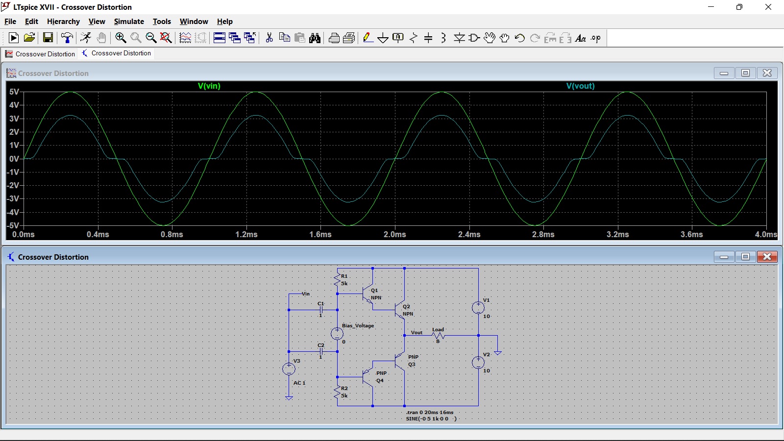

The last image is on a sine wave with no bias. Have a play with adjusting the the bias voltage in the sim.
You will see it is critical and that a tiny increase above the point where the transistors begin to conduct will cause a massive current to flow.
You will also find that a very small bias current effectively stops the distortion.

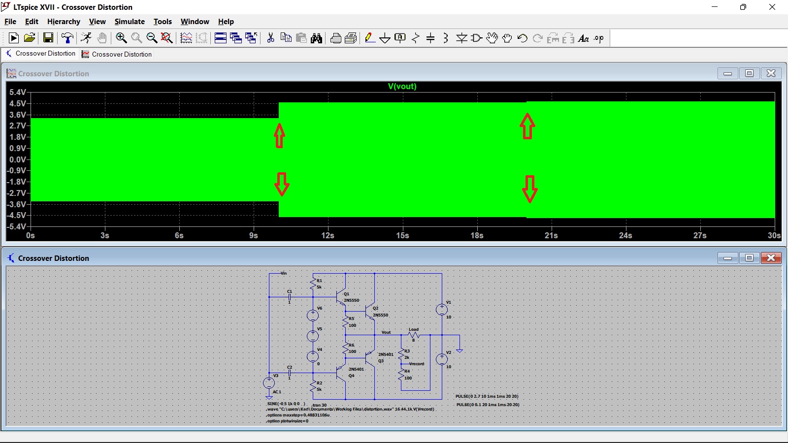

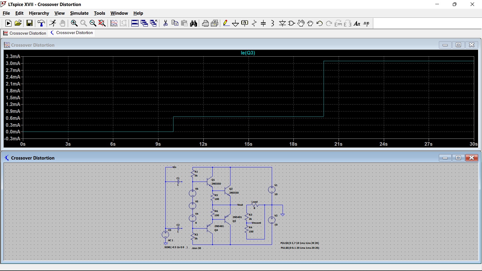

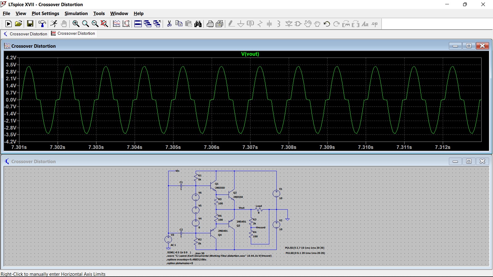

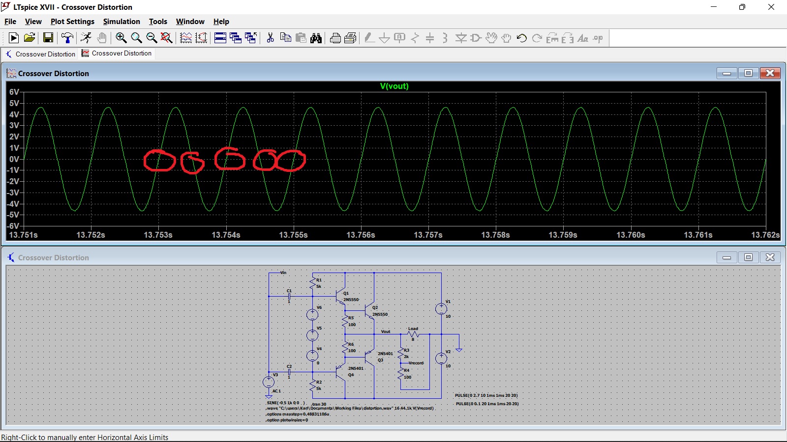

You might like this 🙂
The simulation has been set to run for 30 seconds and the bias current is set at zero for the first ten seconds, then it increases to 0.6milliamps from ten seconds to twenty second and finally increases again from twenty to thirty seconds.
You can see that bias change in the first image. The sim is showing the emitter current of one of the output transistors.
We now do a neat trick... we can record the sine wave into an audio file 🙂 and that is posted here in the zipped folder. It is just an MP3 file that plays for 30 seconds and you can hear the change in the 'tone' as the crossover distortion becomes less and less.
So you can have a listen 😉
The second image shows the audio output and the bias changeover points.
The third, fourth and fifth images show what the audio looks like (as on a scope) at each bias value.

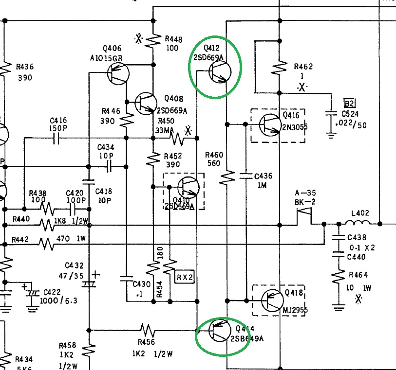

so in this amp, is this the multiplier?
Q410 is the multiplier. The voltage between C and E will determine when and how hard the driver and output transistors conduct.
You could think of Q410 as being just a variable resistor between the driver transistor bases but the main reason we use a transistor to do the job is because it allows us to thermally compensate the output stage so that the current remains constant with temperature change. Those you have circled are the drivers.
