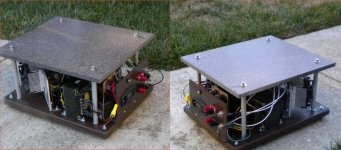

I've just fitted the pieces of the "SiC" puppy to a piece of pine board - with 3 transformers, this is one amp that won't be walking across the table when the bass gets heavy. It'll sport a Corian top plate (faux brown granite) to keep inquisitive fingers out of the high voltage. Tomorrow night I'll finish the power supply, and sand and paint the base board satin brown to complement the top. Having leaned my lesson with "Le Mutant", I've positioned the amp modules so that the hot air exhaust gets ejected immediately out into the open and doesn't linger around. This one also looks like it'll make it to BA. I have somewhat higher hopes for the sound of the Puppy as compared to the other two Passish amps I'm bringing, but comparison with a good source and speakers will tell...
So sad, I just finished getting the SiC Puppy up and running on its pine board. The sound is crisp and incisive (my favorite of the 3 Passish amps I've built thus far), but overlain with a patina of hum. Whether this is spray from the power transformer, power supply hum (should not be an issue with capacitance multipliers, but I need to check), or some snarky oscillation that just raised its head is unknown. Running the amp on an electrophoresis supply appears to kill the hum, so it's probably something to do with the supply. Anyway, as I really don't feel like hauling the electrophoresis supply to BA along with all the rest of the crap I'm bringing, this boy stays home until he's well. Too bad, as he may be my favorite child of the projects I've been working on lately. Le Mutant and Half Nelson are working, so they'll make the trip.

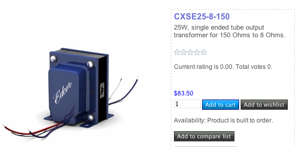

I've been looking at Edcor transformers - they do 150, 300 and 600 ohm primaries. The Lundahl LL1627 could be used as well - that's a lot more expensive. Actually the Edcors are substantially larger than the UBT1 and Lundahl, which both weigh around 2.5 kilos. The Edcors are more like 4.5 kilos and rated for 400ma. I imagine there's a delay to get them of over a month, but still interesting and cheap too.

I think the 150 ohm would work. Of course you get all the usual limitations of
transformers on the bottom and top end.

Attached is a picture of the beast in question - not too big, but with 3 transformers, almost as ponderous as the Dutchy whale. I'll be looking for that hum tomorrow (tonight I'm relaxing by drilling and threading a bunch of holes on the Mutant's new heat sink). I have a capacitance multiplier on each amp module, but if those aren't working right, ripple would sneak through. Hanging a scope probe on the B+ will give me an answer for that in an instant. The transformer I'm using is split bobbin and kinda undersized for its 160VA rating - it may spray flux like a tom cat.

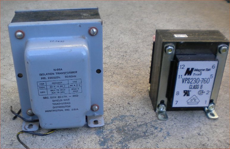

Attached is a picture of the two options I have for power transformers for the Puppy. The one I'm using currently is on the right. It's supposedly rated for 160VA, but feels kinda undersized. It also has a split bobbin, which is nice for primary-secondary isolation, but also increases the leakage/stray-spray flux. The transformer on the left is ~250VA, but weighs around twice as much - I trust it a little more, but it weighs a ton. It has a shield, and the end bells should help to contain stray flux. Grounding the core would also help. I had a bid in for an Antek 400VA toroidal isolation XFMR (no longer available from Antek), but I was inattentive and the end of the auction slipped by me.... I may gin up an SMPS for this guy if I get sufficiently frustrated with conventional iron.
I had a look at the B+ supply, and the capacitance multiplier doesn't appear to be doing much to calm down the line frequency ripple. Should be straightforward to fix - maybe I'll have a hum-free puppy by the end of the week.

Just to be sure (a belt and braces approach), I modelled the capacitance multiplier I'm using in the SiC Puppy circuit, and it behaves as I expected it would, drastically slowing down the B+ rise time at turn-on (no thump), and killing the line frequency ripple. This points to zorched components or a real bonehead implementation mistake somewhere. Once I get to the bottom of the matter, i should be able to enjoy some music from this amp without mains hum in the foreground.
SiC Puppy is now working on the bench using an enclosed Ampex transformer rated for 170V output - no hmmmmm, so the split bobbin isolation transformer I was using before was probably polluting its precious bodily fluids with a lot of spray flux. This one will probably make to BA once I get things tidied up and tied down.
