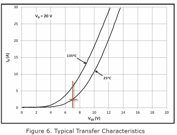

I've been curious about the Cree mosfets, but not enough so that I'd want to pony up the asking price just yet. One might make a nice phony SIT with a jfet follower to buffer the input capacitance. Then again, it might sound like a $30 IRFP240...
The cree's I see are 20v vgs for turn on if I read the data sheet right. Not sure if it's the same animal to either IRF240 or Semisouth's R085, R100's.
I think Wrench threadjacked himself.
Teabag - nah, you're right,it's a different animal. To be honest, I didn't look to hard at the turn-on voltage, as the price soured any real interest. Last time I looked they were more expensive - at $16 I may pop for a couple - after all, I pay on the same order for the big Ixys depletion mode parts. I wonder if Cree is wrapping money around each part to get the interest/volume up, or whether they actually have a handle on the yield to justify the cost reduction? Fake SiCSIT, anyone?

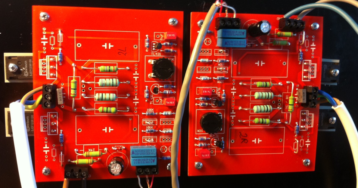

Well, check out this attached schematic, its a P-P amplifier using high voltage devices, in this case SiC JFETs from Semisouth, and it sounds very nice.... Actually, it sounds clearly better than the MOSFET version of the same thing. My impressions were very similar to what Nelson Pass has said elsewhere - it brings forward every acoustical event and makes it clear to hear, almost "visible", "lifelike". Fascinating....
(Just to be clear, I wrote an article about thsi for Linear Audio, and so I cannot really publish a lot of detail here.... it will be public soon....)
