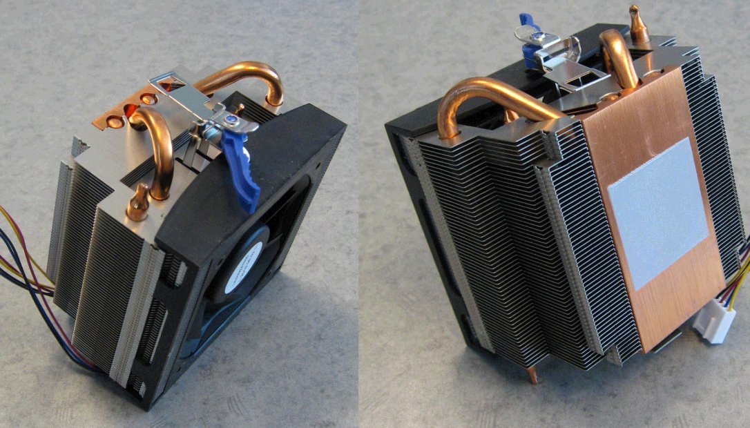

I may take the SiC Puppy boards off the big heat sinks, pop them on to a 1/4" thick heat spreader, and use some attached microprocessor coolers to get rid of the heat - a smaller package, easier to handle.
On that front, I just scored home heat pipe-type coolers on the big Pay that may be up to the task of cooling both channels. The fan noise remains to be ascertained, but maybe I can afford to starve the fan voltage to reduce the noise level. The whole assembly will be inside a case, which should also help.

My heat pipe CPU coolers arrived. They are supposedly good for 125W or so. Mounting them to the heat spreader plate to interface with the amps will be a bit of challenge, as I probably won't be able to drill into the copper heat coupling plate on the cooler for mounting screws without hitting the heat pipes. Creative use of the included CPU mounting clips may be the way to go. Who says you can't do a compact Class A amp?
When I'm finished with it, it'll be quiet. The fans will be inside the case, which will help quite a bit.

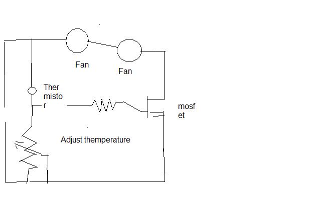

Coolers are good for that 125W and more had one on old FX55 now retired and it was on cooling duty for my mosfets till yours truly inverted + - vires
If you got spare mosfet spare 4.7 K thermistor and spare pot themperature controller is easy peasy sorry for chiken scratch.
Thermistor on heat sink resistance drop as heat goes up which make mosfet conduct more fan goes faster
Set pot for fans to tick over just when heat is getting up.
Fans at 75 % of rated voltagge are dead quiet.
You would have to clamp cooler to same plate easy once you rip off the clamping braket and use goop of your choice

For my current project I'm gonna use additional cpu coolers too (CoolerMaster TX2). They're cheap when you buy them used, because the first generation is a faulty design concerning the plastic mounting clips for the motherboard. I'm planning to use the chunks without fans. A no-noise solution with an inside duct (is this the right word for it?) providing a chimney-effect is my favorite.
I just powered up one of the coolers on the bench a short while ago - the fan draw at 12V is relatively modest (120 ma), and the noise level is surprisingly low. I have some other coolers of more modest capacity that are real whiners at full tilt (like some list members). Next problem is how to interface the CPU clips to my heat spreaders - noise will be a non-issue.
