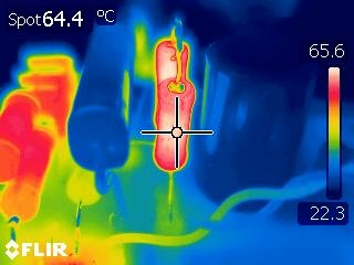

Everyone wants things to be smaller and cheaper. With resistors, this can be counterproductive. I have on hand 3W resistors that are not much bigger than a 1/2 W part, and really should be rated at 3/4-1W. The smaller resistors just get hotter for the same dissipation. This may not hurt the resistor much, but it can be pure hell for adjacent components and the PCB. What started this rant were "2W" resistors derated by 50% that were still cooking at 130-150C (a thermal imager shows up a lot of sins). To make a long story short, several resistors are now physically much larger, and spaced away from critical components (mostly capacitors). I may post some thermal camera images to illustrate my point. The problem children are R3,4,10 and 11. I'm waiting for Mouser to deliver some aluminum oxide TO-247 insulators, which will help the thermal interface between the heat sink and the Semisouth FET, as will as improving HV isolation.
This is a common enlightenment 😕 I learned a long time ago 1W on a 2.5W resistor is not going to cut it! I now use a minimum rating of 5X and I'm ussually happier with 10X the quiescent power for a "hot" Resistor. I do use alot of 5W, 10W, 12W, 25W and 50W Rs. The thermal distortion or at least the Tc is much lower typically also. 😀
Given the cheating in power rating that goes on these days, this would be one application where steel leads make sense, limiting the amount of heat conducted to the PCB and solder joint from the hot resistor. I've never understood why some inrush protector manufacturers use copper leads....Others will no doubt quibble on sonic grounds - everything involves compromise. Spacing the resistor off the PCB helps. I used ceramic beads made for that purpose at my last job - can't find a source for them now. Some resistor manufacturers squish the leads or put a jog in them to get the spacing.
Well, I changed the resistors, and they are not running any higher than 65C now, which is quite a change compared to the 100C+ temperatures on the first revision of this design. Bias current drifts up about 10ma (from 150 ma to 160 ma) as the amp warms up, probably due to change in leakage current. The gate is at ~1.5V with a 10k gate resistor, meaning there is ~150uA of gate leakage. I may incorporate a source follower in the next pass of this design to eat the leakage current. A really ammbitious follower is not needed - I may be able to get by with a pair of 35 cent jfets, at the cost of adding some low voltage rails.

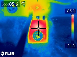

The 085 die temperature is at ~90C after sitting a while. An aluminum oxide washer helps the thermal resistance of the Semisouth part - the heat sink actually starts to get warm now... At any rate, with 302V of drain voltage and 160ma bias current, the power dissipated in the 085 is 48.3W. The die temperature ris is ~65C (25C to 90C), so the total thermal resistance of the interface is 65/48.3 = 1.35 degrees C/Watt.
This is probably good enough for the time being to try driving the amp into a load of some sort - more later.
Some psychedelic thermal photographs - the first is the 085 temperature after running a while at 300V B+. The heat sink is starting to get toasty, as the aluminum oxide thermal pad is doing its job well.

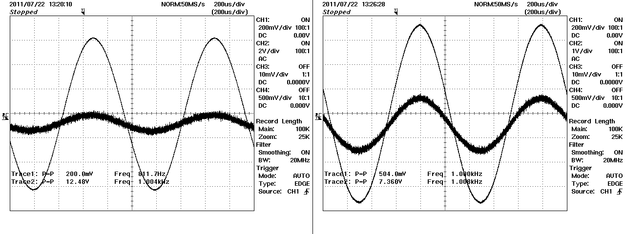

I have one channel working more or less satisfactorily, though somewhat shy of the desired value for output stage bias current (120ma vs 150). I went ahead and loaded the 8 ohm tap of the output transformer with a 10 ohm resistor, and did open loop and closed loop excitation with sine and square waves. The first picture shows result from sine excitation. The left-hand set of waveforms is with partial feedback (R7 is connected, C2/R6 are not). The gain under these conditions is ~62X (36 dB). With the loop closed around the transformer 8 ohm secondary (using R6, with partial feedback resistor R7 still in place - C2 is not stuffed), the gain is 14.6 (23.3 dB).

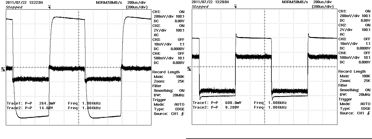

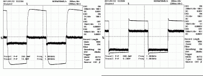

This next set of pictures shows open loop/closed loop square wave excitation. Closing the loop around the transformer tightens up the square wave response. There is output overshoot, but it is just the overshoot of the input waveform amplified. The amplifier looks stable without compensation capacitor C2. The other breadboard I have exhibits low gain and a distorted triangle output with 1kHz square wave excitation. I suspect an accidentally zorched output jfet (ouch!) or a defective output transformer. We'll see tomorrow. When I get both channels satisfactorily operating, I'll push some tunes through them. I'll also do a gain-phase plot of the working channel when time permits.

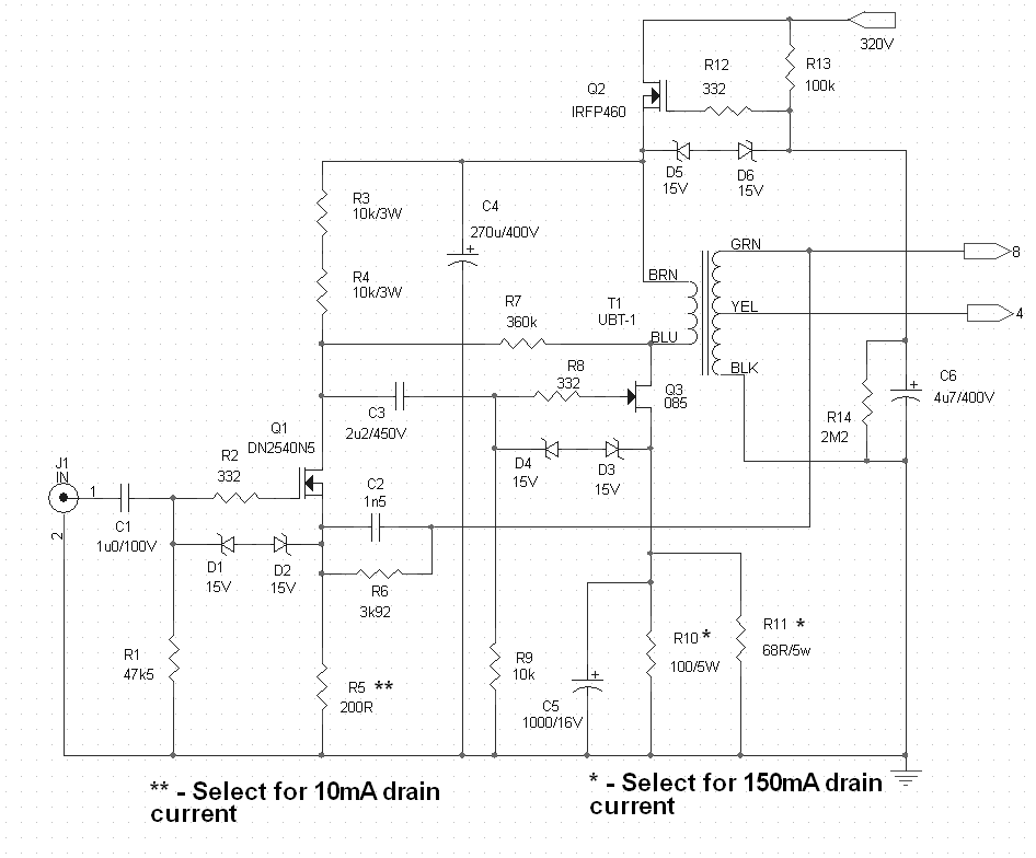

The attached schematic is the one I'm currently using. The values of the parts denoted with asterisks should be changed to get the proper bias current, depending on the parts you have on hand. Leaky 085s (that is, ones with leaky gates) won't work at high drain voltages with a 10k gate resistor, and should be used in low voltage projects - more on that later, as I have far more projects in process than time to work on them.
