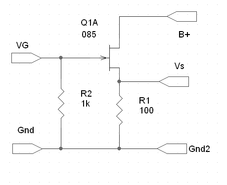

This circuit will be useful to characterize the 085 parts you have. The 100 ohm source resistor should be rated for 5W or better so that it doesn't heat up too much. The 1k Resistor should be right at the gate lead to avoid oscillation.Gate leakage can be determined by measuring the voltage across the 1k resistor. The leakage current will be that voltage divided by 1000. Source current is determined by measuring the voltage across the 100 ohm resistor and dividing the resulting voltage by 100. I use a large CPU cooler with fan to mount the parts in order to have a stable temperature during testing (also so they don't melt/blow up). It's very simple to drill and tap a 6-32 hole in the heat sink to attach the transistor with a screw. Use of a good thermal pad between device and heat sink is a must.

Well, if this part cannot turn off at a fraction of its rated drain voltage at its maximum rated reverse gate voltage, I'm going to be raising hell in several venues. We''ll see tomorrow. I'm going to use the circuit shown to exercise some of the parts at 300V Vds.
I loaded one of the SS 085 jfets from my Teabag group buy into my test jig, and it preliminarily looks like it should, regulating at ~ 6V negative gate bias for 100ma drain current. Later on when I get a chance, I'll adjust the source resistor for 150 ma drain current and see if the part behaves itself at 300V drain voltage. I'm also using a 1k gate resistor, so I will need to see if the part works with 10k.

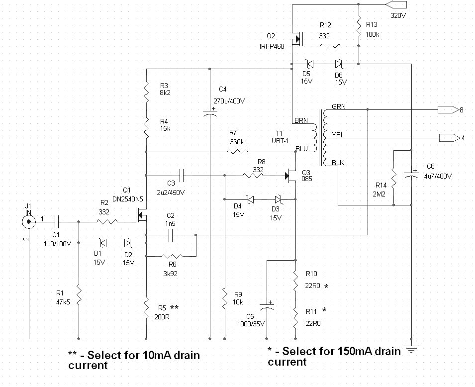

This is the first revision schematic for the SiC Puppy. There is nothing at all innovative about the overall architecture, as it is just a simple partial feedback single-ended amplifier with silicon substituted for the customary pentodes. Those looking for background can search out the threads regarding the RH84 and similar amplifiers in the tube forum - there's been lots of discussion. The values shown in the schematic are preliminary, as I have been wrestling with bias issues in the output stage, so I haven't even applied full voltage to the circuit yet, much less a signal.
Issues to look out for:
1) The Semisouth 085 jfet has a relatively small die, as the data sheet lists a junction-to-case thermal resistance of 1.1 degrees/watt maximum. As the design is currently set up for ~45W dissipation in the output stage (I'm trying to wring all the power I can out of this thing), this means that the die can run at 75C at room temperature, even with a perfect heat sink and case to heat sink interface (zero thermal resistance). You'll need a good heat sink and the best thermal interface material you can find to keep the device temperature under control. You can back off on the bias current (and power dissipation) by increasing the values for R10 and R11, at the cost of less output power. The circuit posted previously can be used to evaluate the parts you have and select proper values for the source resistors. I broke up the source resistor into two pieces to spread out the dissipation and avoid hot spots. I'm using 2W metal oxide resistors.
Friday afternoon, I finally found a good 085 and was able to stabilize bias in a test jig at the desired bias current and ~250VDC B+. The values for R10 and R11 in the schematic are from that session, and will not necessarily be appropriate for the devices you have - you will need to test. They will work as starting values for your evaluation.
I chose the DN2540N5 for the input device (Q1) because I have a bunch of them on hand. Since it is also a depletion mode device, biasing is very simple, and a single B+ supply can be used. I have no idea whether this device will be the best sounding option for this design. That's one of the objectives here, to find out. If you give up on a simple power supply/bias scheme, there are lots of options possible for Q1, including standard enhancement mode mosfets and jfets. Q1 is at present set up for a bias current of 10 ma. This may not be the optimum choice for bias, but it is a start. The DN2540 may be more linear with higher bias current, in which case the values for R3-R5 will need to be reduced. At higher bias currents, Q1 will probably also need a larger heat sink. I'm presently using a small bolt-on TO-220 heat sink, which can be seen in the photo.
The partial feedback resistor (R7) is a placeholder, and may not be the optimum value. I plan to run the amplifier with a mix of partial and global feedback to supply some low frequency correction for the output transformer. I will bring up the amp for its first run with the global feedback disconnected, and adjust R7 for optimum performance. I'm shooting for a gain of 20X with both loops in place. It may be possible to run the amp with just partial feedback, in which case C2 and R6 would be omitted. I suspect the gain of the circuit will be too high without some sort of feedback.
Q2, C8, and R12-14 are a simple capacitance multiplier to filter the input B+ and clean up ripple. This could be omitted if you want to try another method of filtering your B+ supply. An IRFP460 was used, as it was something on hand, it's way bigger than necessary. An IRF 820 or 830 would probably work just as well. I used a TO-247 device in this project, as there are fewer HV creepage issues with that package when using a non-floating heat sink.
Those people looking for a quick project to bang out will probably be disappointed with this circuit. A more expedient approach may be to use your 085 in a "Delite" amplifier, documented extensively elsewhere in this forum. There's no output transformer, and you avoid high voltage issues. You can use the same circuit shown previously to select an appropriate source resistor for the 085 - it will be a lower value, as you will be running a much higher bias current.
At any rate, this is as much as I want to say about this project this afternoon. I'll sub the good tested part in my breadboard tomorrow, and run the B+ up to 300V and let it sit to check bias stability and Q3 temperature. Assuming this works OK, I probably won't apply a signal to the input until Tuesday or thereabouts. I'm multiplexing this project with 5-6 others, a full-time job, and a college radio DJ gig, so don't expect rapid progress.
