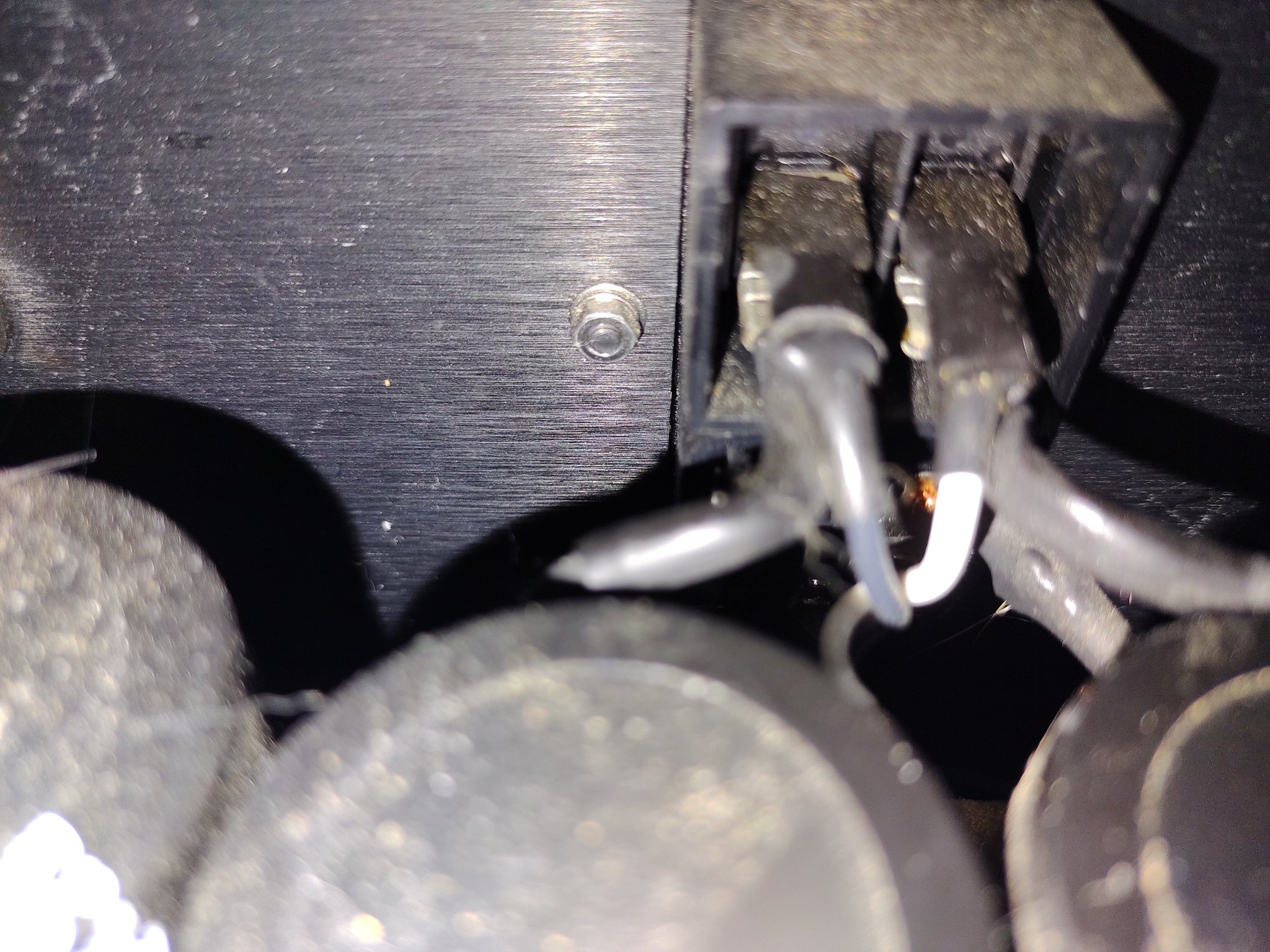

Especially when it's welded shut! One came out with a little persuasion. The other I posted a pic of, has to be REALLY persuaded!
Normally, just a push frees them, then pull them out without damage.

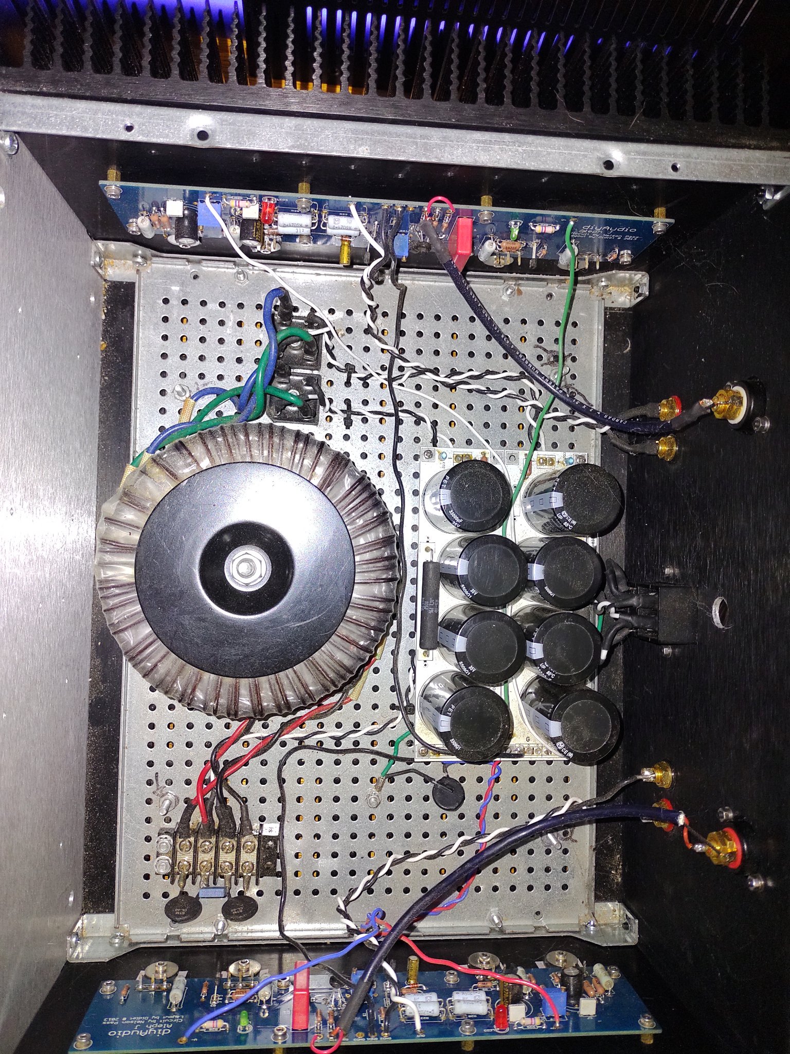

Took top off the AlephJ, looking at the business side with small flashlight, I can't see obvious damage YET, lower part is fairly
Covered up by row of power supply caps.
Wire isn't burnt on top, wires are all shrink wrapped and that dust rubbed off making it appear blacker. Better pics, and of all connectors once removed.

Another possibility that Russellc experiences molten fuse holders can be that the used faston connectors are not branded stuff and do not have the required clamping force for having a low enough ohmic connection with the fuse holders contacts. This would also mean heat and possible damage.

I think, the main reason for the observed damages as to find in the images from #1+2 are the inrush current after switch on.
Over the time the contact resistances will be higher and higher and thus also the thermal stress - especially on the main switch and fuse holder contacts - with the showed consequences anytime.

One other feature of these two affected amps, is that they are both in the older stye Deluxe 4U which is only 300mm deep.
Neither of them seemed excessively hot, may have to rethink that obviously.
