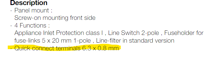

For awareness, the tabs for the 2 fuse on the Schurter 4304.4045 PEM supplied in the diyaudiostore back panel kit provided for years are 2.8mm. The other 5 tabs (4 on the switch, and 1 on the ground) are 5mm.
4304.4045 is the part number for the new model in the kit, 4304.6090 is the version that used to be included. According to the datasheet the tabs on the fuse holder are meant to be soldered, while the ones on the switch are quick-connect.
https://www.schurter.com/en/datasheet/typ_6765.pdf
https://www.schurter.com/en/knowledge/terminals

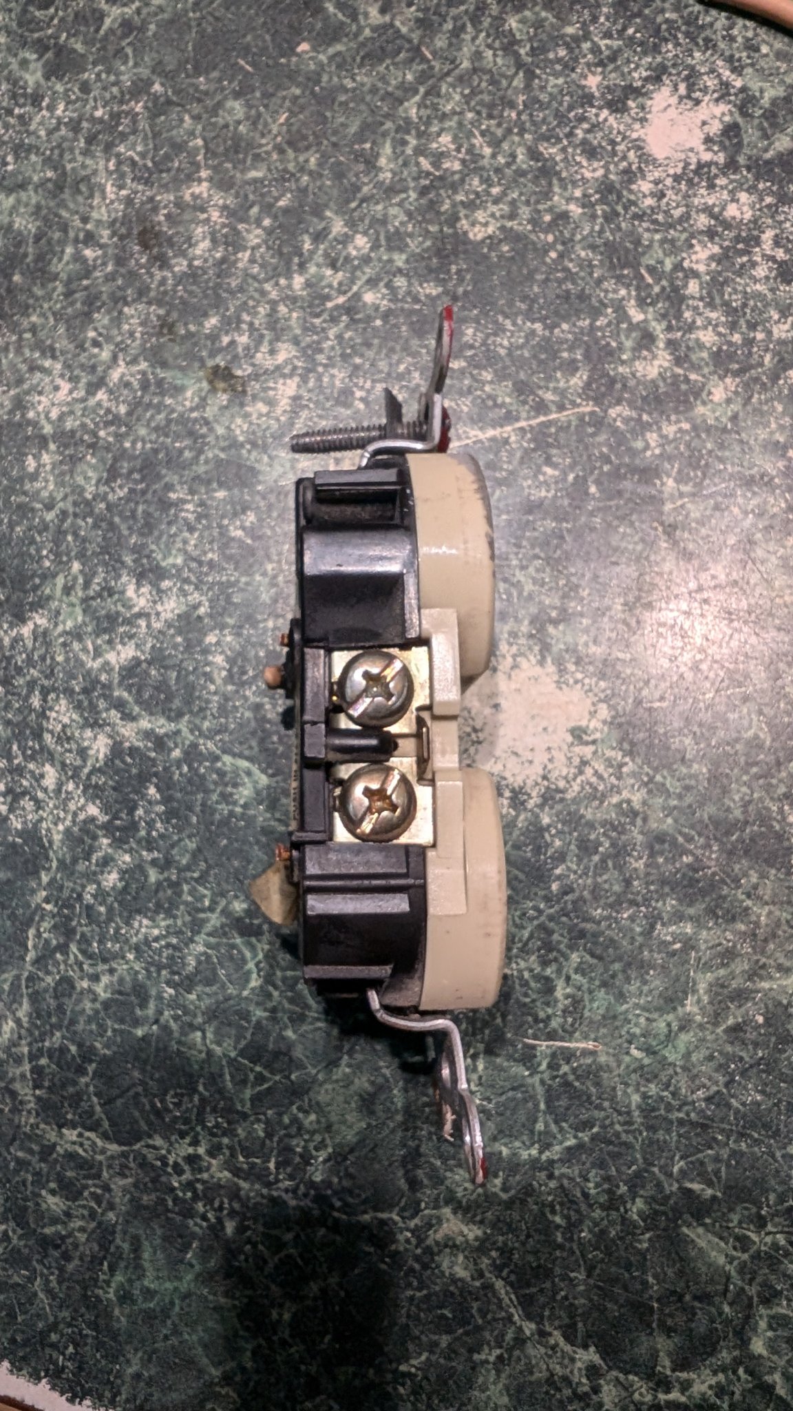

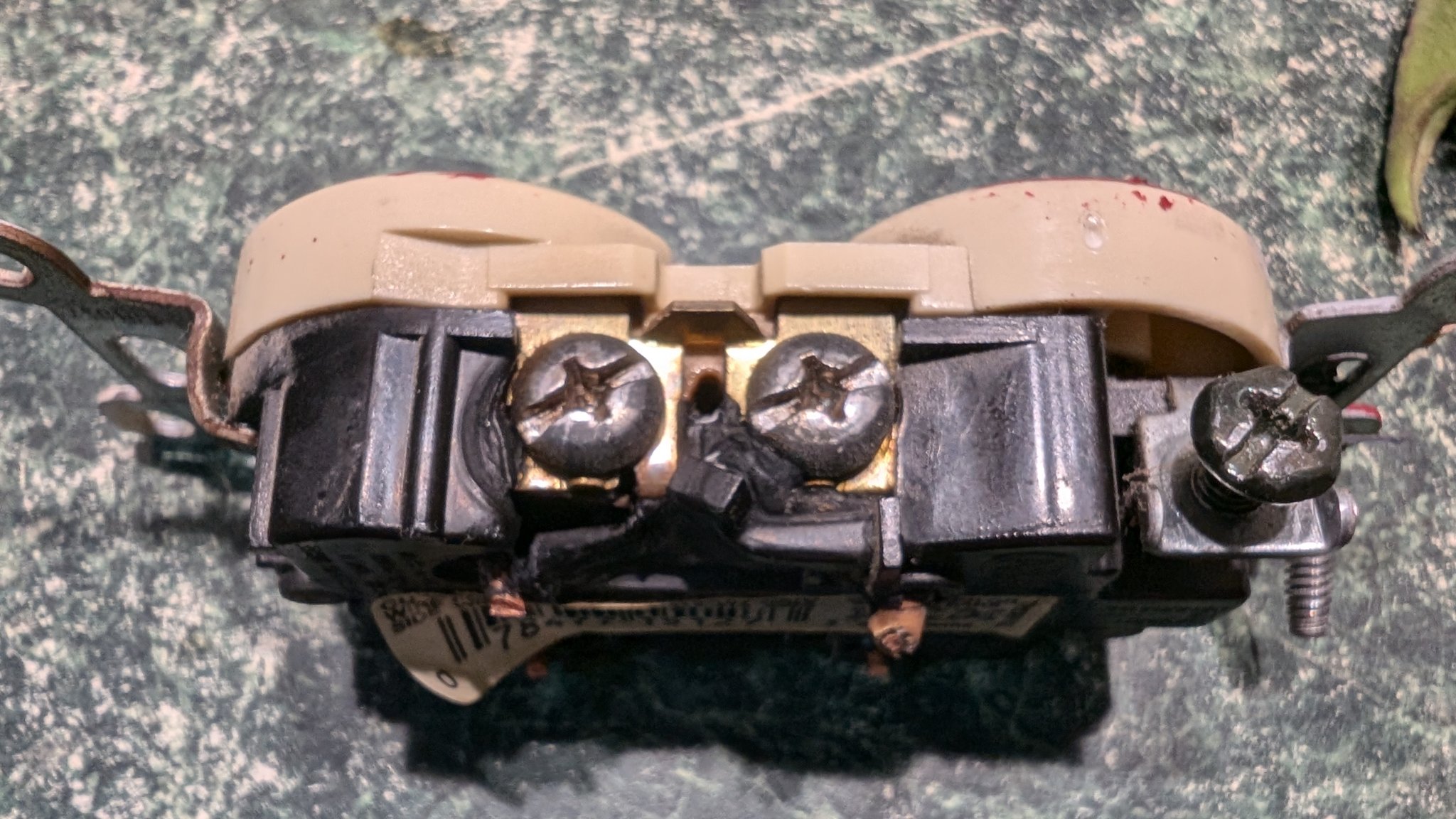

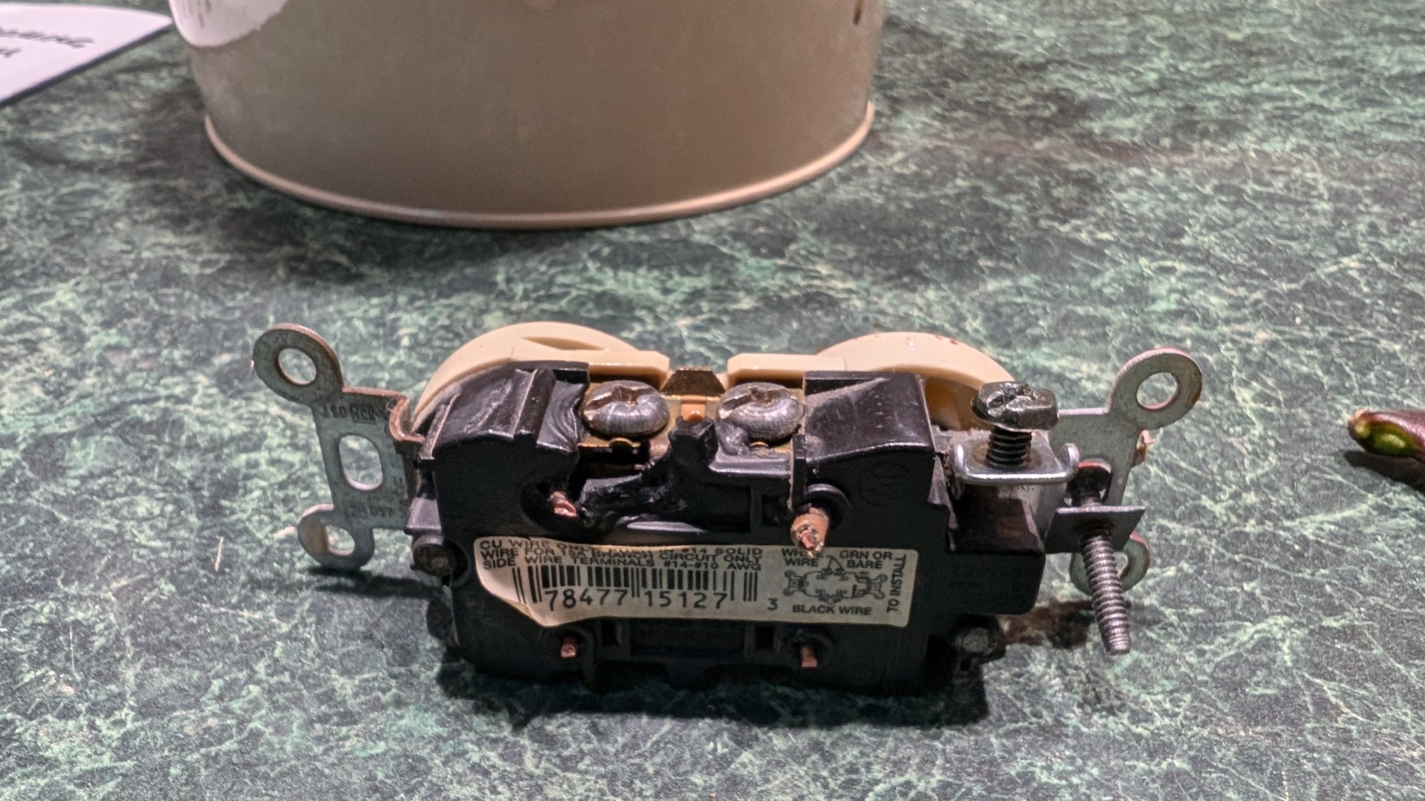

This thread caught my eye because last year the power went out in part of our house and after tracing it back found that the first two outlets on the circuit worked, but the next one didn't along with everything that came after it. After pulling it we saw it had melted and that's where the disconnect happened. This outlet used the push-in connections instead of the screw terminals. As the years went on this connection degraded and it eventually melted. This seems to be a common issue with this style connection.
There could be a number of reasons for the fuse connection being poor, but it looks similar to what happened with my outlet.
