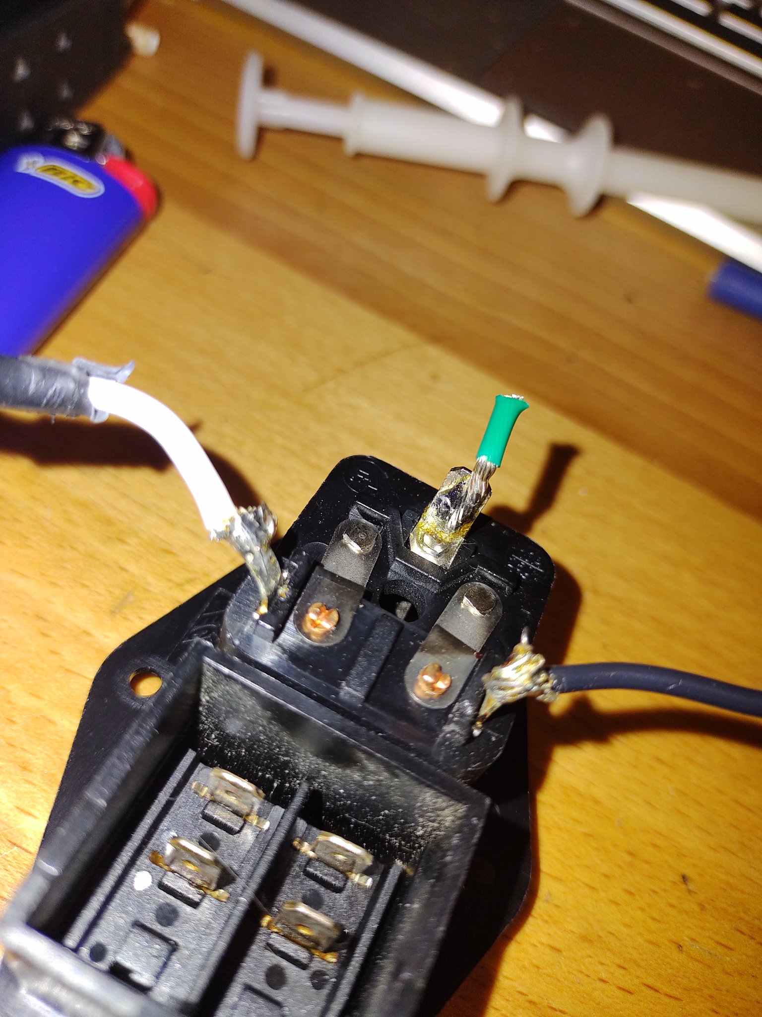

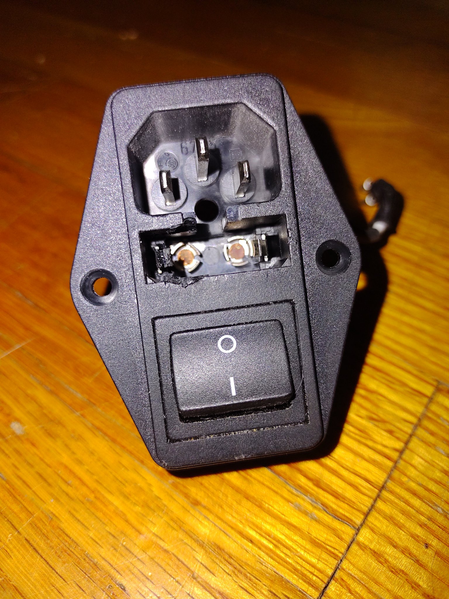

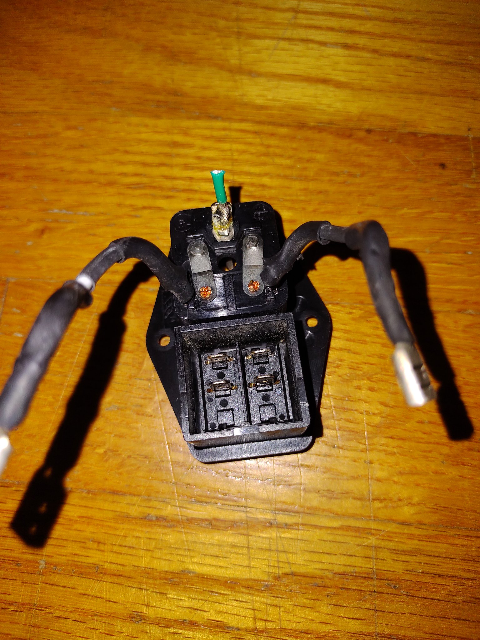

Got it out, new pics.
Both. Ground straight solder. Jumpers soldered on lower posts (still attached in photo), faston with solder above. I don't think enough solder as I was able to pull it off with needle nose. More like just enough to prevent it being lose feeling. So that connection not ideal.
For the age of amp and amount of heat this part exposed to, the connectors weren't as bad as I had expected.
Now to remove power supply board and go over it. Waiting on FedEx, allegedly out for delivery.

At the time I didn't like the idea, hard to get to and possibility of overheating as well. But I didn't like the idea of it just being a friction fit so ....removing it, was obvious not much solder. It pulled off without much pressure.
Then covered with shrink wrap and forgotten. Until now.
Russellc
Is it that hard to say “yes” or “no”? Or even giving a reply to questions? I think it has been asked 4 times.
So you soldered that faston version and not even good enough. This overheated the PEM while soldering it (it is not meant to be soldered) possibly deforming/weakening it. Then the not well enough soldered connection was too high ohmic that generated heat over a longer time. Not a Schurter error or a fuse error, no a plain user error because the user did not like the idea of a friction fit (that is better than a solder joint). Well look where it got you.
Don’t do it. The surface is too large (certainly the 6.3 mm version) therefor needing much heat over too long time and also a too long cooling down period for the melting/deforming/weakening plastic. The solder versions have smaller contacts meant to be soldered. The fact that the soldered wires could be pulled easily from the faston blades gave it away. The failure would not have happened if they would have been crimped.
Also soldering already crimped faston connectors (on wires) simply is bad practice.
If you like reliable stuff just crimp stuff meant to be crimped and solder stuff meant to be soldered. It is simple in fact and designed to be used like that.

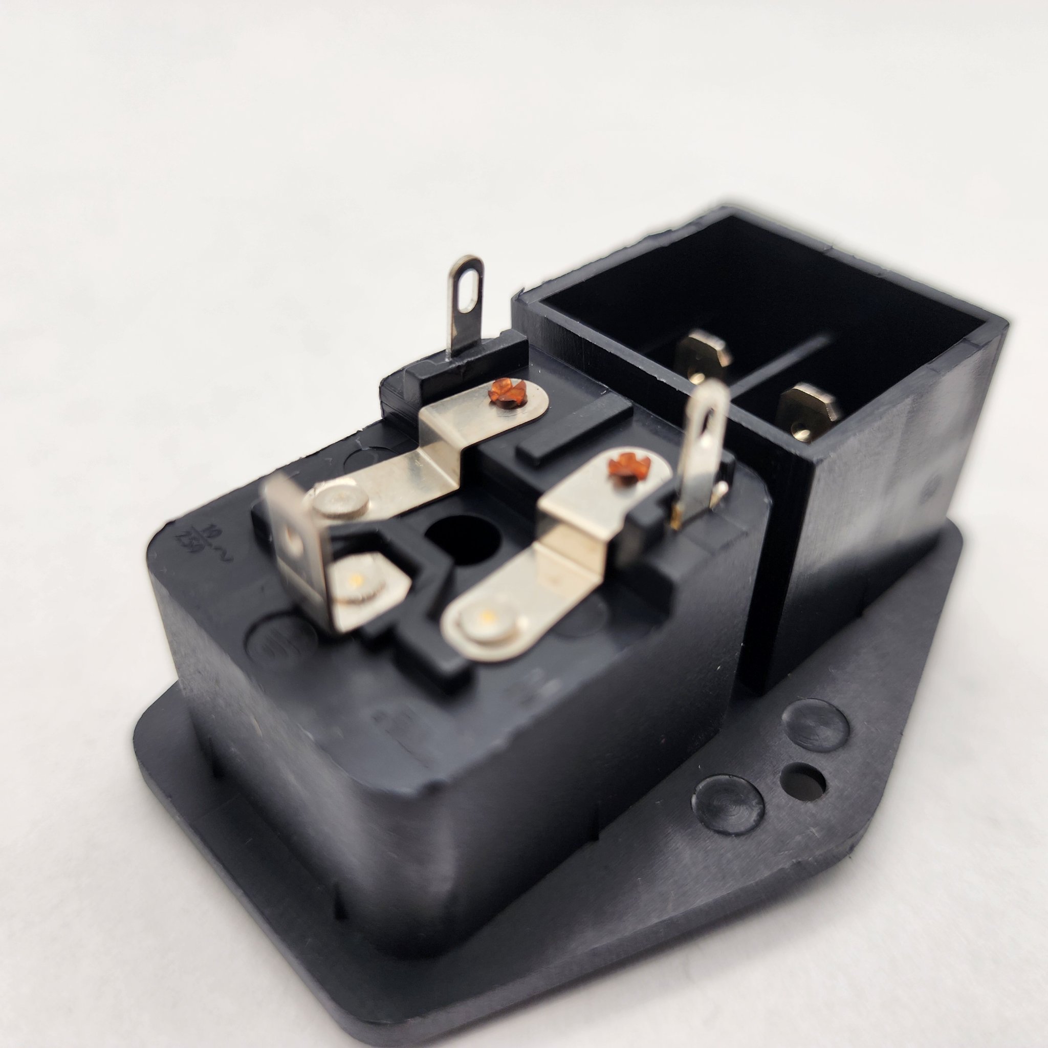

For awareness, the tabs for the 2 fuse on the Schurter 4304.4045 PEM supplied in the diyaudiostore back panel kit provided for years are 2.8mm. The other 5 tabs (4 on the switch, and 1 on the ground) are 5mm.

As far as I understand so far, it seems the issue is due to the 2.8mm spades on the diyaudio store provide Schurter 4304.4045 PEM being different size than the rest of the 5mm spades on the PEM. Because of this, many folks end up soldering on wires to those smaller fuse tabs instead of using 2.8mm female crimped spades per the design. In taking that path of soldering instead of using crimped connectors, there is an inherent risk of melting the plastic holding the fuse tabs in place, which could result in poor contact with the fuse on the internal portion of the fuse box. That poor contact would/could then result in a higher resistance due to poor contact, increasing heat, which over time will fail the PEM in the fuse box. Folks who solder to the 2.8mm spade connectors on the store provided PEM and don't have this overheat issue are likely just getting lucky by not melting the plastic. Using 2.8mm spade crimp on connectors on the fuse tabs are the correct approach to avoid the issue identified, not soldering wires direct.
I believe this is the going theory that's been narrowed down by the experts. I'm probably wrong in my understanding, but the experts can correct the error of my understanding.
As for the diyaudio store back-panel provided PEM, the new version being sold as of this month no longer has this issue of different spade sizes, as the fuse connections are all internal, so only the line/load, neutral, and ground spades are the same size standard faston (all which I presume must be used with same size 6.8mm/0.250" female spade crimp connections --> no soldering=no plastic to melt).

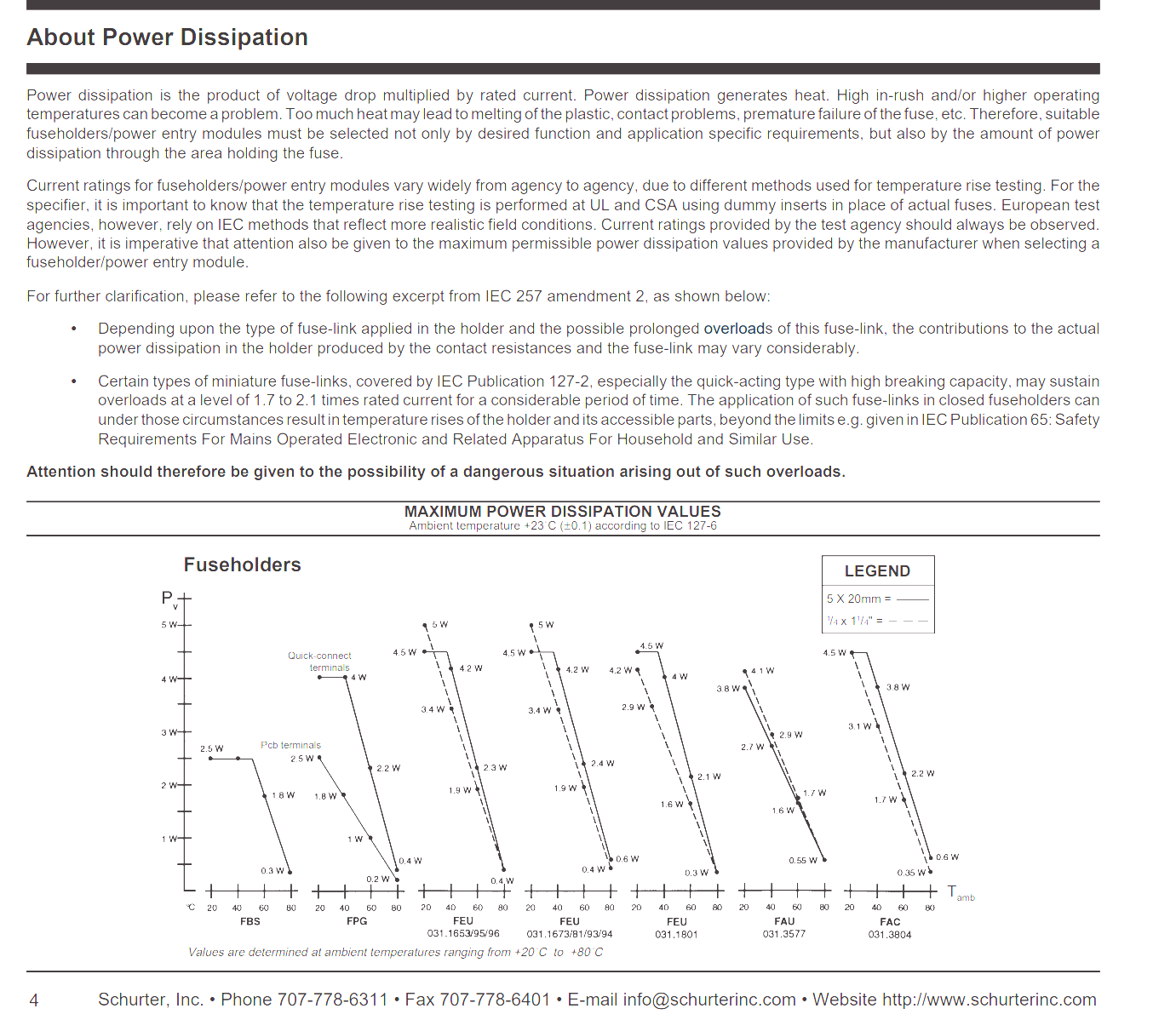

A careful reading of the data sheet for the Schurter DD11 input module will reveal a wattage limitation for the fuse holder. It’s listed under several conditions but uses a graph that a value must be interpolated from. Similarly, a look at the data sheet for Littelfuse type 215 fuse, for example, will show the cold resistance and the dissipation at 1.5 times the rated current. You should calculate the wattage dissipated at the nominal and maximum currents you expect to run at, but also understand the reason the 1.5 times figure is given. For a 2.5A type 215 fuse, the fuse will hold at 3.75A for a minimum of 60 minutes. In the event of a fault, the fuse holder, if one is used, must be able to withstand the dissipation present until the fuse opens. Again, for the 2.5A fuse, this is 2.5 watts. Going back to the data sheet for the DD11, this clearly exceeds the acceptable wattage.
The point is, for a reliable application of an integrated power entry module, you need to do the math. Otherwise its “Good night, and good luck”!

Adding to your thoughts, DIYers may find IEC 60257:1968/AMD2:1989 and/or UL Std 512 of interest.
There are also excellent summaries and application notes for fuse drawer and fuse choices across the internet.
Both Schurter and Littelfuse have excellent (IMO) summaries of key findings along with recommendations.
Below is an excerpt from a Schurter document I had saved. If I find an link to the document itself, I'll edit or repost. At the moment, I think posting a photo of the excerpt is within bounds of copyright. The link to the main Schurter website is included to indicate the source, but the document itself isn't titled, and I am not sure if attaching the entire document would be allowed. I cannot copy any material from UL or IEC paid standards unfortunately (to the best of my understanding).
