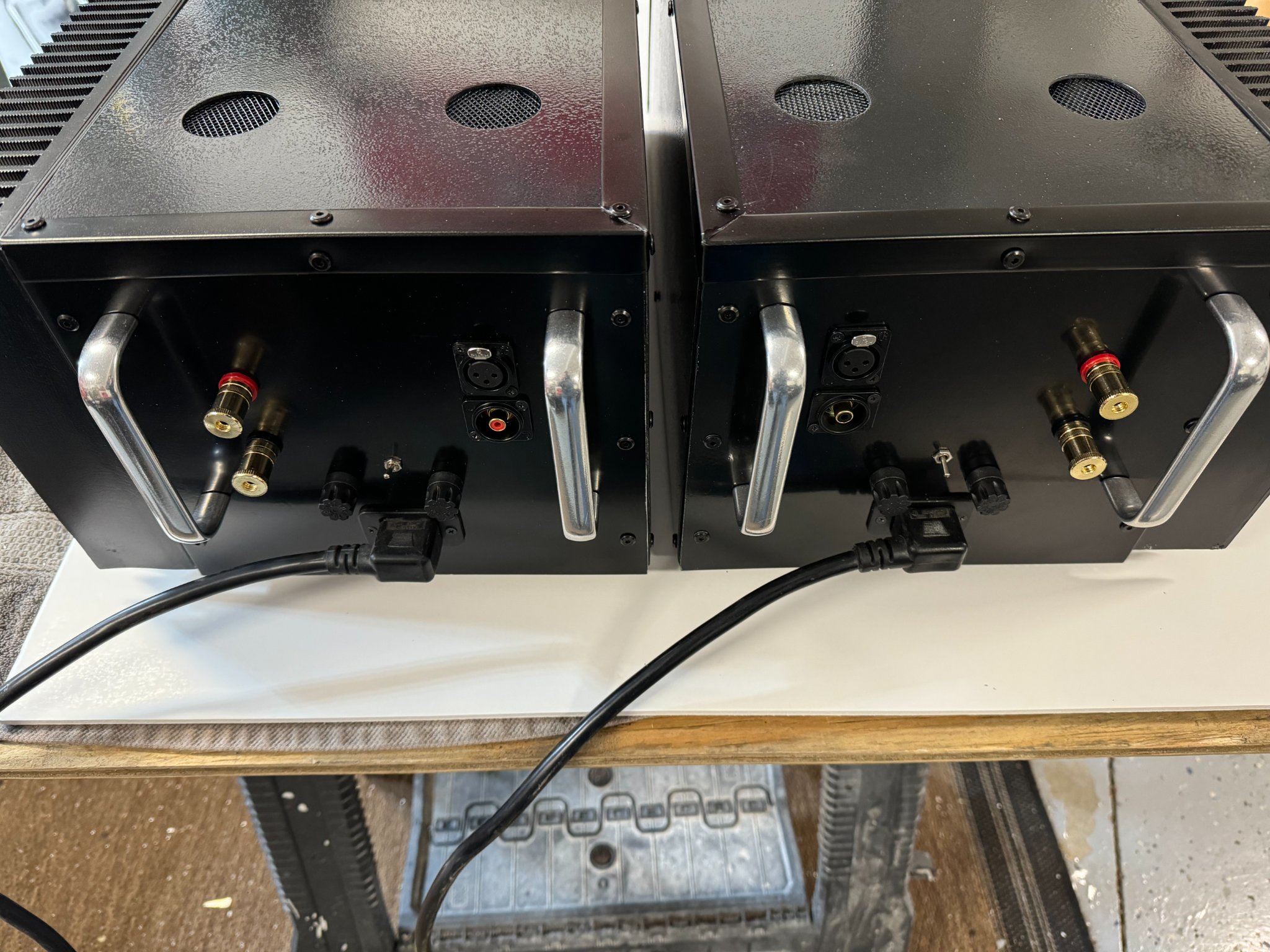

On fabricated cases I use a simple entry socket and separate fuse holders.
One is for donut the other for a small filtered 12V SMPS for soft start etc.
I realize this is no help with a pre-fab chassis with the holes already punched.
