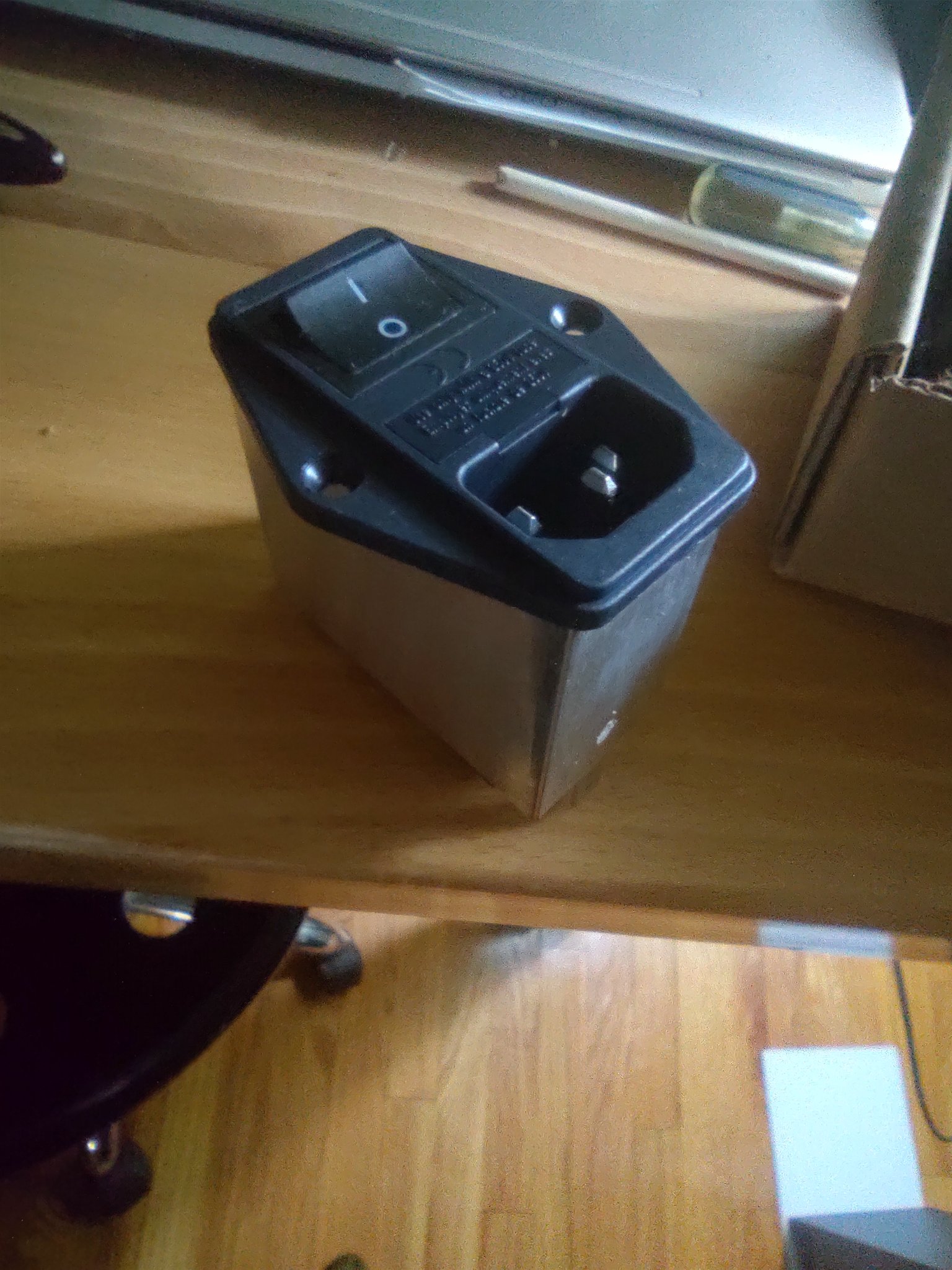

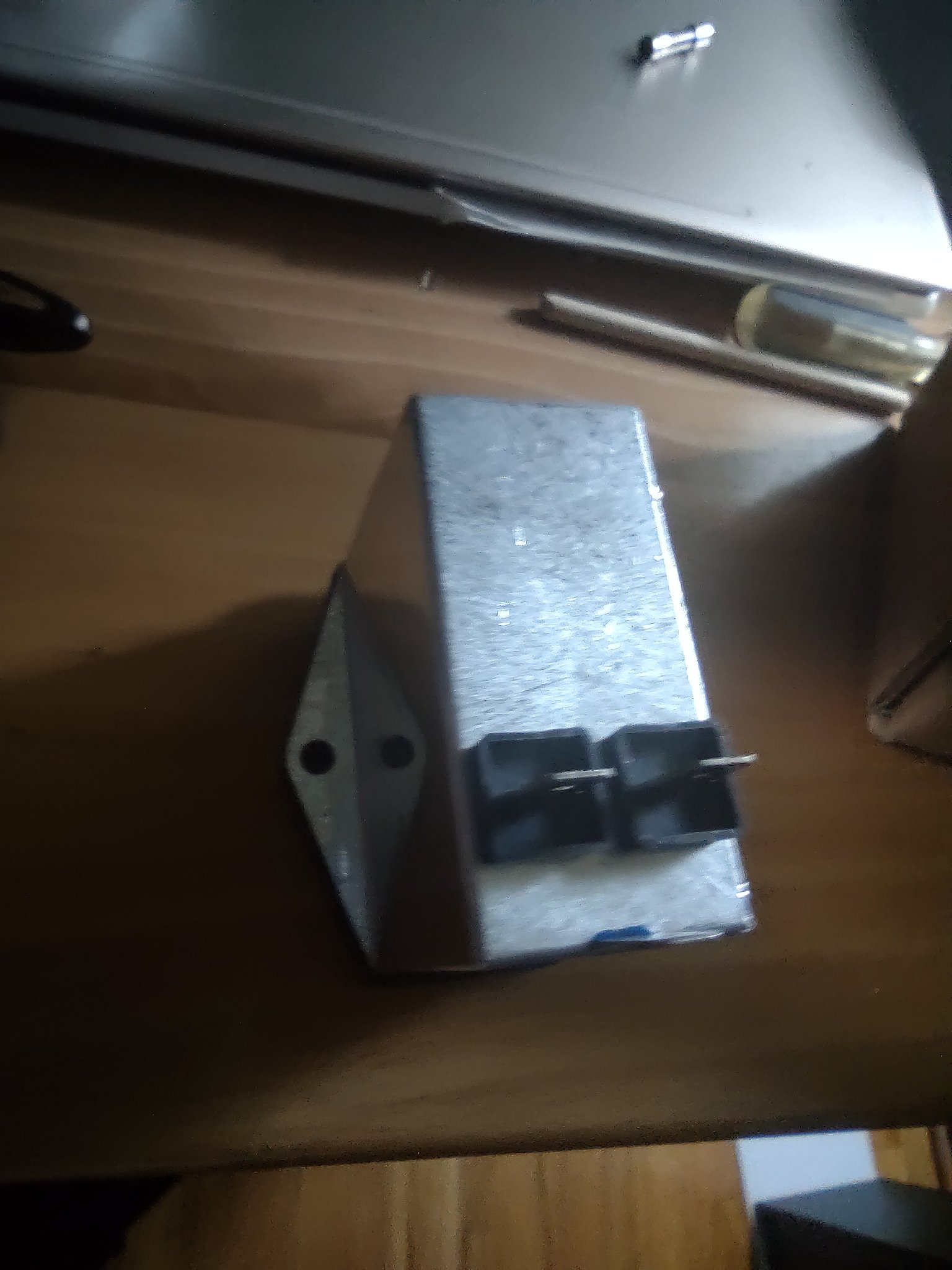

Yes, once I get home later on. For the most part, the drawer suffered the majority of the damage. I will replace the entire unit anyway, need to find one without fuses that fits the hole. I have two rear panel finishing kits from store arriving today, not sure if they even fit, seems like I read the opening is now different.
These are the only two of my amps that this happened to. I don't think it had anything to do with it, but these same two amps I did an experiment on, based on another members post called something like "converted to mono blocks for $10" or similar.
One board was removed from each, and placed in the other, so each amp had one board from each amp. A switch was installed that lite up one board at the time, converting it to mono blocks
Ran them like that for a while, determined I didn't prefer it and returned them to individual amps. Fuses have not been changed since then, and that was a while back, over a year at least.
I have been feeling the drawers on amps lately, but none feel hot!
The only thing I can think of is the 4 amp fuses, but still, all of my amps have 4 amp slow blos. 2.5 amp slo blo, should be getting delivered soon.

I ran PoP hard last night with it's temporary power supply, wiring is crimped only on schurter, tabs ARE soldered to the wire. The back of the drawer is cool, and inspected upon shutdown, all fine.

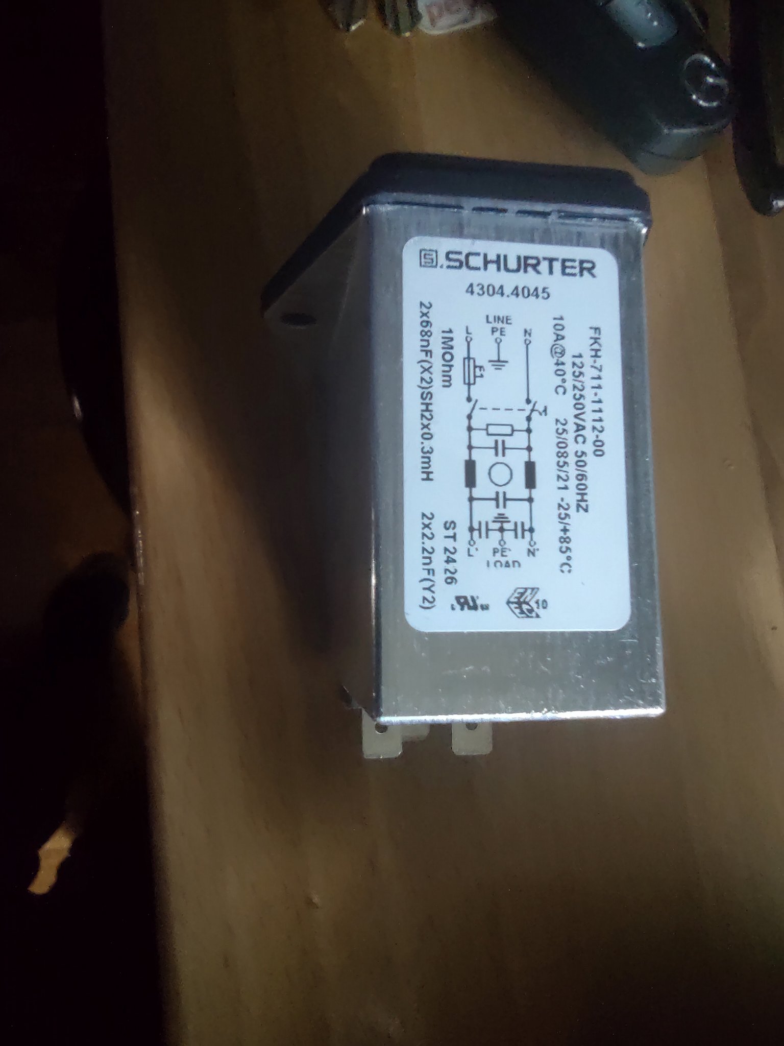

The new rear panel kit arrived today, indeed they have changed this to a different unit.

Once I have time to remove these, I can take pics showing the main unit damage, find serial number etc.
One is pretty fried inside, can see some in first few pics.
The more I think about it, preliminarily I think this damage occurred during the mono block conversion. Whatever happened did so to BOTH amps, no others. These have had the same fuses in them for years.
I find it hard to believe this thing would have got "melt" hot without failing over last couple years. Possible that damage occurred, amps still functioned and held up all this time? Seems more likely but no less scary
Might be the weekend before I will have time.
Only one fuse survived in one piece, it says BUSS on one end
"Once I have time to remove these, I can take pics showing the main unit damage, find serial number etc...."
The pic of most interest to me would be the backside of the Schurter unit in Post#'s 1 & 2.
No need to remove it, show it in its 'as is' state.
