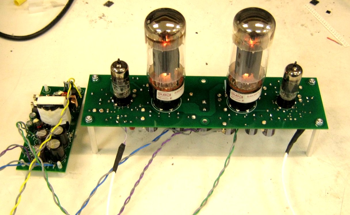

I fired my DC-DC converter up last night, and it works pretty much as advertised. After some tweaking, I plan to bias up the tubes sans transformers.

I just mated the DC-DC converter to the amp, with output plates shorted to B+. Voltages and bias current levels are pretty much where they need to be, which is a small wonder, since I'm using a non-standard screen voltage for the output tubes, so the value of cathode resistor was an inspired guess. With 5k output transformers, I may get about 8W/channel, not too shabby for a little amp like this.
Oh, and I forgot to mention, the DC-DC is running lukewarm - the tubes are nice and hot, as they should be...

I fired the amp up with an Edcor GXSE transformer connected on one channel, and a scope probe on the plate of the output tube. Sure enough - oscillation. With a partial feedback amp like this one, you need to worry about stability for both the inner and the global loops. I'm using a 6EW6 with loads of transconductance at the input, so there's lots of open loop gain coupled with a reactive load.
I added compensation (47p + 10k) across the inner loop feedback resistor, which quelled the oscillation. I'm going to have to revisit things and optimize the feedback compensation for optimum bandwidth and stability. I'll probably want to do that with the Transcebndat transformers rather than the Edcors, as they should be a cut above. At any rate, what I saw was not too surprising - more later.

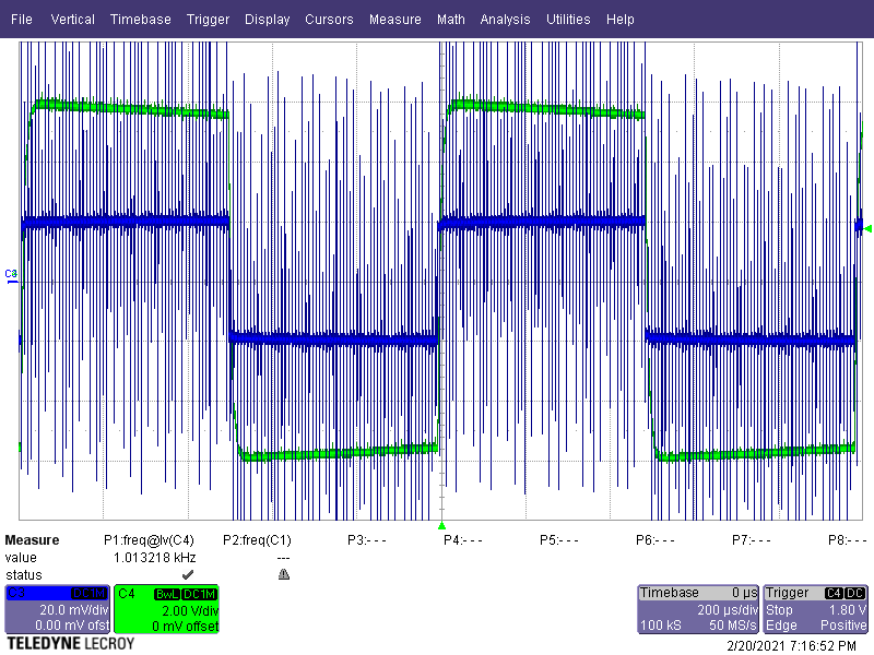

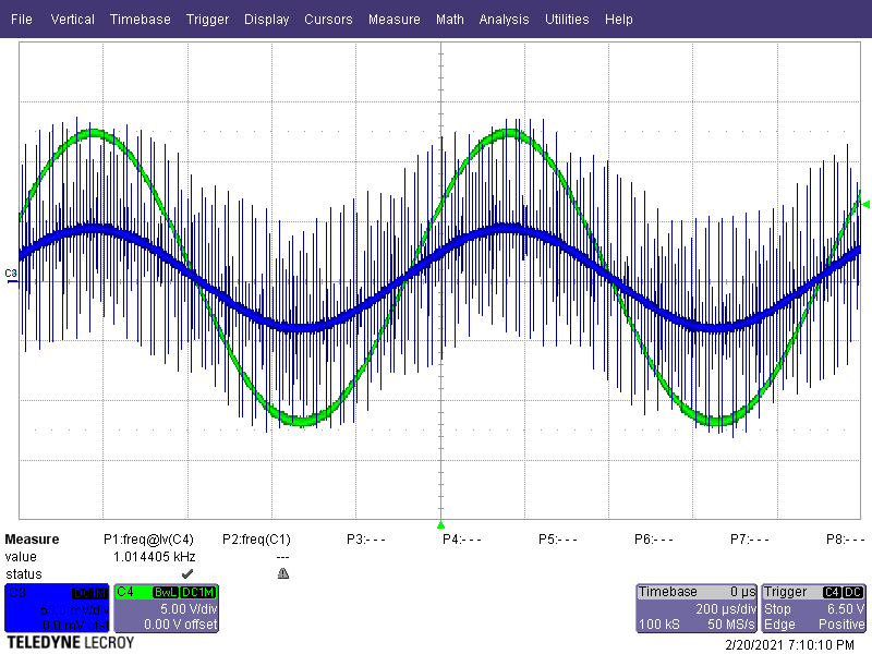

OK - yesterday I hooked the new Transcendar 7W transformers to my amp-in-progress and hooked the inputs to a function generator. Results are attached. It looks like the choice of 6EW6 as input pentode results in too much excess gain. It looks, however, like the compensation I mentioned from last week has stabilized the inner loop, so that there is no instability with square wave excitation. It looks like I need to change the input pentode to something less lively. The options I mentioned a couple of posts ago are on the table. Also an option are some little "peanut" pentodes like the 5725 and 5654. I have a small stash of used units from some Ebay tube assortments I bought a few years ago
The fuzz you see on the inputs is common mode noise from the DC-DC converter powering the amplifier. This will be addressed in the near future.

I think what I might end up doing is subbing in a 6AH6 instead of the 6EW6 (lower transconductance), and increasing the value of cathode resistor to both lower the first stage bias current and the overall gain. Of course, the load resistance will need to be increased to keep the plate voltage at the same point - I'm shooting for ~200V..

The fuzz shown in the waveforms from a couple of posts ago is only on the input waveform, not the output, and is caused by common mode noise coming out of the SMPS powering the amp. picked up by the scope probe. The scale on the input is only 20-50 mV/div. I'll be adding some cancellation windings to the SMPS transformer to help fix that.
I plan to keep the transformer in the global loop, so I will be drastically reducing the open loop gain of the amp. Now I see why people are starving the input pentodes on their amplifiers...

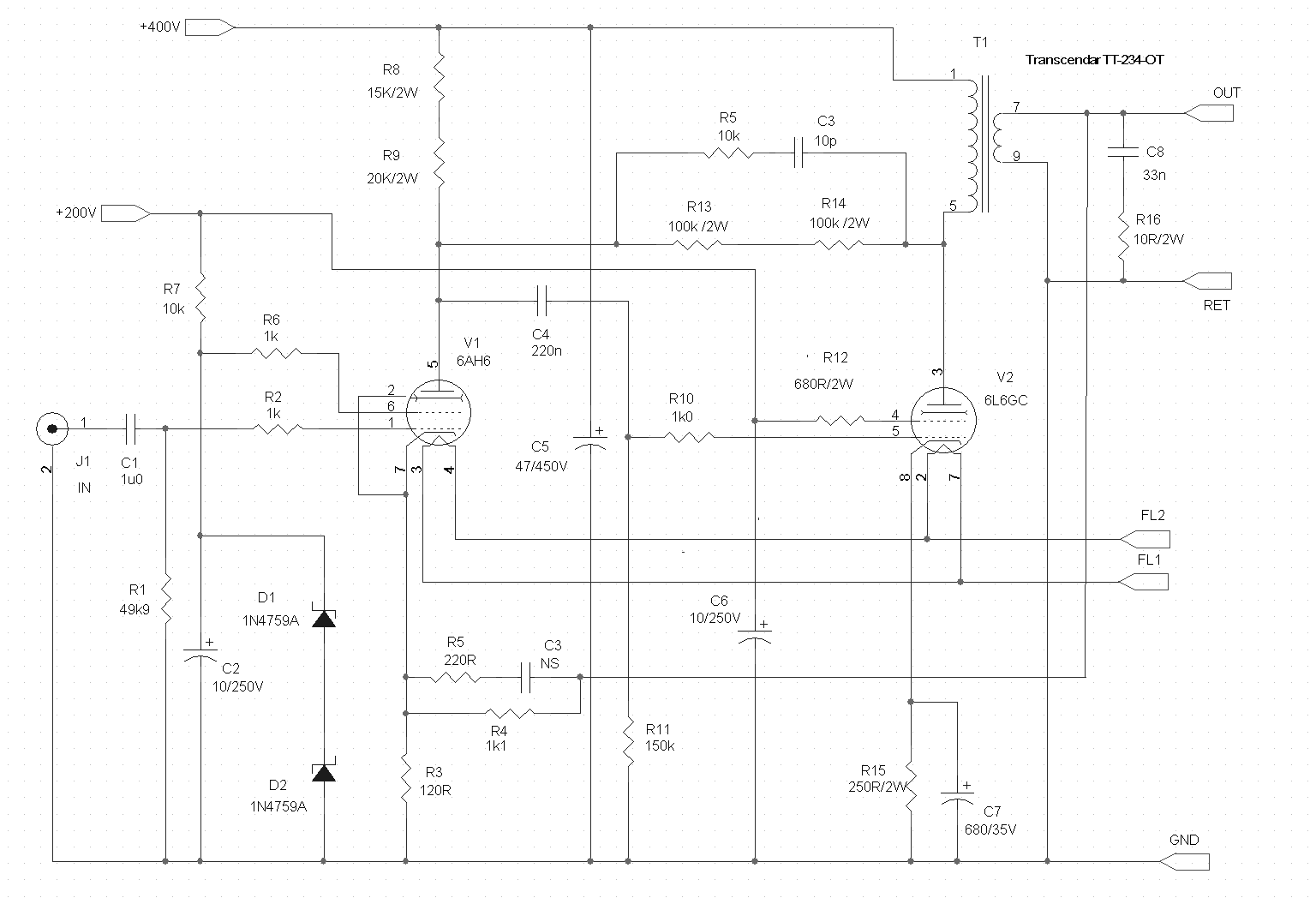

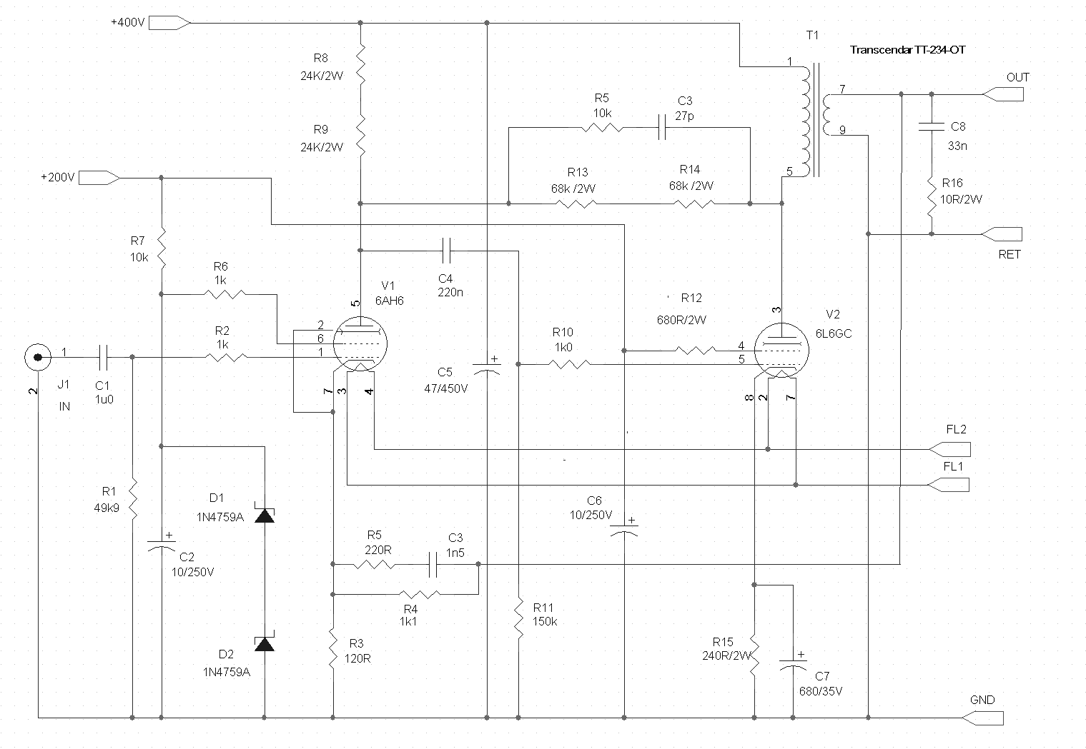

Today I had the time to substitute 6AH6 for the 6EW6 at the input, and to adjust the bias resistors for a lot less minor loop gain. The schematic shown shifts the minor loop gain from 300X to about 20X. Closing the global loop will happen next week.

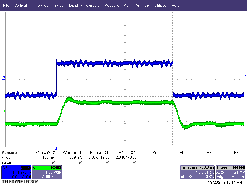

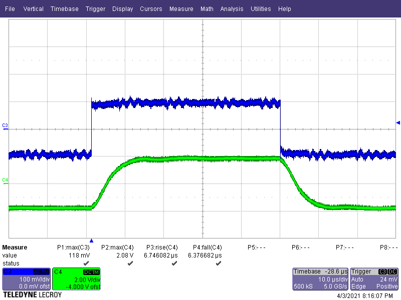

I shifted resistor values again to boost gain with only the minor loop io place, I'll post another schematic soon. The results of this jiggering around are shown here. The first pic shows the input and output with only the inner loop feedback in place, with 10kHz square wave excitation.. The second shows input and output with the global loop in place. Next week I'll do a session with a gain-phase analyzer and true up the global loop compensation to get rid of the output overshoot. This one is almost ready to stuff into a decent looking enclosure.
