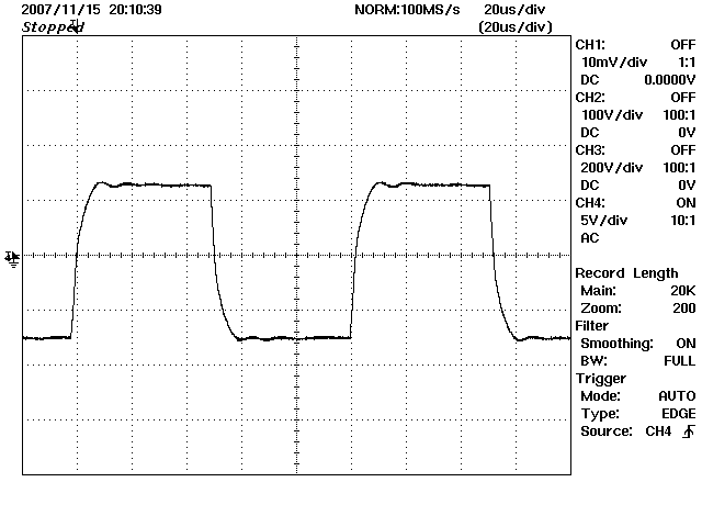

Attached is 10 kHz square wave respone with 2.2 nF compensation - needs a touch more compensation cap, say 2.7 nF. The transformers sing audibly with high level square wave excitation.

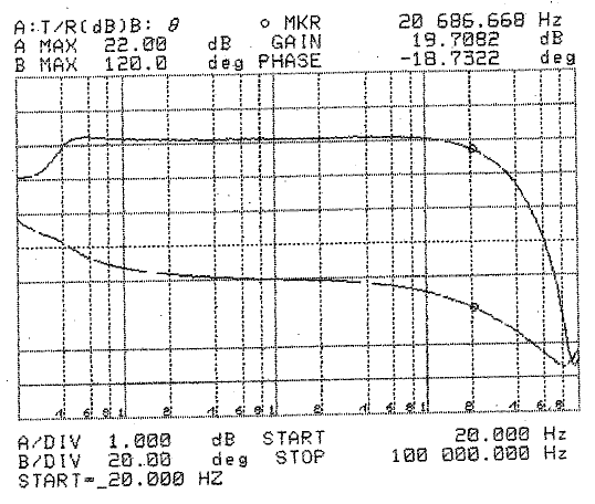

Here is the frequency response with 10 ohms load and ~100mV excitation. I wanted to use enough excitation for 1W RMS output, but it overloads the inputs of the HP4194A gain-phase analyzer I'm using.

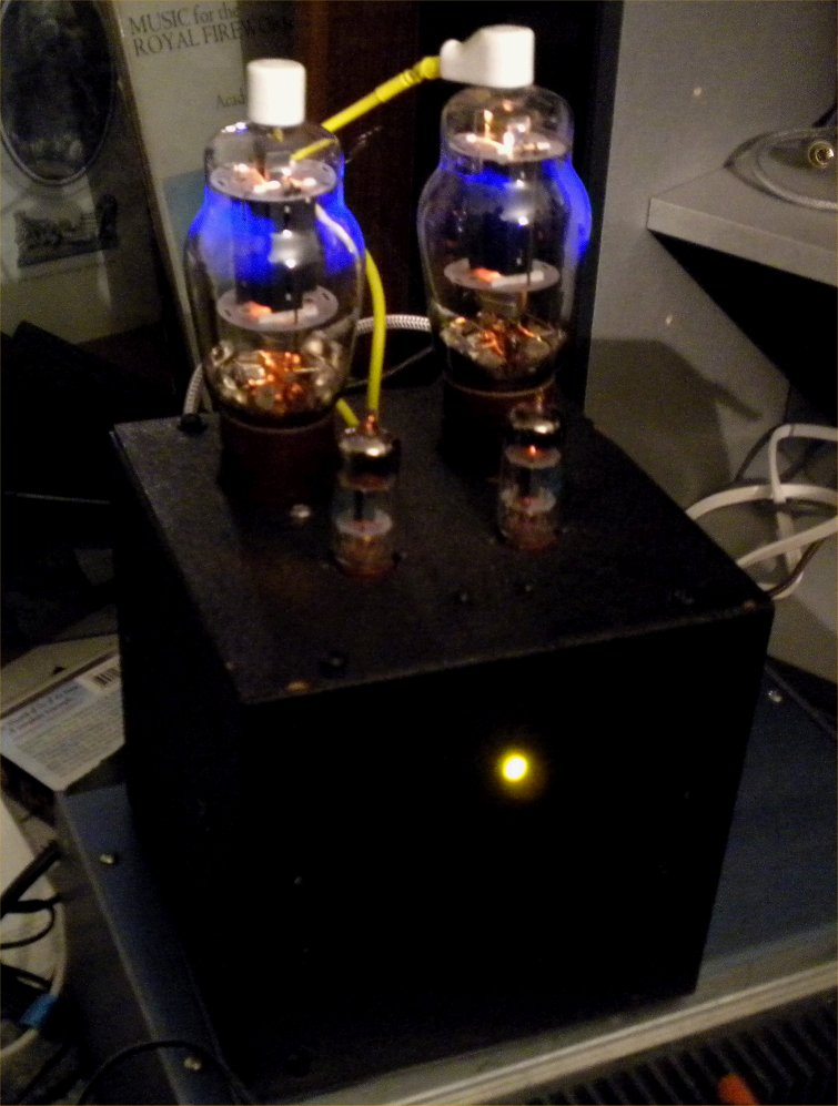

Spread Spectrum wanted some blue glow pics - here's one. This is the Shrine with a new/old set of 1625s, caught my my new Nikon point-and shoot. The pic is grainy, but the blue is very much in effect....
