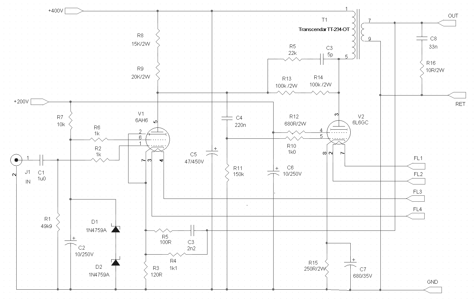

Some exchages with Tubelab have inspired me to build an SE amp similar to his Simple SE design, but using a 6AH6 pentode in triode mode at the input and a 1625 output tube (both extremely cheap and plentiful). I'm using the budget Edcor 5K single ended transformers at the outputs. The unit will be powered with an SMPS of my own design, providing power for both B+ and filaments. the whole shooting match will go in a 6" cube with the tubes poking out on top and the output iron and power supply inside. Finish will be black crackle, with a blue LED pilot light to complement the plate wires. Attached is a picture of the top deck. Next step is to power up the amp with a couple of bench supplies to look for screw-ups and check bias points. After that it's wring out the power supply (built and putting out voltage, but still needing a real going-over and EMI scan), integrate supply and amp, and throw it in the box. Schematic for the amp will follow when I'm sure it's all working.

You scheme sounds unnecessarily complex. I am using a current-fed-push-pull scheme with outputs for +400, +200, 12V filament, and an unused output for +/- bias. Regulation is provided by the 24V SMPS that drives the input, and should be far superior to the usual line frequency transformer/rectifier setup.

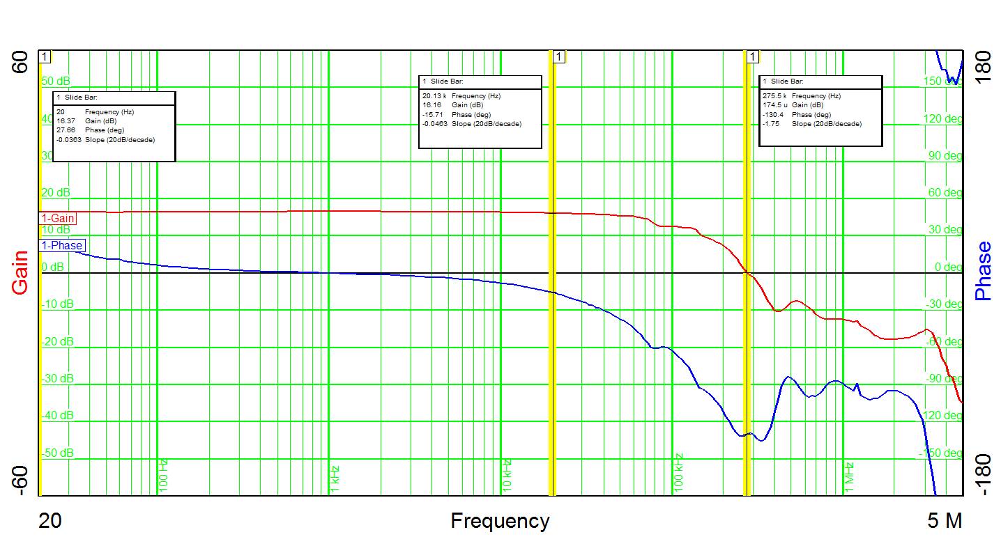

A Productive Afternoon...

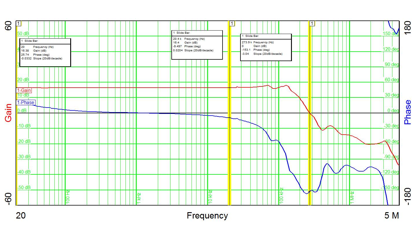

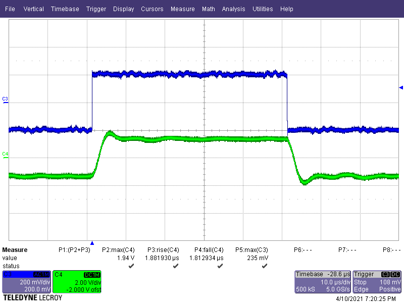

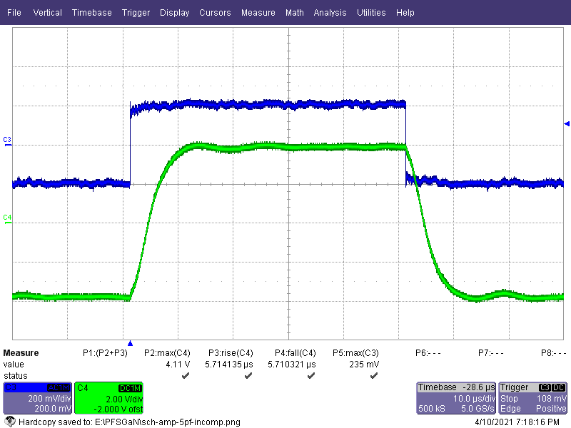

OK, I invested in some low value, HV ceramic caps to have more options for inner loop compensation for this amplifier. This sped up the inner loop, and gave me more options for compensating the amp in closed loop mode.
First up is the square wave response for open global loop with inner loop compensation of 5pF + 22k. The next pic shows square wave response for closed loop with no global loop compensation.

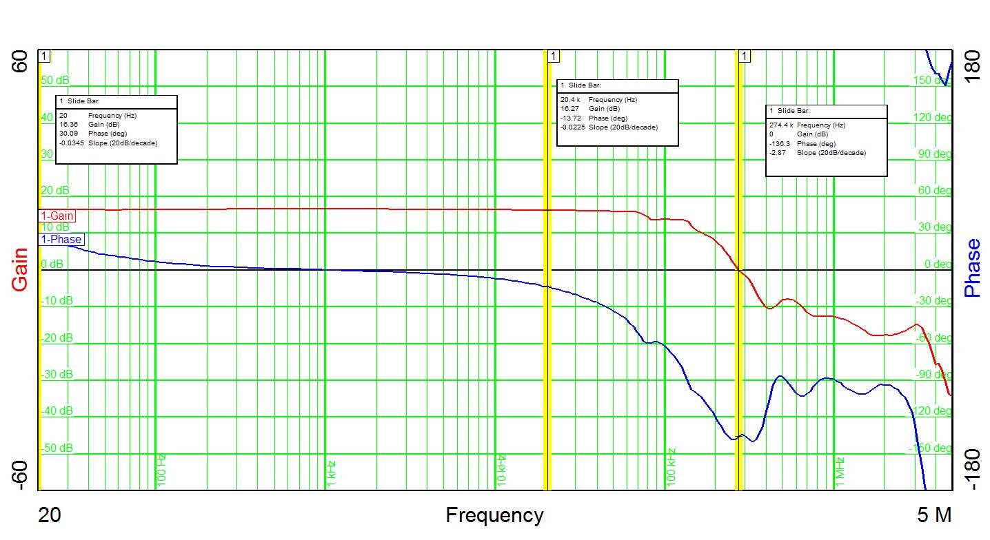

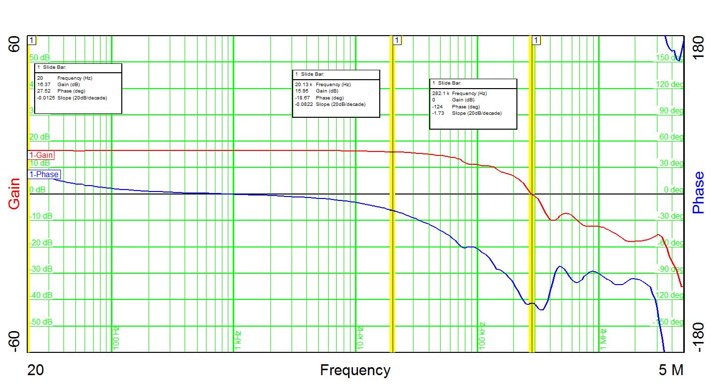

Next up, we have a series of closed loop G-P plots for compensation values of 0, 1nF, 1.5 nF, and 2.2nF.
The higher compensation values show a little (I mean a little) bit of sag at 20kHz in exchange for more phase margin at gain crossover. A stable amp is loads more important than a perfectly flat amp...

The gain-phase data was taken using a Venable 6305 analyzer. It only goes up to 5 MHz, but that's good enough for things like tube amps and switching power supplies (the latter is its real purpose in life).
