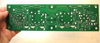

Here's the new board that just came in - different form factor. I'll be populating it and bringing it up in the coming weeks. I'll probably use a custom DC-DC converter run from a 24V SMPS for power rather than the original supply. As per usual, constructing a nice case will take the most time and effort.

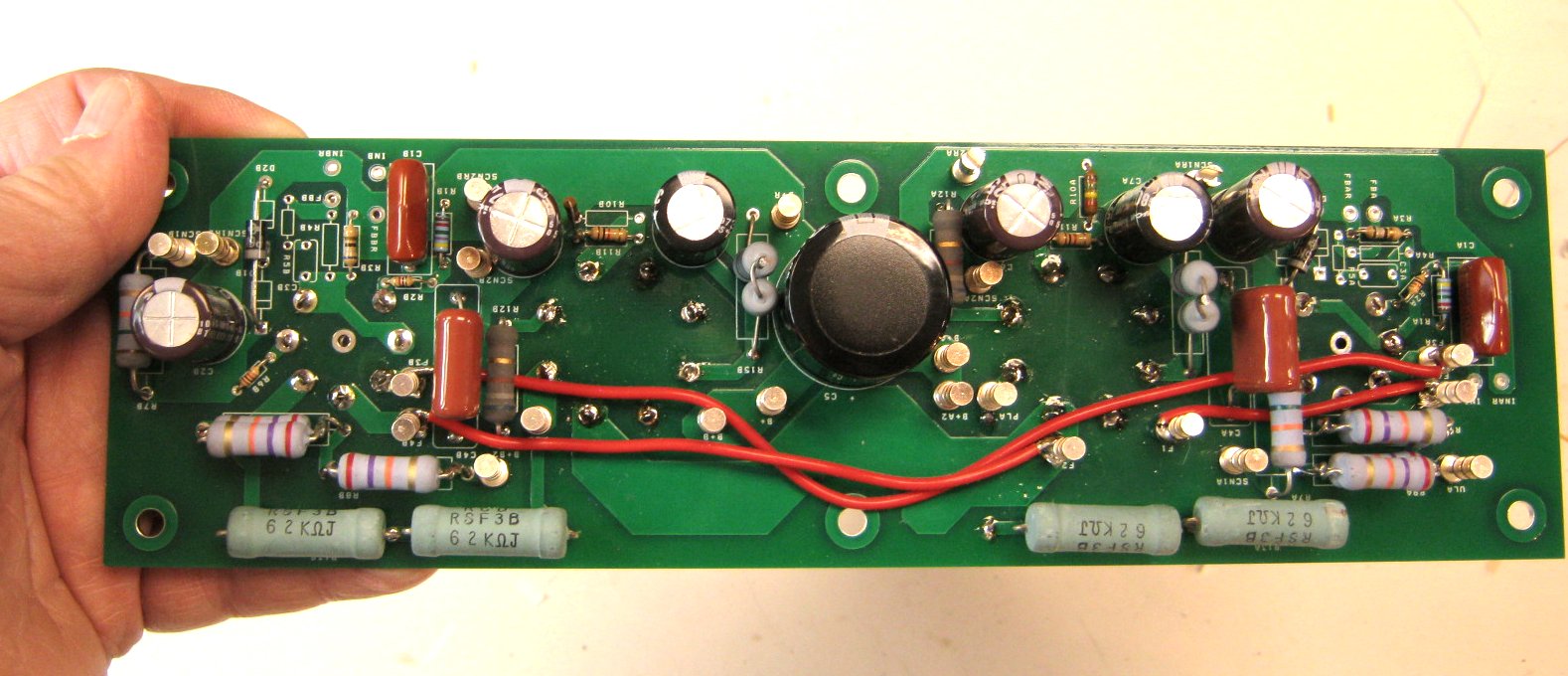

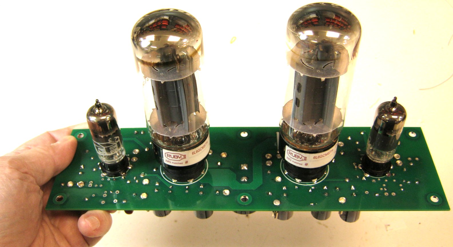

Here's the amp all stuffed and ready to go, except for the feedback components. I'll be running the beast with just the inner loop to start with and dial in some excess gain so I can use a bit of global feedback to stiffen up the XFMR response. Im building up the DC-DC converter so I can run the amp on just 24 VDC.

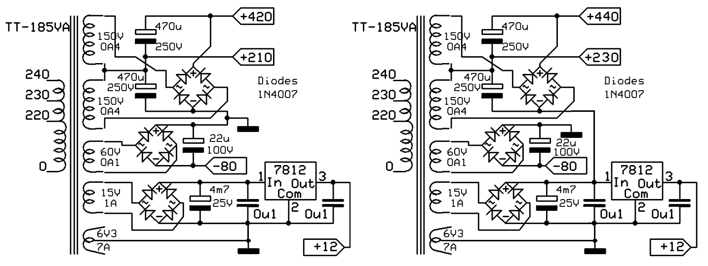

Regarding 400VDC and 200VDC B+ requirements. Would it be possible to use a voltage doubler to provide the 400VDC, and just take the 200VDC from before the doubler? Since the g2 supply will be so tightly coupled to the plate supply, does this reduce or increase the need for regulation of the g2 supply?
I have a bunch of 807-clones (5B/255M) and am interested in circuits that get round the g2 limitation. Triode wired with the RH807 is one option, but your circuit is very interesting.
With a transformer from TubeTown it is easy to get two voltage. For a bit more use the 12V winding in series.Regarding 400VDC and 200VDC B+ requirements. Would it be possible to use a voltage doubler to provide the 400VDC, and just take the 200VDC from before the doubler? Since the g2 supply will be so tightly coupled to the plate supply, does this reduce or increase the need for regulation of the g2 supply?

Ketje - I'm using an SMPS to generate both thee B+and the filament voltage. I'm putting the 6EW6 filaments in series, as well as the 6LC^Cs, and running both series strings in parallel. The SMPS is a custom DC-DC converter that will be powered from an external 24V switching adapter. This takes 1/3 of the weight out of the amplifier.

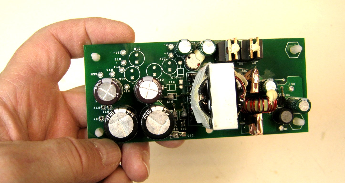

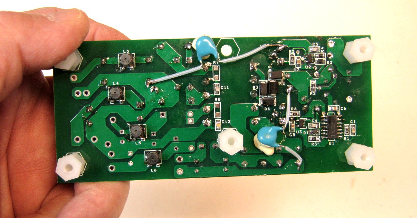

Here's the DC-DC converter in question populated and ready for test, using a current-fed push-pull topology. This module will supply plate, screen, and filament power using a 24V SMPS to feed the input. I've added some frills to quiet down the supply, which will make it to the next layout if they work.

Nothing did go wrong.. I tried an RCC flyback for my first Shrine power supply, because I had analyzed RCC flybacks for years, but never built one. It worked OK once I solved some of the EMI issues, but I replaced it with a quasi-resonant flyback using the L6565 controller, improving EMI and efficiency.
The current fed push-pull is a natural for low voltage input and relatively high output power. I have used it in several applications already with great success, form a small unit powering a VT headphone amplifier to driving a thyratron blinker, also a similar amplifier than one shown here, but with a CF stage between the input and output tubes..
