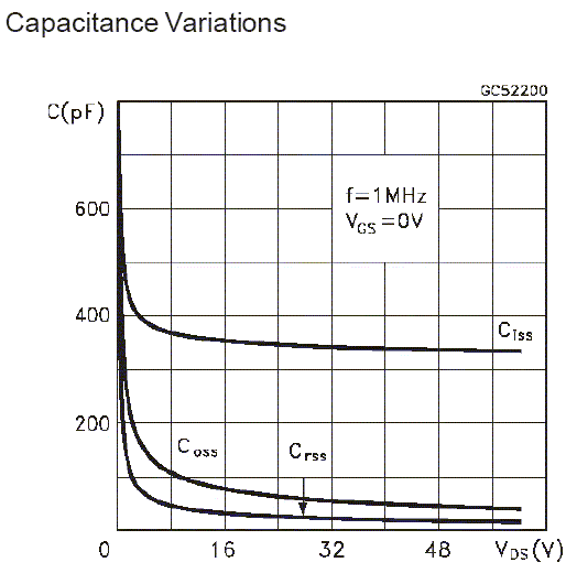

Zigzagflux,
Sorry for my late reply, but I just now saw your post and question. The capacitances that I refer to are intrinsic to the physics of solid-state devices. I do not tend to think of them as "stray". Maybe it’s just semantics, but to me "stray" implies external capacitances between two conductors and is very much layout dependent. While we generally want to keep those low too, strays are usually not signal dependent (non-linear), but they may be microphonic, a topic for another day.
I do not think that your circuit solves the Ccb loading problem, unfortunately. The plate resistance "sees" the Ccb of the MJE350 as if it were grounded directly at the base end, because the base end of Ccb is AC grounded through the LED (or even through your Schottky replacement), through the 1uF, and then through the PS capacitance to ground. Whatever series impedances these parts offer at high frequencies is trifling compared to Ccb, and they may be considered shorts to ground in most cases. As someone mentioned earlier, it’s hard to solve this problem by adding an isolating resistor to the base of a BJT like the MJE350, because it will drag down the performance of the BJT. A MOSFET, which may have an even larger Cdg, can at least profit from a large-value resistive divider to set the DC gate voltage, but even that provides a feedback path from drain to gate, possibly modifying behavior at high frequencies. As I’ve recommended before, I would refer you to Gary Pimm’s CCS work, not as the only possible solutions, but as a good reference on how to eliminate the shunt C, at least to a very large extent.

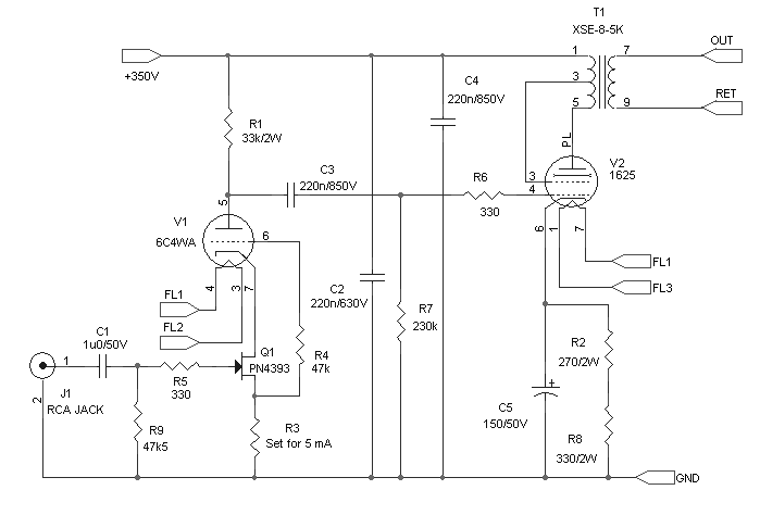

Attached is the latest incarnation of the "Shrine" amp. I've ditched the current source loading and am using a JFET input cascoded with a triode. I'm going to fire up the circuit sans feedback to check the overall gain, and if it's what I expect, I'll be applying some feedback to the JFET source. Next in line is buring in the SMPS. Unfortunately, events (like a computer trash) have kept me from giving this project the attention it deserves. Hopefully, I'll be able to box it up soon, and give it a place of honor in the living room...
wrenchone,
Is there any particular reason for the lowish 47k5 gate-ground resistor on the input FET?
pm
pm
I'll be driving the amp from a solid state source, so 47k is just fine. Even if I were to use a vacuum tube preamp, I would design one with a cathode follower output. In general, I don't like using really high impedance terminations on inputs available to the outside world.

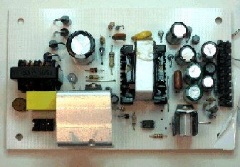

Next pass - I let my SMPS warm up on the bench today with resistive loading, and it settled in at around 85.3% efficiency at 115VAC input, using a sine wave source. The efficiency calculation assumes that the load resistors are dead on at 3.6k and 9 ohm load for the 350V and 12.6V outputs, respectively. Since the resistors are 10% tolerance, the efficiency could be a little off either way - I was too lazy to break the output connections and insert ammeters. Nothing is getting hot, so the losses are pretty evenly spread out.
Conducted EMI needs a little work, but I'm pretty sure how to fix it. As I expected, the really high frequency noise is down in the mud using a self-oscillating supply. I expect another rev on the transformer will help tame down the EMI. I may also look at a better layout that I've done since this one, as I suspect the primary swiitching FET may be a little too close to the input common mode choke in the original incarnation of the supply. I may also try grounding the FET heat sink to primary return through a resistor. I'm using a full-pack TO-220 FET, so that the drain is not directly nailed to the heat sink, but the sink may still be acting like enough of an antenna to mess up the conducted EMI.
Ok - this thread rises from the dead. I've done a lot of fiddling off and on over the months with my SMPS to minimize EMI - not the simplest proposition, as both the primary and HV secondaries are a source of RF racket. Transformer design is crucial, as well as grounding the primary switch heat sink and the transformer core to primary HV return.

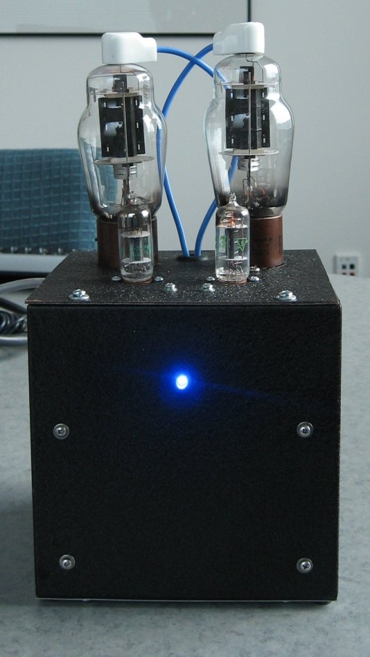

The amp and power supply were integrated last Saturday for a showing at the Burning Amp fest in San Francisco, and I got everything buttoned up and working satisfactorily. I didn't get a chance to audition the amp at BA, which was a shame, as there were a number of high efficiency speakers there that would have been a nice match. People did ooh and aah over the small form factor, though. So far, I've been confined to using the Paradigm Monitor 7s we use at work for audio testing (they call 'em Paradigms 'cause I wouldn't give a pair o' dimes for them...). Not the most efficient speakers in the world, but the amp will drive them to reasonable levels. The major bottleneck is the tiny Edcor output transformers I used. I can easily get the transformers to saturate with difficult material at high volume. This amp is definite inducement to complete the ported MTMs I have in the works.
Pictures, updated schematics, and some performance stuff will follow when I have a little more time for documentation. This is the first in a suite of compact amps using SMPS.

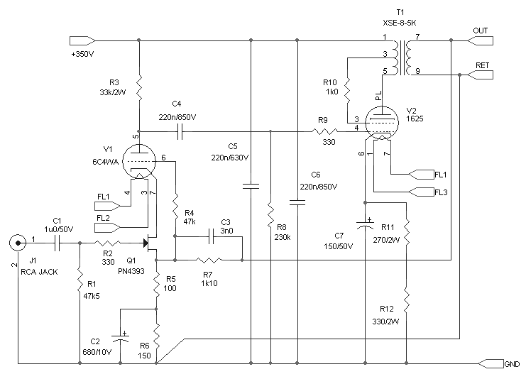

This is the final schematic for one side. Inside the amp, the two 1625 filaments are connected in parallel, and the 6C4 filaments are in series. The filament voltage on the SMPS is tweaked up by about a volt, and a 5 ohm inrush limiter is connected in series with the filament supply. This keeps the cold filaments from going ballistic when confronted by the SMPS at turn-on. The thermistor gracefully warms up and leaves the filament supply at ~12.7V.
This is really the schematic I intended to attach to the last post. Comments from the last post still apply. There really isn't anything too much out of the ordinary about the circuit except for the JFET in the first stage. This is something I've seen used in classy RIAA preamps, but not in a power amp. I did it for the gain, so I would have something to feed back to lower the output impedance.

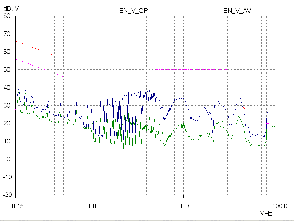

Here is an EMI scan of the complete amplifier, with no cables connected except for the power cord. Things are pretty good until you get to the high frequency region. The big bump and assorted rubbish beyond 30MHZ are a bit of a mystery, since self-oscillating flybacks are suposed to be pretty quiet in the very high frequency region (comments, Eva?). It may be because I'm using a discrete bipolar SCR to turn off the primary switching FET (fast). It may also be that the 1625s are singing soprano, something they and their 807 brothers are prone to doing. I'm trying some plate snubbers in the classical manner tomorrow to see if this helps. My ultimate solution (if the 1625s are not at fault) is to replace the current self-oscillating flyback supply with a ZVS (zero voltage switching) flyback supply, which should be a lot quieter and more efficient to boot.
An explanation of the previous EMI scan - the limit lines shown are the EN55022 limits both average and quasi-peak measurements, and the traces shown are the average (lower trace and limit) and quasi-peak (upper trace and limit). A pass with 6 dB of margin is OK, and a 10dB pass is quite good. Most of the EMI spectrum has 15dB margin. The disturbing stuff is the > 30 MHz rubbish. More on that later. Attached is the amplifier 10kHz square wave response into a 10 ohm load (closest power resistor at hand). I think I can get a little faster response and still slightly overdamped by using 2.2 nF of compensation instead of 3. (when I was working on the loop a couple of weeks ago, I only had increments of 1.5 nF at hand, and one was not quite enough).

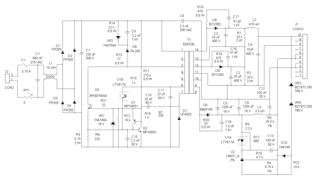

Attached is a schematic for the power supply. There is no SMPS controller chip. The design type is generally referred to as a "ringing choke converter" or "self oscillating flyback", and if you load Google with those search terms, you'll be rewarded with some basic background info and papers. I chose this design because it runs in borderline discontinuous mode, making it appropriate for high voltage outputs. I also chose it because the pirmary FET switches fairly slowly and generates less EMI (in theory). I learned quite a lot adapting this sort of design for powering vacuum tubes. The dV/dt on the HV outputs makes EMI more of a problem than a design with low voltage outputs.
One particular problem with multiple output SMPS is output sequencing. I used the DC filament outputs for feedback to set output voltages, especially as I wanted the filament voltage to be tightly regulated. A thermistor connected in series with the filaments (not shown) limits inrush current. When the supply is first turned on, the filaments are cold, so the plates draw no current, and the HV output shoots up to 470V from a nominal value of 350V - not nice, both for the tubes and the output filter caps. The Neanderthal way of solving the problem would be to use a substantial preload resistor on the HV output. I instead used a series zener string (380V total) connected to the summing node of the filament voltage sensing divider. When the HV overshoots, the zener chain conducts and limitts both the HV and filament voltage excursions until the filaments warm up and the tubes start drawing current. This has an added benefit in that it provides additional soft start for the tube filaments.

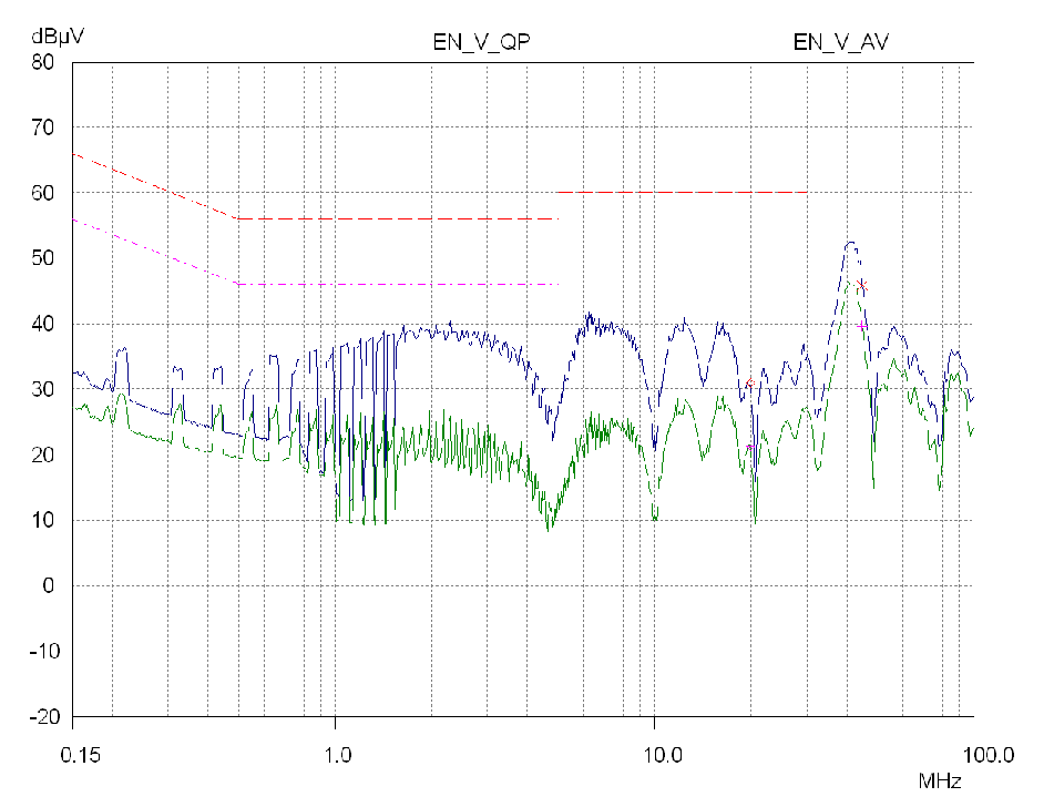

I added snubbers to the output rectifiers and some additional EMI filtering inside the amplifier chassis, which definitely did some good.
This is the EMI scan with the power supply modifications. The HF end has improved. This will do until I can construct a quieter power supply using a zero voltage switching flyback topology - more about that later.

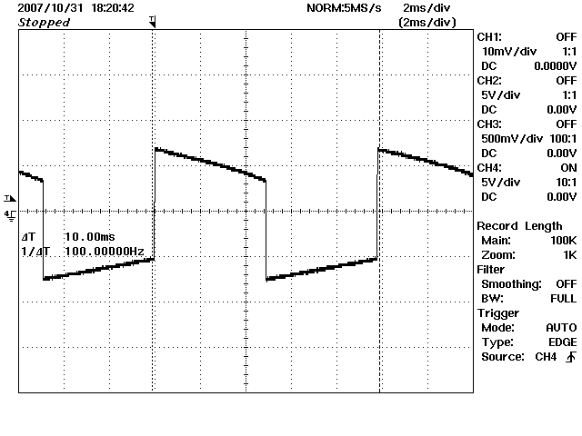

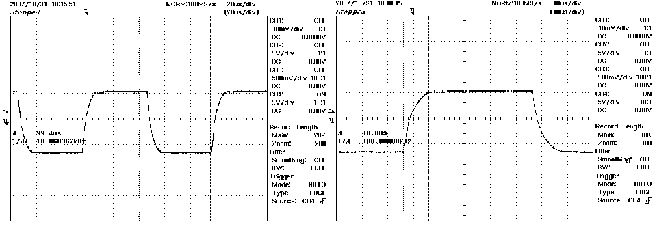

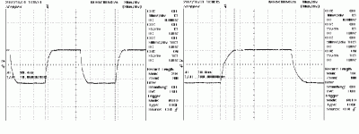

The amplifier was modified with 2.2 nF compensation caps to replace the 3 nF caps used before. I'll be taking some square wave response pictures to domument the effect of this change shortly, and do a frequency response scan when I get back in to work. Currently, the 1625 output tubes are biased at 50 mA apiece. They show no signs of distress at this dissipation level. The next thing I intend to try is to boost the bias to 70mA, as tubelab reported that the small Edcor transformers sound better with more bias. We'll see....
