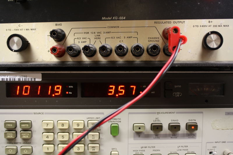

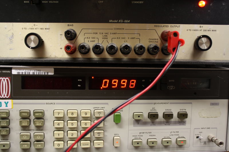

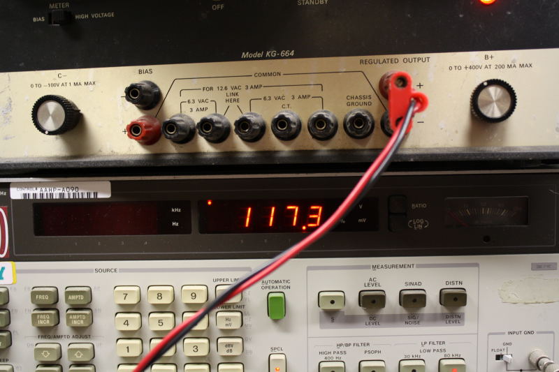

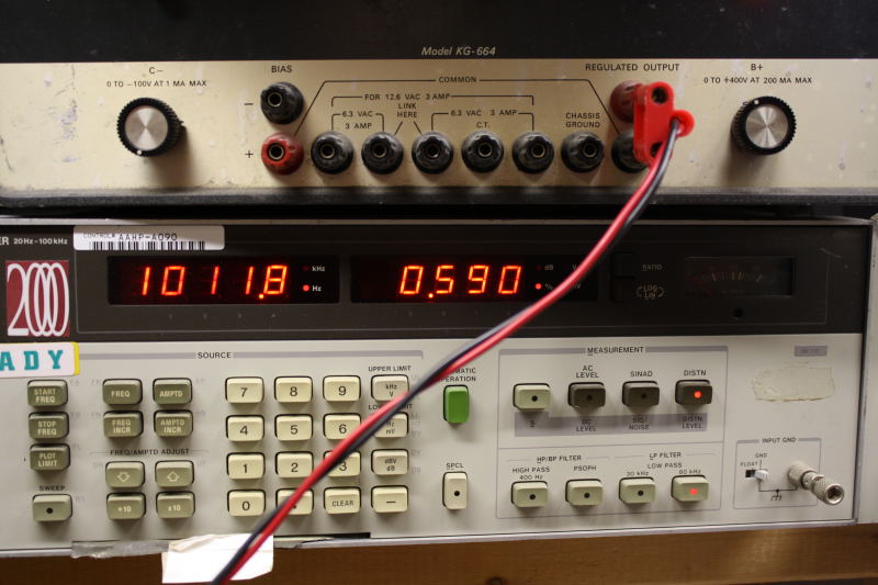

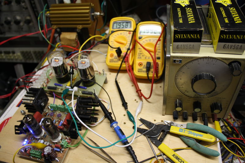

Tonight I revisited some old friends, the 6AV5GA. My first screen drive amp about 6 years ago squeezed 80 watts from these tubes through this OPT on 550 volts. Tonight we test dual drive under the same conditions.
Picture #1....idle current 9mA per tube.
Picture #2....adjust power to 0.1 watt, Ok, 0.0998 watts
Picture #3....crossover test.......0.590% no problem here.
Picture #4...turn audio generator up till distortion is about 3%
Picture #5....setup 8903 for "watts into 8 ohms"...read meter....117.3 watts.

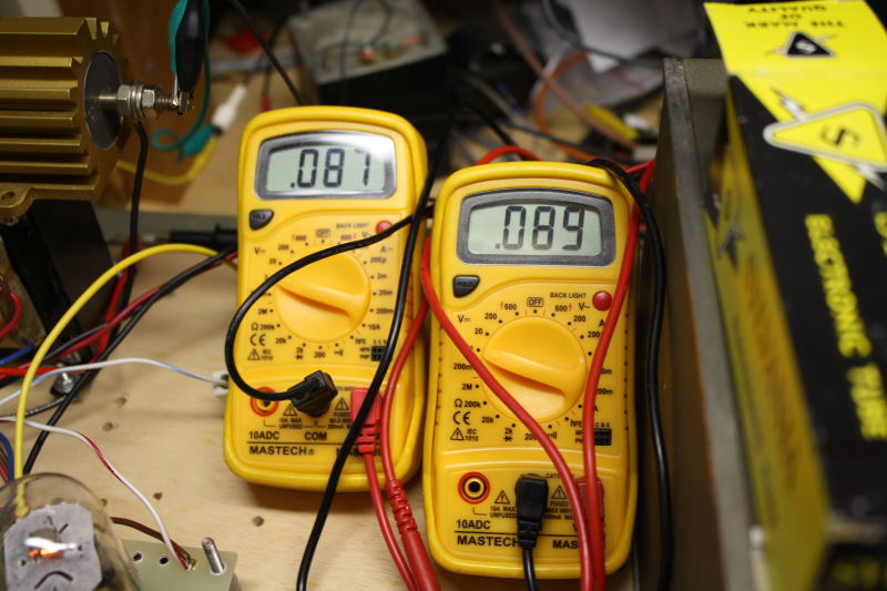

Picture #6....crank audio gen +10db square wave reads 151 watts, no glow on screen, faint glow on plate. Return to 100 watts, glow goes away.

I forgot to state that the load impedance was 3300 ohms. I went back into the room after watching TV for 1/2 hour. Everything, including the tubes was cold to the touch, except that big gold anodized load resistor it was still rather warm.....Hammond transformer kind of warm. Those things are supposed to be mounted on a thermally conductive panel or heat sink.

That behavior is unusual. Most class AB tube amps dissipate the most power somewhere between 1/3 and 2/3 power. This one clearly got hotter the harder I cranked it. At 150 watts the output was a reasonably clean square wave. I will try to make some more mesurements when I have time.
I don't have many 6AV5's, but I will be rewiring the output sockets for the 6l6GC, EL34, KT88 tubes soon. Then I will melt some more 98 cent 6BQ6's to see if the same failure mode exists as before. I have about 200 of those.
Is the glow going when you turn back to 100W because its no longer a square wave George? I have notived something similar when I was messing about with your 6L6 AB2 design a couple of years ago.
Cheers Matt.
Usually a guitar amp runs cooler when driven to hard saturation. When outputting a square wave the output tubes operate almost like switches alternating between saturation and cutoff, spending little time in the linear region.
The amp shows no color at 100 watts and a very dim redness after a minute or so into extreme overdrive. It should be cooling off. The most logical reason for this would be that the driver is not pushing the output tubes into full saturation. The 6AV5 has a rather insensitive screen grid, so this could be the case, but would require poking around with a scope to prove. I don't have time for this right now.
I do wish you'd write a book on tube power amps. You've done some wonderful experiemtents and have great experience with them!
Of course yes, they only spend half the time on and half off with a square wave.
It goes a little deeper than that. True, in hard saturation a tube or transistor switches from hard saturation to cutoff.
When cutoff the tube has plenty of voltage across it (about 2 X the B+) but no current through it (it is cutoff) so the dissipation is zero.
When saturated the current through the tube is at maximum, but the voltage across it is very low (ideally zero) so the disssipation is low.
The voltage drop across a sweep tube can be very low in hard saturation. I have seen levels in the under 20 volt region. The peak currents here should be around 667 mA (550 volts / 825 ohms).
I suspect that the tube is not being fully saturated, leading to higher than expected dissipation under overdriven conditions. I need to hook up the scope and watch the plate and screen voltages, but voltage dividers are needed to avoid blowing the scope input with 1KV+ signals.
