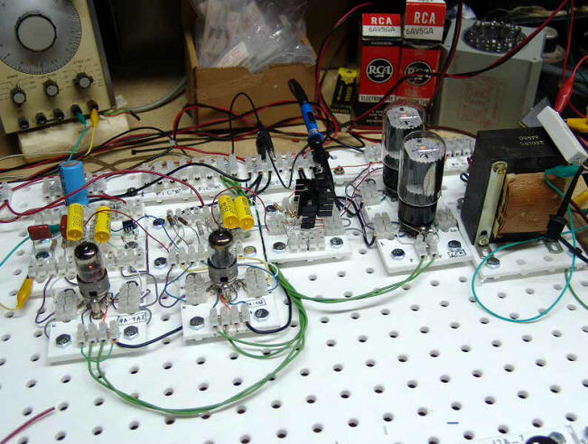

Never really thought about tubes switching, daft as I grew my teeth in a tv repair shop right at the end in the late 80s.
I think your right about not quite achieving saturation. Funny with such a stiff drive. Really no screen glow?

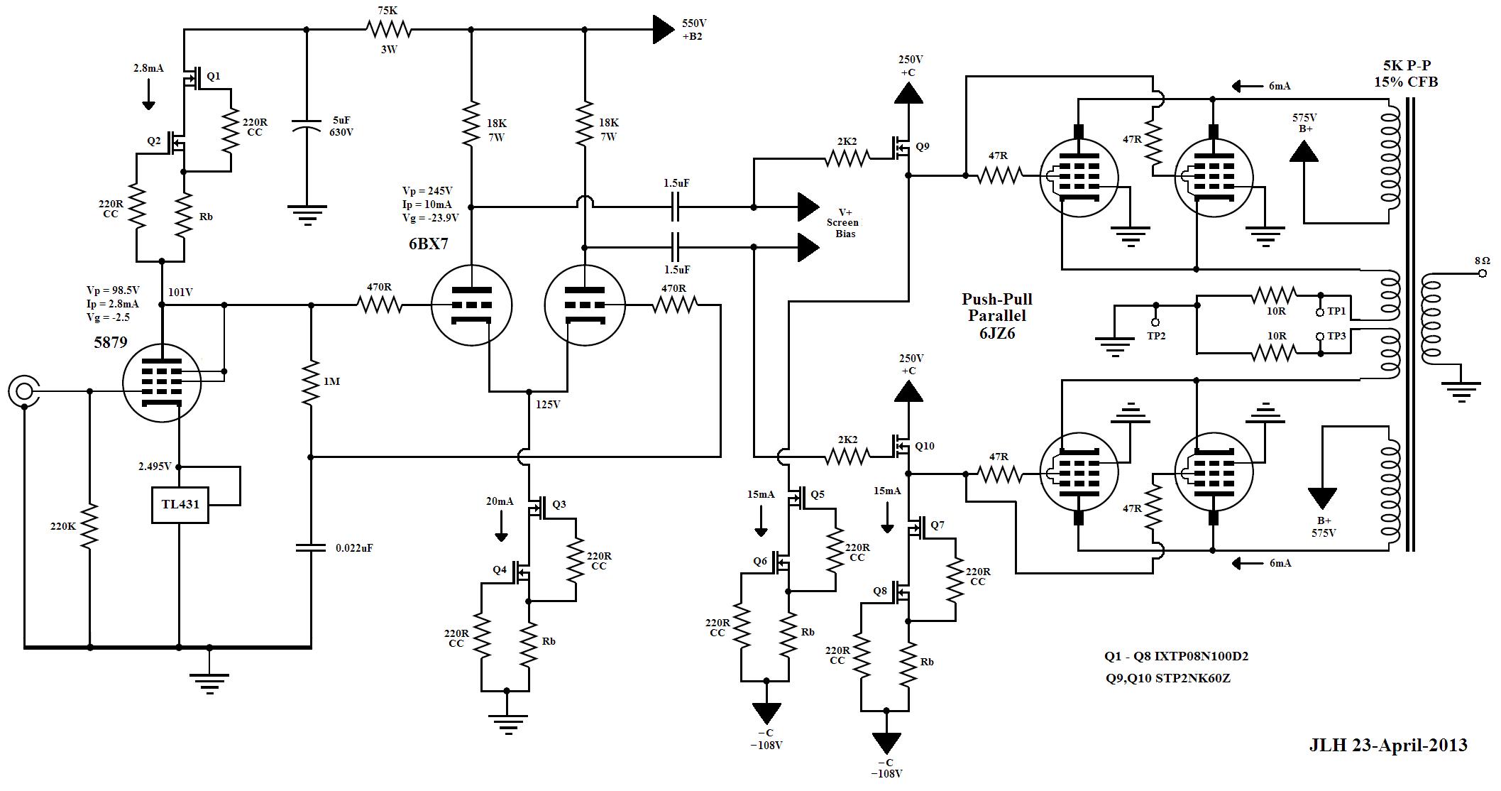

I would still like to see George's screen drive circuit somehow
My original circuit has been posted here in post #4. It is from about 5 years ago. The new one is still in a state of flux but I will post it here when I have time.

high Gm fet/GM tube effects
Hi there George: Wife thinks this would be a good idea to have a stealth xrone jammer in these perilous times, with a flick of a special switch, all that would be found would be a real cool super powerful audio amplifier....regards, Michael.
... Mosfets do unexpected things when transitioning through cutoff. The most common ugly thing is a quick burst of high frequency oscillation often well into the HF or VHF region of the RF spectrum. I have seen an amplifier that plays very well, sounds good, and measures good, but blanks out a TV set in the same room! Forcing a minimum current, even when the tube it is driving is cutoff is a good thing. Ferrite beads and stopper resistors are your friends..... Remember that a CCS is just a specially doped high Gm fet that will oscillate if given half a chance. Tying two high Gm fets to the grid of a high GM tube is asking for a TV jammer!....

i'm wondering how you have choosen the current value 15ma tought the CCS... Can you explain please ?
Tubelab-com builded his amplifier without CCS.
So is a CCS necessary ? please.
