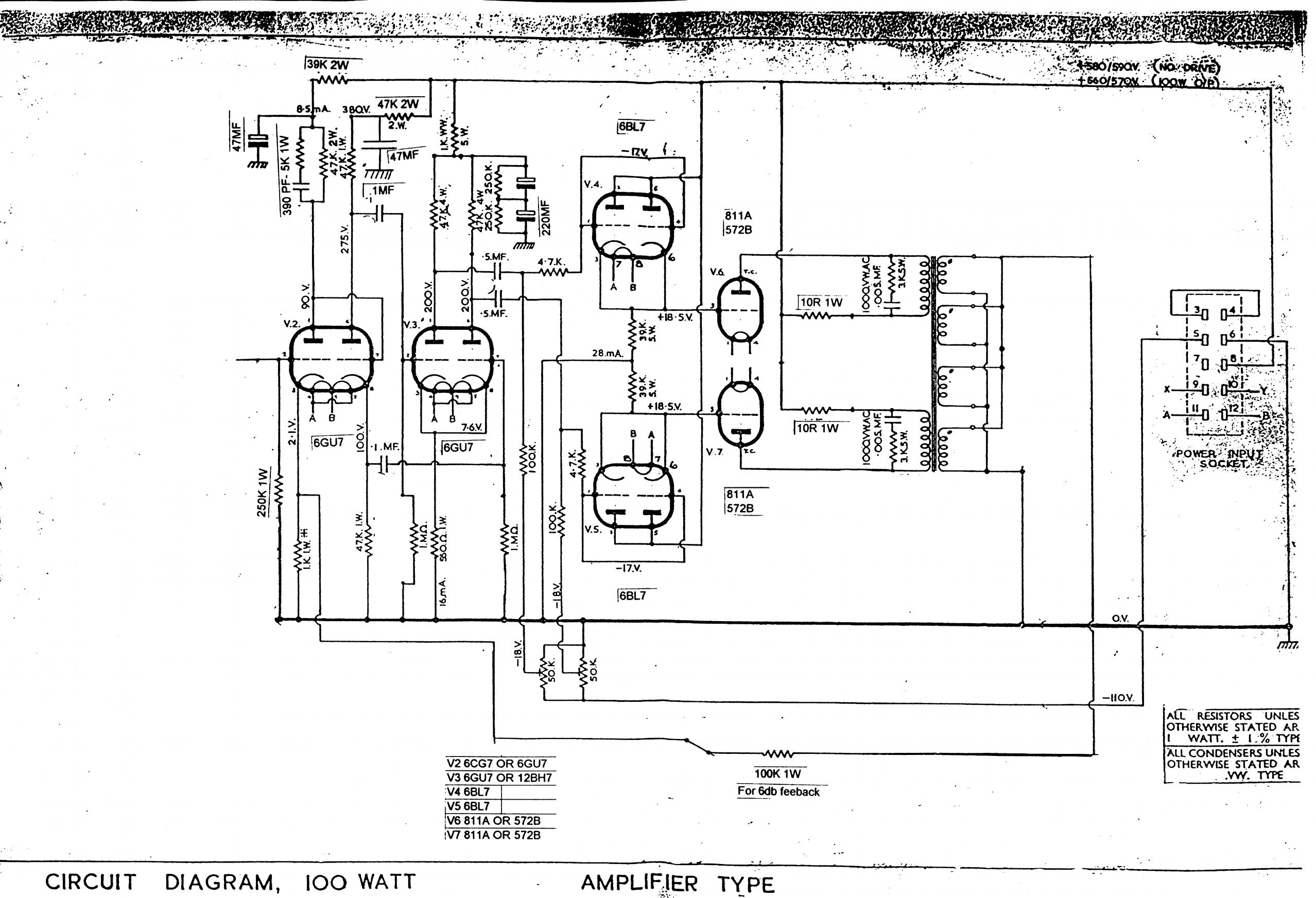

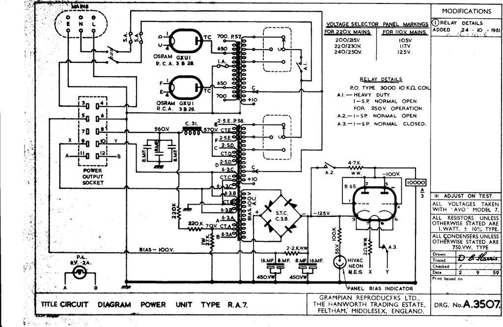

811A circuit
811A circuit as i built it. original Power supply circuit uses mercury vapour rectifiers I considered the Mv rectifiers would make the amp too big.
I used big toriodals and a bridge circuit; Choke input as you need very good regulation as you do with screen drive using EL509's as Zero bias triodes. I think best to use two heater supplies, so you can measure the current draw using two 10 ohm resistors to earth. Very important to have a slow turn on; protects the 6BL7's as the 811's /572b's heat up very fast, compared to the 6BL7's.
You could use sweep tubes instead of 811's, but when i tried them did not like the sound, at least with 811/572's you can use 70 ma current draw. 600 volts is the max with 811A's, less with 811's. 600 volts gives you 100 watts.
i have never tried using Mosfets instead of the 6BL7's as the 6BL's are cheap and trouble free. I regulated the driver supply, not sure if it is worth it.
Phil

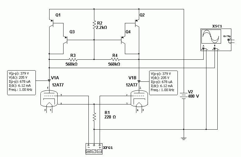

I think Mark Kelly suggested using a CCS loaded driver
I have seen a few circuits that drive G1 and G2 simultaneously going back as far as WWII. I don't recall the configuration that you refer to, but I am using a pentode LTP driver that already has a CCS in the tail. A second CCS doesn't work, I tried it a few years ago. A triode driver does like a CCS load, but I need pentodes for these experiments. I may try to apply feedback to the driver screen grid.
.....pentodes strapped as triode for second LTP.....I'll try to use shunt feedback, a resistor from the output tube's anode to the driver's anode.
I have had dozens of people tell me how you can't apply plate to plate feedback to a triode, and many of the same people tell me not to call it Schade feedback, but I have tried using "Schade" with a triode driver and the results are mixed. Sometimes it works quite good, especially with a high Rp triode.
A voltage divider is formed between the feedback resistor, and the plate resistance of the triode in parallel with it's load resistor. The plate resistance of a triode varies with applied signal resulting in continually variable feedback. In some cases this can actually raise the distortion. In an LTP which has a fairly high output impedance, it usually works. You will just have to try it. Also try running the feedback resistor to the opposite pre-driver plates. This seems to cancel out some of the odd order crud created by unbalance.

LTP with CCSs
>>I have seen a few circuits that drive G1 and G2 simultaneously going back as far as WWII. I don't recall the configuration that you refer to, but I am using a pentode LTP driver that already has a CCS in the tail. A second CCS doesn't work, I tried it a few years ago. A triode driver does like a CCS load, but I need pentodes for these experiments. I may try to apply feedback to the driver screen grid.<<
Mr Tubelab, I dunno much but I understand CCSs can be used on the" top" and "bottom" of a LTP--even with pentodes. Morgan Jones describes something along those lines in his most recent book, and JC Morrison has some information that might be relevant at LabJC.com--right back at the 1st page.
