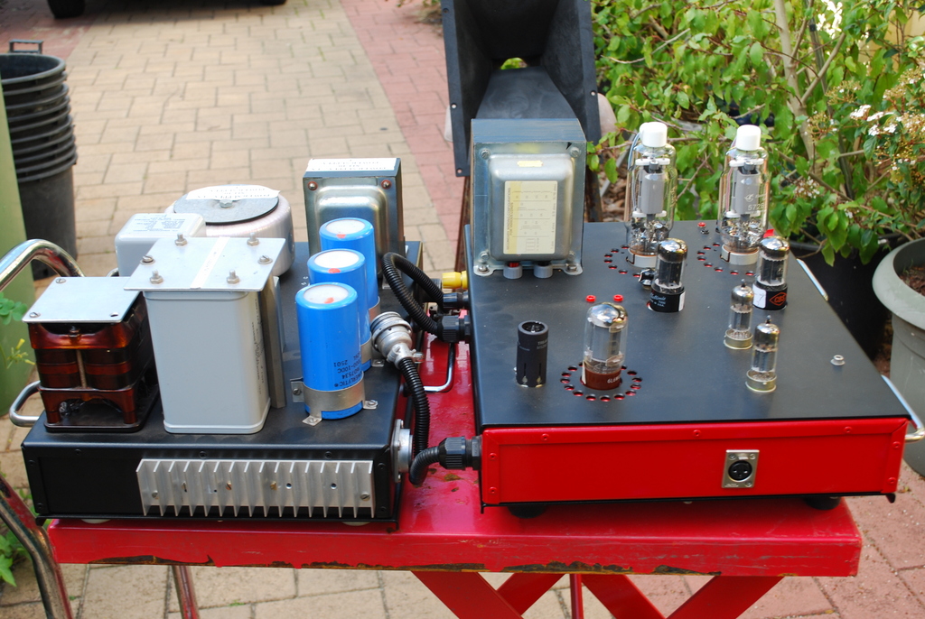

Does this layout look OK?
Or, is that transformer bundle too tight? They managed to get "bigger" when I put them on the chassis🙂
I guess I could use as mall transformer backwards off the filament winding and rectify that for the G2 supply.

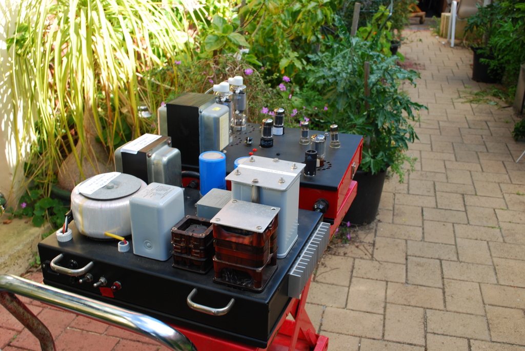

Or this? It's an old SAE amp that works, but I have no use for. Easy to guy, and repurpose upside down so the bottom is removable.
This would have shared G2 and bias supplies, but separate filament and plate supplies.
It's a big chassis with a bit of real estate, but not very tall.
The transformers need some room around them for magnetic isolation and for air cooling. You don't want the tubes too close to them either. Might get away with the smaller chassis if the three big xfmrs were along the long edge with the small xfmr stuck underneath, and then the tubes lined up along the other long chassis edge. Will still be tight though probably. Room for electrolytic or oil caps? Inductor? Power line filter? Fuse? Knobs, connectors.
Power transformers can often be right next to each other with minimal interaction. If the stray fields from one power transformer induce a few mV of hum voltage into a neighboring power transformer, who will notice.
The OPT however is a different matter, those few mV go directly to your speakers, they do not pass GO, nor go to Jail! Even crappy speakers will hum.
The only true way to test for hum is to power up all the PT's and connect the OPT secondary to a speaker or scope. Ideally the PT's should have some load, at least tube heaters. The hum will be worse case with the OPT primary unconnected. Move all the transformers around to minimize coupled noise and hum into the OPT. Usually mounting the OPT at a right angle to the power transformers is best, but you have one horizontal mount PT. They can be a wild card.

Of the transformers in this image, the power transformers are both identical. Just one has the end bells off in the image. Both have two 7A 6.3v windings, and a 250V winding at some stupid current. Each one ran 8 x 8417s in fixed bias for 200W. Bogen claimed his power transformers to be rated at 100% duty cycle. These were from industrial amplifier/modulator duty, so they are probably pretty tough.
I can always pull the bias the way he did with a backward diode and voltage divider, but isn't it best for the bias to hold steady even under extremes?
The other two transformers were just the auxiliary transformer to get bias and G2 voltage and a choke for a choke regulated G2 supply. I can use something like this to regulate G2 and tuck it under the chassis.
