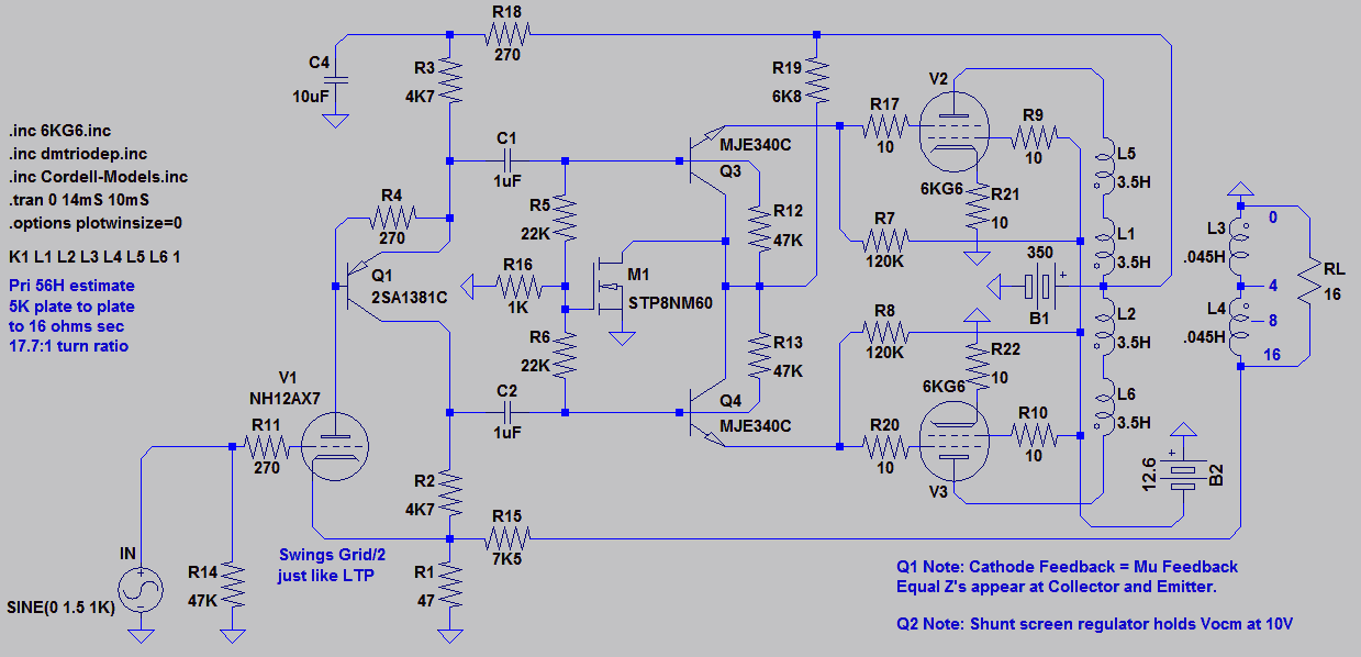

I give up and go with followers like everyone else.
Makes coupling cap sizes much more reasonable.
Also makes my Vocm regulator and EqualZ split
pointless features that don't serve any real need.
Ignore that for now...
My point this post is regarding a positive bias on
G2 and a negative bias on G1 at all times, avoids
0 crossing where the current suddenly changes.
-12.6V G1 just barely works for this tetrode at
350V Plate. G2 swings low enough to almost cut
off the BJTs. Even if I push it harder and do go
a little negative, the tetrode cuts off first, so
that's maybe not a huge problem...
Even with extremely well regulated common mode
screen voltages, cathode quiescent seems very
sensitive to small variations of plate voltage. Is
that a normal consequence of this tetrode type?
I thought if the screen was sensitive, that made
the plate less sensitive. What am I missing???
Q2 Note: Q2 doesn't exist, try M1.
M1 holds Vocm (at G2's) at +64.5V

Rp was nominally 8K according to the datasheet.
As long as G1 and G2 are held steady, I would
expect that 8K means 8k slope looking into the
plate regardless of how its strapped to be driven.
But maybe that's not what 8K means...
And messin with winding ratios in the sim, it
still seems to favor 5K plate to plate, go figure...

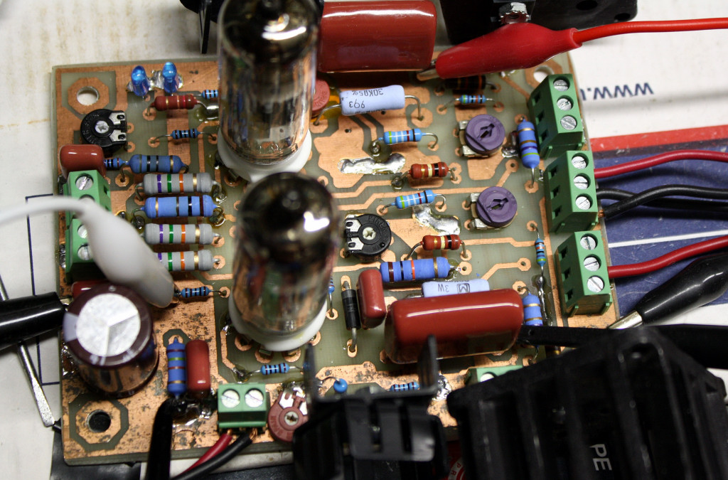

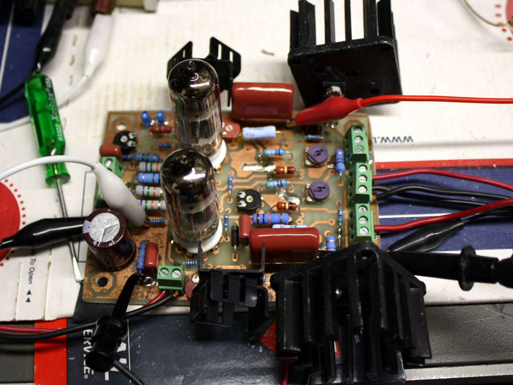

I have been slowly wiring things up in my spare time, and had started wiring one of Pete's red driver boards up to an octal output board to melt some 6CB5's since that's where I was going when I put things on hold to deal with the warehouse closing....about a year ago.
Since driving 6CB5's in G1 drive mode is no longer relevant I put the red board aside and finished up my new driver board. It was designed for screen drive, cathode followers, and just about anything else.

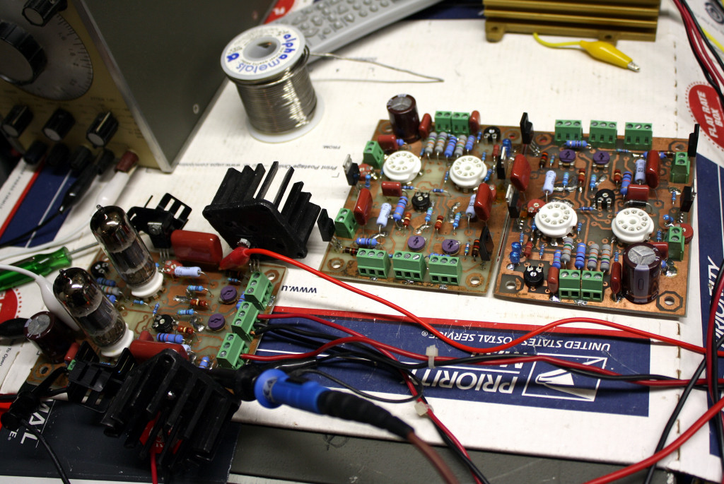

I made 3 boards, one to blow up and two to put in an amp that I am making. Last night I succesfully made smoke come out of board #1. In the process I made about 250 V P-P of drive (just starting to clip), and this was from a 450 volt supply. The plan is to run the driver tube plates from the 650 volt supply for the output tubes. That should allow for 400V P-P of clean drive. The upper 3db point is 450 KHz at 200V out.
The board uses two triode - pentode tubes in the 9DX pinout. There are 21 different tubes that will plug into this board. I have only tried one type. The two triodes are wired as an LTP with a CCS in the tail. They are direct coupled to the pentodes, also an LTP with a CCS in the tail. The pentodes outputs are AC coupled to mosfet source followers with 4 amp capability. Some screen grids are going to DIE!
I previously stated that I would start a new thread when I flip the switch on the 1KW plate supply. I am not there yet, so I am posting here. I will do a bit more testing on the driver boards before connecting up some output tubes and really making something glow!

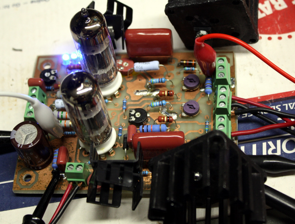

During testing I kept smelling something getting very hot. None of the semiconductors or big resistors were overheating, and there was no smoke......Until...... notice the blue 2 watt resistor in the upper right near the black trimmer pot. Can you tell what the color bands are? It was a 24K resistor. Due to some blonde arithmetic that 2 watt resistor was dissipating 9 watts. It finally started smoking and the board quit working, after over 1 hour. I think it's dead now! The 10K 3 watt resistor below it (in the row of 75K's) doesn't look so good either.
There are 4 pictures. The new board, a closer look, 3 of the boards, and a scope plot of 250 V P-P.

I haven't given up or cancelled the project. I just got different iron
Sorry, I saw something in one of the threads, maybe the Lundahl thread about a quad of KT88's.
2.5K is closer to the 3.3K that i have been experimenting with. It may be OK, depending on your B+ and power output requirements. I have smelled the smoke of burnt parts, so I expect to find a bit more time to play with this stuff in the near future. I have some 2.5K OPT's, maybe I will test some 6CB5's. It all depends on how things go in the fried stuff depertment.
I will swap out the two toasted resistors with different values tonight and retest. I expect a few more days of optimizing the first driver board, then modifying and testing the other two boards. Then I want to test the pair of octal driver boards that haven't seen power in several years. They should work. I have one of Pete's little red boards that works, and another that is built but untested. I have 3 dual tube turret boards from AES to use for output tubes. 9 pin novar, octal and 12 pin compactron sockets can be swapped into them.
After all that stuff works I plan to play musical boards and tubes to see just what works well together. I can easilly test 1250, 1650, 2500, 3300, 5000, and 6600 ohm loads with minimal difficulty at 200+ watt power levels.
I made a few charts of just how to wire tube sockets for maximum swappability. With proper wiring there are 11 different tubes that can be plugged into the same socket as the 6CB5. I have 7 of them, so that configuration is pretty high on the list. I figured out how to stuff 19 different tubes into Pete's big red board just by moving two resistors around, so that combination may be first.
Tonight's first surprise was the crispy 24K resistor. It measures 23.8K which is well within spec. It had unsoldered itself from the PC board. The not quite as crispy 10 K resistor was also good.

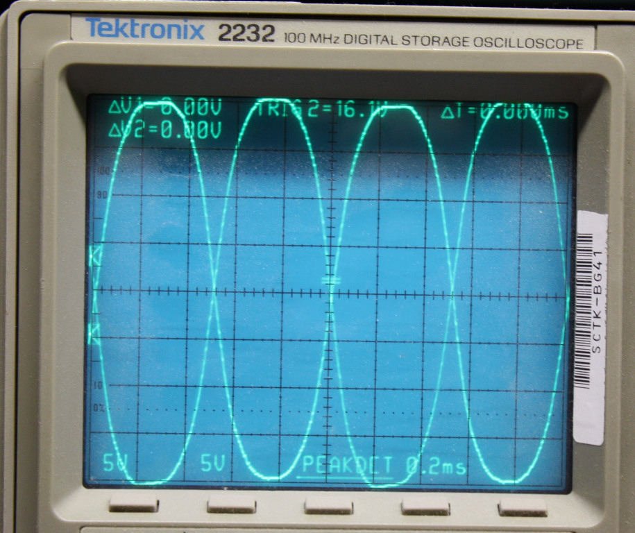

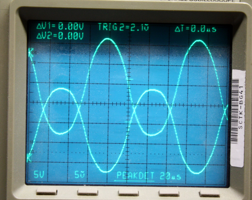

I changed a few resistor values, and now have a non-smoking board. To verify this, I switched on Kaptain Killowatt, and fed the board 650 volts, maximum output from the power supply. The board has been cranking out 400 volts P-P for about 2 hours. As set up the output swings from -50 volts to +350 volts. This is limited by the -80 and +350 volt supplies that feed the board....and the output mosfet.
I have swapped in 4 different types of tubes from the 21 possibilities. I tried a tube with a triode Mu of 18 and pentode Gm of 9000, as well as a tube with a triode Mu of 47 and pentode Gm of 23000. All work with minor trimpot adjustment.
There is too much gain, and the offset drifts as the board heats up, but these issues can wait until I melt some sweep tubes. I need to test out some local feedback ideas that will eat up some of the excess gain.
