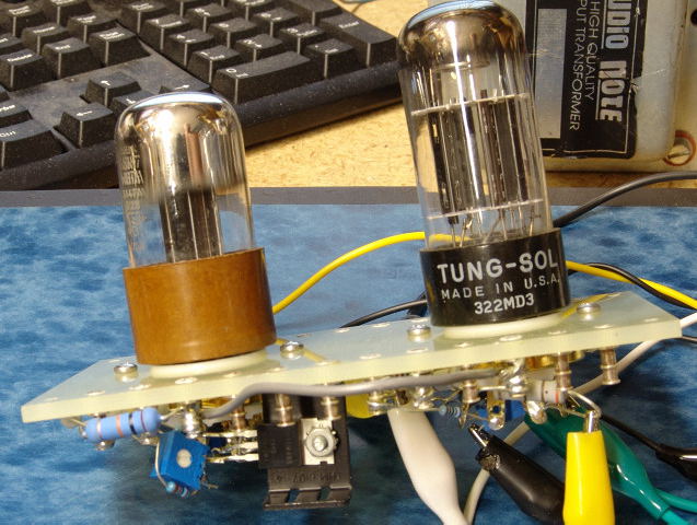

I put together a design using the big red board, some $5 tubes, and a couple of $20 Ebay transformers that put out a reliable 125 WPC. I built one and so did about a dozen others. Mine still kicks and has survived several sessions at full volume for multiple hours at a time. I can turn it up, open the windows, and go outside to mow my lawn......without hearing the lawnmower. Nothing in the amp gets overly hot. A picture of the "FlameThrower 250" is included....it has not lived up to its name despite the undersized OPT's that hit saturation causing massive current spikes in the output tubes. Full details of all the experiments are in the big red board thread. Lots of good stuff about sweep tubes in G1 drive too.
Pete's smaller red driver board solves the only problem I have with the big red board......not enough gain. Big red was designed for 18 WPC. It has plenty of gain for that. I get 125 WPC which is nearly 10 db louder, so I need 10 db more gain. Swapping input tubes and plate load resistors gets me a few more db, but I really need another stage. Pete's driver board has that extra stage, and the red boards seen in the picture will be tested in this amp.
I took one of these boards when I first got it, put 6HB6's in it (a great $1 tube that plugs right into this board) and got 7 watts from the board alone in Class A pentode! (picture enclosed) There are no mosfets for driving screen grids, but I have a mosfet buffer board somewhere.....If I can't find it, I'll make another.

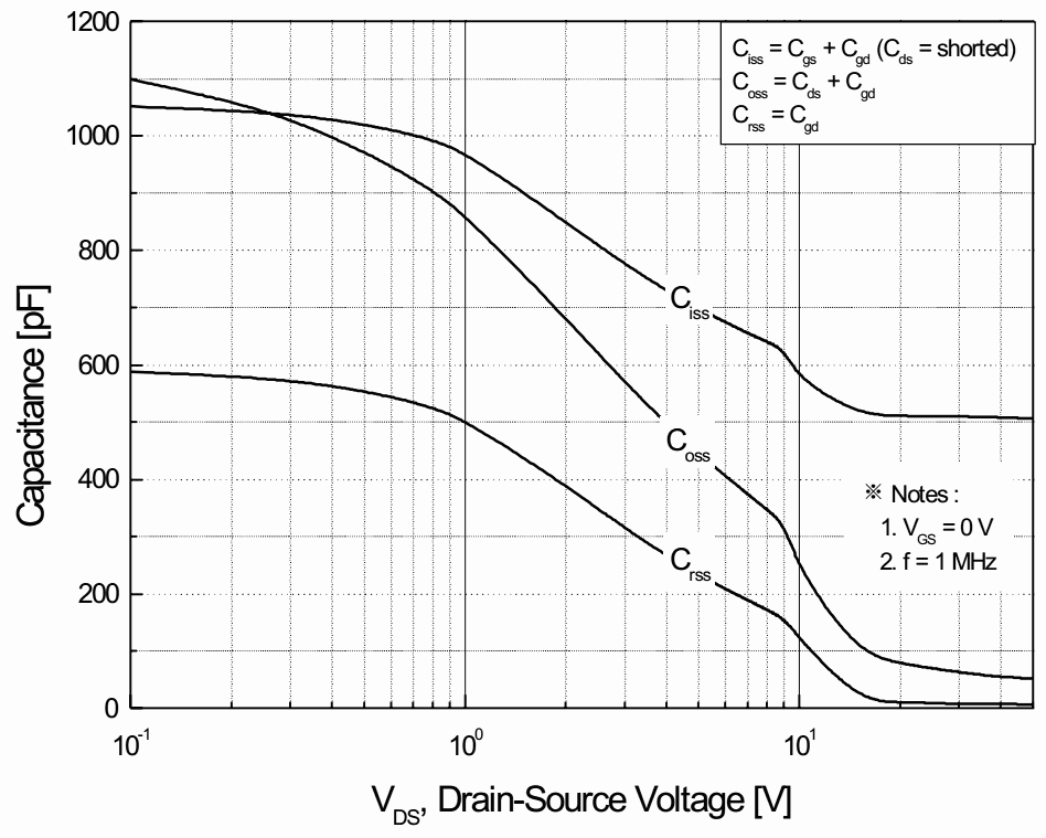

The input capacitance can range from 100 pF to 5000 pF in a mosfet. This is the capacitance from gate to source. In a common source amp this capacitance must be driven directly by the previous stage. In a follower the source follows the gate. This means that the effective input capacitance is mostly neutralized. It is effectively reduced by 1-the stage voltage gain. Here, having the output accurately track the input reduces capacitance related effects. High Gm is important.
The output capacitance is in parallel with the output in both common source and source follower configuration. This capacitance must be fed by the current flowing through the mosfet. Again, high Gm at the operating current is what's needed.
The reverse transfer capacitance is the capacitance from gate to drain. The drain operates at AC ground in a follower, so this capacitance is in parallelwith the input and must be driven by the previous stage. In our applications this is the plate of the driver tube. This is why we want this capacitance low, and relatively constant in the range of voltages the fet will see at full power output. This is the voltage across the fet as it is driven through its entire signal swing. It become obvious that the higher the drive requirements are, the greater the voltage swing across the fet are. We want to keep the minimum voltage across fet above the point where the Crss begins to increase. About 20 to 100 volts with most fets.
So we are looking for a fet with a low but constant Crss in the voltage range where it will be used. A high Gm is needed, but this is usually the case with most fets, and why many tubes fall short as cathode followers. Of course the voltage, power, and current requirements must be satisfied. If the amp will see repeated clipping, like a guitar amp, allow ample(2 to 3X) headroom for these ratings...especially voltage. Avoid excessively large fets because their Gm may drop at low currents, and the capacitance may be high.

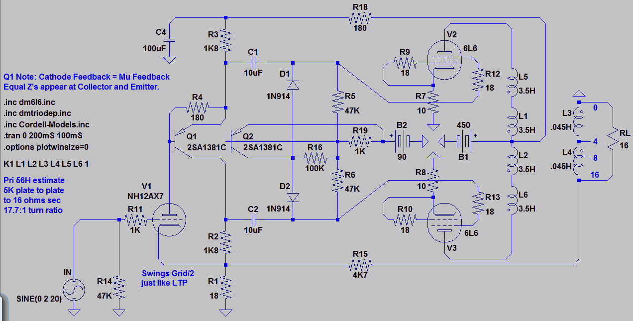

i would like to try a mullard 5-20 using a 6688 pentode and a couple 6S4 triodes at B+ of about 600 volts for large output swings...
I was playin' sims with an equal Z concertina and deblocker in AB2.
everything seems cool in G1 drive (to +20V AB2), so lets go crazy!
Just took a lame stab to see what would happen if we re-bias Vocm
for screen drive. 90Vocm gives about 40mA quiescent per Tetrode.
Meaning of Vocm explained: Fully Differential Op Amps Made Easy
http://www.ti.com.cn/cn/lit/an/sloa099/sloa099.pdf
In G2 drive: Looks like Concertina runs out of headroom before the
output reaches full swing. Just not gonna work without more Volts.
I mean, it works fine, just half the output swing I had before in G1.
In G1=G2 drive: Volt headroom isn't the problem. Concertina runs
shy of current to drive the grids and work against the de-blocker to
re-charge caps in the cutoff half-cycle. Q1 already stressed above
limits in this drawing. 67mA concertina quiescent is not enough.
I tried offsetting G2 some volts above G1, but still not found any
configuration thats reasonable for a de-blocked concertina drive
except G1 AB2 UL , what I stated with...
Maybe someone else can figure a better use for these new ideas?

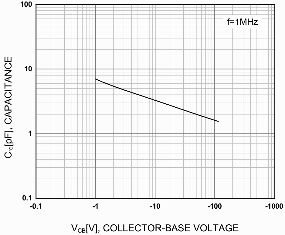

Got nothing whatsoever to do with current.
About leaving 20V on the drain at all times.
2pF Miller shoots up to 600pF over last 20V!
That and no need for gate protecion is why I
chose the "inferior" BJT in the second clip.
If I was assured of 20V to spare, I probably
woulda gone with the MOSFET and a zenier...

Well, technially not Miller, since there is no voltage gain, but the input capacitance can go wild and more important CHANGES with applied voltage, if there is not enough voltage across the fet. This is one of the main arguments in the SS VS tubes debate (PIM caused by VVC effects) but do you know that a tube exhibits the same (albeit much weaker) effect due to the varying size of the space charge cloud with applied negative grid voltage?
A BJT does work, and I have used them. In some circuits they MAY appear to sound better....but second breakdown and SOA requirements cause them to rapidly turn back to sand when the Big Dumb Blonde One plugs in his guitar and cuts loose. When the BJT or mosfet shorts, the collector (drain) supply gets connected directly to the grid of your tube, and...it really doesn't like this!

I have set up my breadboard so that I can explore the effects of mosfet drive VS conventional RC coupling to the output tubes by swapping out the driver boards leaving the rest of the amp the same. I have a pair of Pete's driver boards set up so that they can deliver 7 watts of power if connected directly to an OPT. That is plenty of drive, it's just RC coupled. They will be compared against other driver boards, and maybe even the same driver boards with an external mosfet board if time permits.

Either BJT could breakdown and would not short the supply to any grid.
Even if shunt regulator Q2 fails open collector: Resistors limit screen to
35V@5.2mA=0.18W. Each 6KG6 plate dissipates 65W in this failure
mode, and even less (about 44W) if there is a music signal present.
