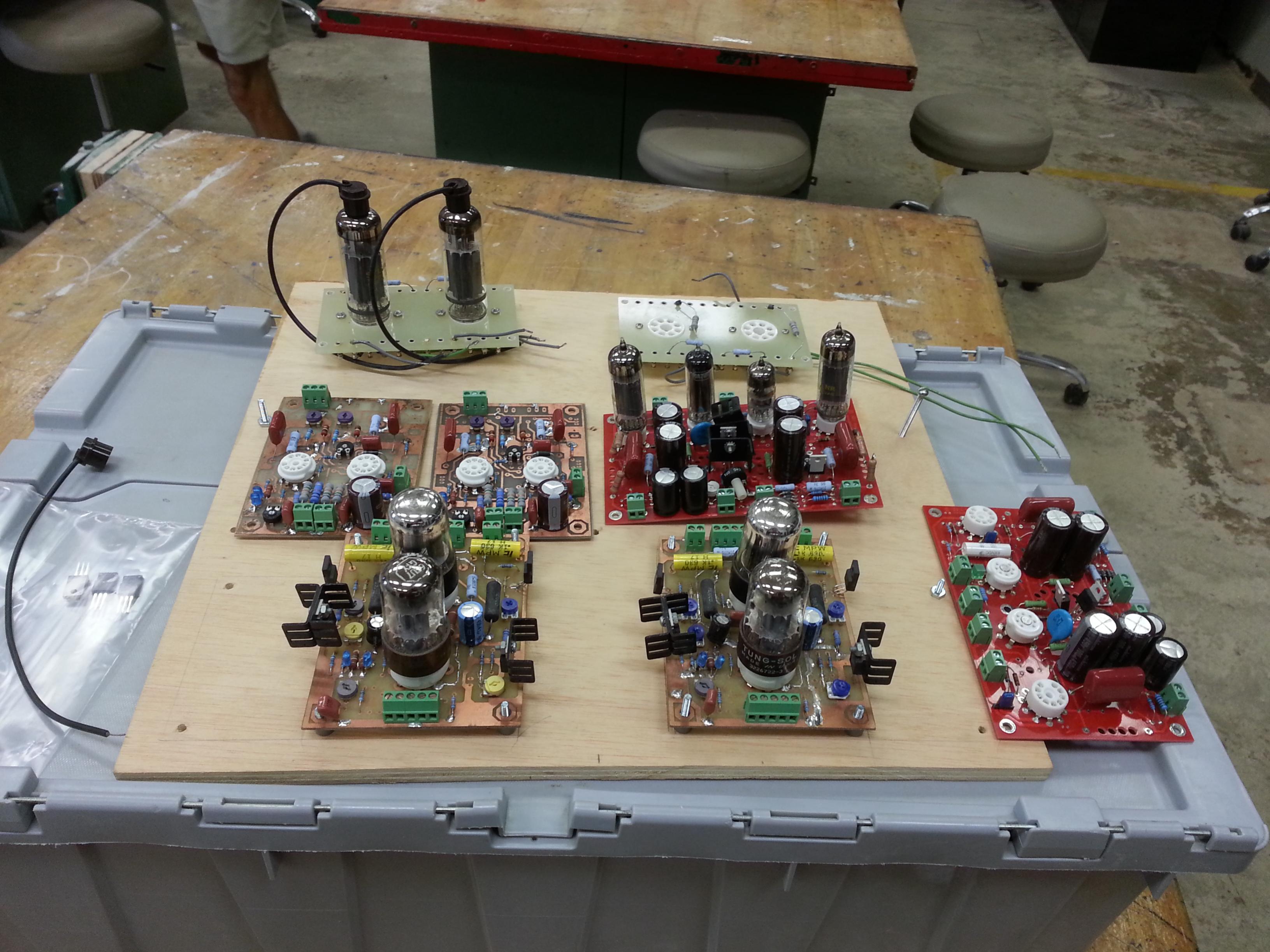

I was typing my last post while sitting in my car waiting for my weekly wood shop class, so I messed up some of the typing. I get 3 hours away from the real world a week to play with tools that can cut body parts off......quickly. Tonight I made a 4 X 8 sheet of plywood into the components for 3 speaker cabinets, and two amp heads, all guitar amp stuff.
I also had my latest bread board with me because I was going to make heat sink brackets for the mosfets if I couldn't get the table saw, but I got there first! I set the breadboard on the work table and took a phone camera picture. This is what I will be using for all amp experiments in the near future. It is simply a piece of plywood with holes drilled to mount a pair of driver boards (there are 3 sets to choose from), a pair of output boards and a pair of OPT's. All power comes from bench power supplies. The output boards are turret boards from AES, the octal board will also fit Novar (shown with 13GB5's) and 12 pin compactron sockets. I have a set for nine pin Noval (EL84) tubes.
You will see a pair of red boards, these are Petes P-P driver boards. Excellent driver boards, but no mosfets for screen drive:
http://www.diyaudio.com/forums/tube...push-pull-driver-pcb.html?highlight=6l6gc+ab2
There is a pair of boards with two octal tubes on each board. They are currently mounted in the driver seat. These boards were designed for during this thread and the entire design was laid out for all to see and follow along. The schematic can be found in that thread, Screen drive and sweep tubes were not the focus of this design, but it can handle it just fine. I think I had to make a minor change in the mosfet circuit
http://www.diyaudio.com/forums/tubes-valves/133034-6l6gc-ab2-amp.html?highlight=6l6gc+ab2
There are also a pair of unfinished boards with two 9 pin sockets each. They can use any tube with a 9DX base connection. These are triode pentode pairs. There is about 20 different type numbers with identical pinouts. I intend to test them all.
Well now, that 6l6 thread will take a few minutes to read through. Pete needs no introduction for me. He's the wild man with the Hawaiian shirt that lives down the street from me.
His red board is fairly large, hence the "Big red board" title🙂 he has another board with just the driver topology on it that is much smaller.
I am not opposed to point to point wiring, and have not found anything for screen drive which is what I want to try. I think I am going to try a lower B+ for initial testing, and go from there. The 2SK2700 looks like a decent candidate for your schematic that was posted in the first page of this thread. I am planning to tinker around with the driver tube. For some reason I'm pretty bent on the 6GF7A as the driver tube.
Also contemplating a transformer based phase inverter because I've never done it either.
