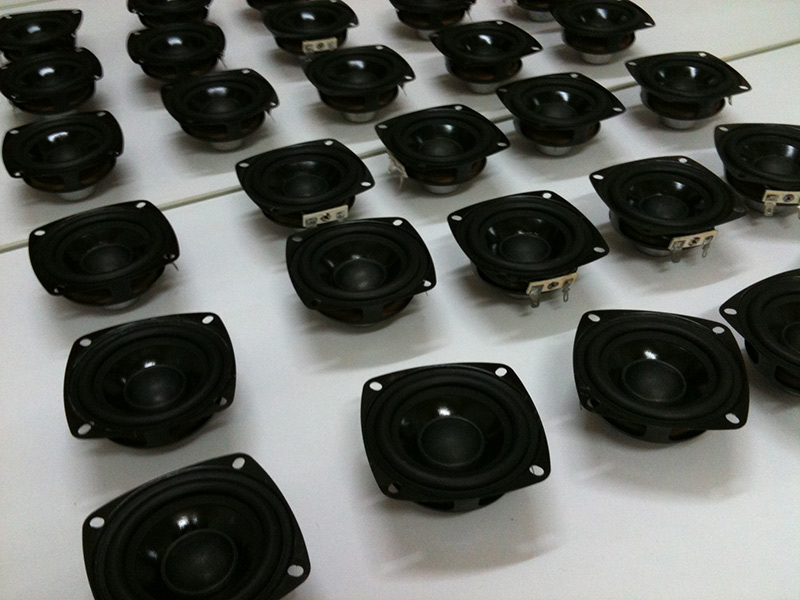

Testing drivers for faulty units... all good so far!
I need to do the same with mine but isnt it fun spreading them all out on the table??
Small driver but in quantity it certainly add up in size! 😀

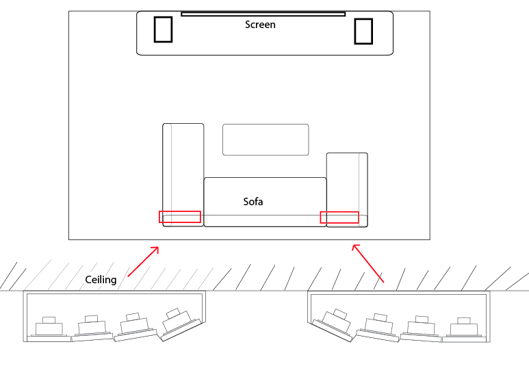

My sofa (listening/watching position) is very close to the back wall, but I can't use it to mount the back surrounds. So, I have a set on the ceiling now. I am thinking of using a combination of 4 drivers (wired 2-2) fanned out towards the center of the sofa.
Here's a quick drawing of it:

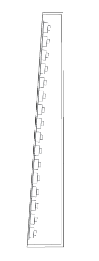

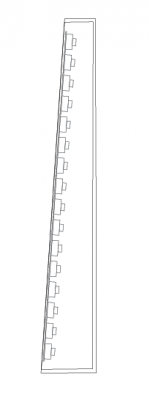

For now, since I only have 16 drivers per array, what if I went with an inclined baffle? Trying to widen the listening area a bit. Would that work?
I'll do a test box with the cheap drivers, probably sell them to cover the price of the Vifas... he he!

An inclined arrangement will change the reflection pattern from the line array reducing the "true line array" radiation effect. So it all depends on where you want to go with this 🙂 An inclined baffle looks good though 😀

As far as widening the sweet spot I'd play with toe-in to the opposite far seat before an inclined baffle... consider the floor reflection of that setup.

The array will not be placed on the floor, but on a shelf (see that pic from the first page). I thought about the inclined baffle as a mean to widen the vertical spread. From listening to my test box with 9 drivers, I have to be within the column of drivers to hear the full spectrum... as soon as my head goes over the last driver, I loose all high frequencies. Listening in the sweet spot is nice, but walking around the room, not so...
Still, 16 drivers may be enough to not require an inclined baffle.
Since you guys seem to think it is a bad idea, I'll forget about it.
