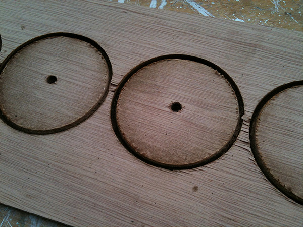

I measured the first baffle, calculated and marked all my center-to-center points, then, I decided to clamp the 2 baffles together and drill my pilot holes in both baffles at the same time.
Hmmm, I guess my drill was not perfectly straight, as the bottom baffle got the center-to-center pilot holes all over the place. Well, not all of them, but some of them.. I realised that after the 4th hole, noticing that the space between the holes was not the same...
So, lesson learned, don't try to cut the work with shortcuts... it will usually take me double the time, and twice the money!
Also, the plywood I have here, they put a thin layer of veneer on top. When drilling the holes, the veneer sheared away a little in between the holes. I will have to work some more to create a smooth surface. I don't care about the veneer, as I was going for black baffles anyway.

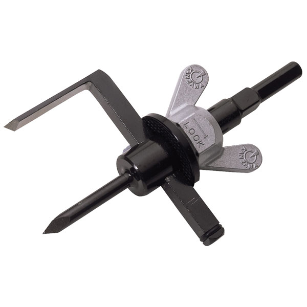

looks like your using a hole saw type drill bit without a drill press that can be a wrist killer not to mention the problems with perpendicular alignment considering the number of holes wouldn't a template and router or roto tool not be better? as a half way compromise (because drill presses are expensive) mini press stands that allow you to mount a typical 3/8 or 1/2 hand drill like black & decker used to make might help. from the look of the pic it seems your heating the wood with the hole saw.
I first pre-drilled the center-center holes using a 1,5mm wood drill bit, then used a 3mm wood drill bit. This made the 5-6mm bit on my hole saw to track with adequate precision 🙂
Without atleast a smaller pre-drilled hole the larger hole saw bit will wander a little before it settle down/starts to dig in.
As far as the veneer goes use the hole saw from both sides as when you push through some material will always pry off. Good to see progress Perceval, keep it up! 😉

This is the tool I have at the moment. It is hard on the wrist indeed.
I cut half way one side, then flip the board and finish cutting the other side.
It does burn the wood a bit. Not exactly easy, but I don't have a drill press, and I have no idea how to make such a small hole with a router and jig.
