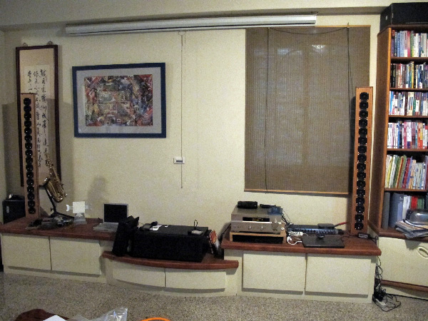

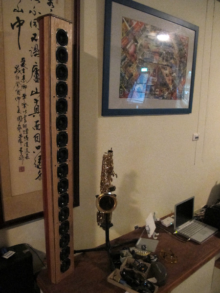

I'm waiting on a place that is cutting 2 pieces of green marble for the bases.
Couldn't wait, so I hooked them up.
2 things jumped right up!
The imaging got huge. I was listening to my old speakers, then hooked the towers and ... bam! Everything expanded. I also get that "headphones" effect that was described about arrays.
The transients are crisp! Right after the imaging, that's the thing that I noticed. I can hear the pick hitting the guitar strings, the beater hitting the bass drum. Very nice!
So, will have to finish the bases, and when the arrays have been run in for a while, I'll start tweaking EQ.
But so far.... there's a big grin on my face!

Thanks. I still have things to do, and hours of listening, but I'm very happy my initial reaction was good. There is life in those towers.
Wesayso is waiting on a friend to cut his alu baffles. I'm sure he will pick it up again. My towers are nowhere near his in terms of involvement and shear beauty, but I am not as patient as him either, I think. 🙂
I'm sorry I haven't taken so many pictures. My working space is very limited, and I have to share. So, whenever I could, I had to bring all my stuff out, work on the arrays, then clean everything up and store away my tools before we needed the space. It was a race every time, so I forgot to take pictures...
I'll take better pictures later. If I find the time to stop the music and unhook them! 🙂

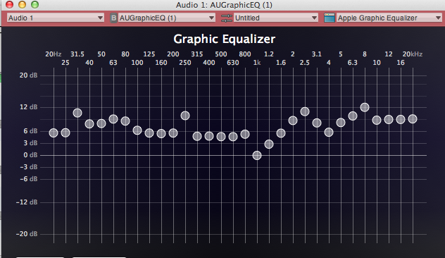

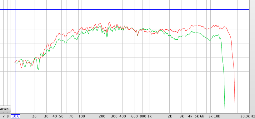

Been working the drivers for a while now, so I gave a shot at some EQing.
I tried, but these are no VIFAs, so they won't go much below 100Hz. Trying to boost anything too much between 60 and 120Hz rattles the drivers and distorts everything badly. Plus, they drop quite rapidly at around 15KHz, but since my ears are not that good anymore, I doubt I will notice. Next will be to integrate a sub (or subs) into the mix. Plus, I will adjust the EQ to my taste as well.
Here is a freq sweep I did, in green without EQ, red with my attempt at EQ. I also recorded (with the usual flaws that it could bring up) some songs I heard around and people like to listen while auditioning speakers.... plus some of my own! 🙂 I'll put a link to SoundCloud as well.
https://soundcloud.com/perceval-1/arrays-with-eq-to-flat
