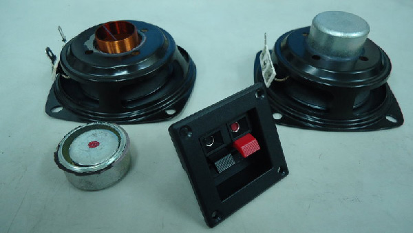

This is a picture of inside the $3 neo driver.

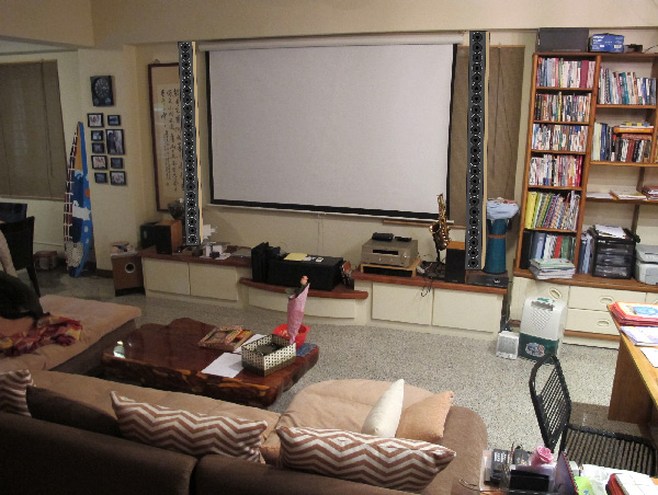

Ok, if going to the $3 driver, then I will work hard to get 25-driver towers a reality.
Need to get them spouse approved, as she already thinks I own much of the space in the house! Music, surfing, drumming,... all stuff that takes a lot of space! Of the three, she enjoys surfing too, so that one is easy. The other two take more work...
If I follow Overkill's designs and make a shallow enclosure (say 3.5" / 9cm deep) and hung it on the wall, I think it would have the best chance at reaching high approval rates.

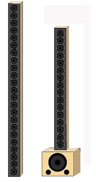

Been also considering a 16-driver tower, combined with a 10" base.

Can you get any kind of spec for the cheaper driver? If the xmax is less, even having more of them could result in less output and/or LF making it more difficult to get the sub to match.
Despite the trend for narrow cabinets, wider, shallower cabinets can work well if you keep the same volume behind the driver. They work especially well up against a wall as Overkill says, at least in my experience.

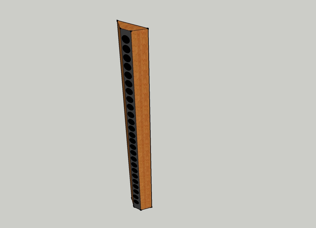

Playing with some design ideas.... really don't know what I am doing here besides trying to come up with designs that will look pleasing to the eyes (mostly my spouse's) and what I think would act well sonic wise.
This is a quick and dirty Sketchup model (I used to work with FormZ in the days,.. I liked it a lot... can't say the same thing about Sketchup...) that would be mounted on the wall, acting like an infinite baffle. Wondering if it is a viable option. And should I use drivers back mounted (like the Two Towers, providing a small "horn") or front mounted (like Overkill's BMR towers).
