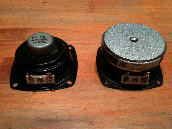

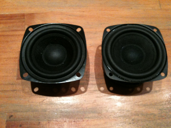

Found another 3" driver locally. No specs besides it is 8 Ohms, and handles 15W.
Got a couple sent to test.
It's not as airy as the first one, but it handles frequency a hair better. It doesn't break down all over when pushed like the first one I got. Soundwise, it's not great, but it's not complete crap either.
Very different construction... and some of the same too.
First one was a beast at 375g a driver. This new one... a mere 85g! Also a lot easier to install on the baffle surely.
Best thing about it... it costs $3 a driver! Dirt cheap, but obviously of lower quality. Still, I am tempted to get 30 more (that'd be $100 for a set of 16 drivers each, that's hard to beat!) and finish what I started... and keep the other 2 arrays at 9 drivers each and use them as surrounds.
Here it is compared to the original I got:

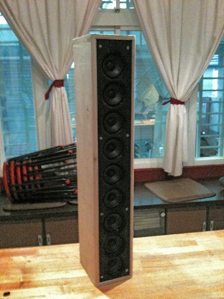

Test box 1 is complete.
I have no resources here. I have never heard an array. There are so many things I have to learn. Yet, I have always loved music making, and music reproduction... so this is something I wanted to do for a long time.
A long time ago, I got the bug for good music, good movie sound, etc... and I never had the money to indulge myself into outrageous setups... by choice. I have many hobbies and like to keep busy. There's always something new and interesting around the corner. But music has always been there. So, DIYing seemed to be the best approach to getting close to what I dreamed of.
You know, people can tell you things, but when it comes to feelings, I always thought it was best experienced first hand.
So, when you guys told me 6 drivers is not an array, I believed you, but I still needed to try. I got this 9 drivers small array done. Hooked it up. Now I know. Sitting in the sweet spot (right in the middle of the "tower"), it sounds amazing. Stand up and walk away, and the magic is gone. I now can imagine what a 25-driver array sounds like. Must be amazing. I now know why short arrays have short-comings. I got a taste. Still, in this case... as long as I keep the frequencies above 150Hz, it sounds really good. So I used my subs to cover anything under.
I can now hear the "lacking" of my MP3 files, and would love to have more flac files in my libraries.... or a turntable!
At this point, I don't know if I am going to continue expanding to 16 drivers into my "short" array. I can hear why you need 25 or more. And I am not sure it is an option for me.... the wife might not let me populate the living room with a couple of imposing towers.
I would love to, though!
So, one more step onto the path of sound nirvana... will never come close, but can always aspire to reach...
