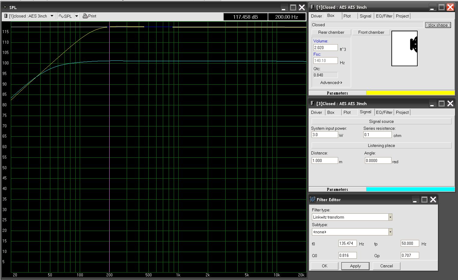

Winlsd seems to only like a sealed configuration for your driver with the data from the sheet that you posted.
A cabinet volume of 1.5 to 3.0 cubic feet is good.
The program just kicks out the data for a vented alignment and shows no real benefit for a ported system.
In the screenshot that I have included, I have set the power levels for an Xmax of 3mm at 30Hz with a box volume of 2.020 cubic feet.
The power level set for the Blue SPL curve is 3.0 watts for a SPL of 101.16db.
This includes a linkwitz filter as shown that is calculated by the program.
Except, I did change the low frequency setting to 50Hz instead of the normal 20Hz as the drivers excursion just shoots through the roof at 20Hz.
The power level for the Yellow curve is set at 123.4 watts for the same conditions but without the Linkwitz filter for an SPL of 117.458db at 200Hz.
This is only 7.7125watts per driver. 😉
It will be a pretty impressive system with all 32 drivers using only a 50 to 120 watt per channel amplifier!!! 🙂
The curves do suggest to use a separate subwoofer with the system.
Although, You may just get all of the sound you will need on a few watts using a linkwitz transform filter.

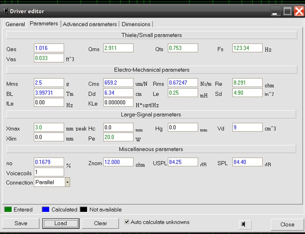

Here is the data I used to create the model.
I have also included the file in a ZIP so that you can just add it to your Winlsd drivers folder.
Since Winlsd checks all of the parameter the only one I changed was the Qes by erasing it and letting Winlsd to recalculate it or else it won't let you save the file.
I can't tell how to go about using the digital stuff but implementing the filter with a single dual (or quad) opamp would be by far the cheapest method to use.
I am in the process of designing a preamp and active crossover design for my Desktop ESL system and it requires such a filter.
I am think about implementing the filter with a boost and cut function so that I can adjust the level of low end boost with the overall power level.
The Higher the power level the lower the low end boost will be to keep the high excursions at frequency's lower than 40Hz or 50Hz under control for my 5.25" woofer.
jer 🙂
