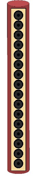

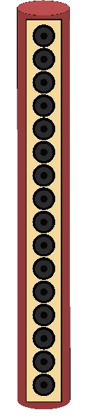

A line array in a pipe could be a great idea IMO.
One of the things to look out for with this idea is allowing the driver diaphram to get too close to the center of the pipe where it would be very resonant. If you cut a big section out of the pipe for the driver mount plate, Since the plate is flat, the center of it will be closer to the center of the pipe. If you then rear mount the drivers because you're worried about the tiny vents on the back side of the drivers not breathing well enough, now the diaphrams are even closer to the center of the pipe where it would ring like a bell.
I'd use a pipe that was a bit larger diameter, maybe 8 inch diameter and use Vifa TC9 or Peerless TG9 three inch drivers instead. These drivers are relatively cheap, and have all the features that you want for a high end line array.
If the drivers are big enough and have a reasonable Xmax spec, such that you can take them down to at least 80 - 100HZ, you may get significantly less of the typical boominess due to room resonances. This is because of the fact that the lower mid energy will be emitted spread out not just left to right, but up and down as well. Reflection cancellations from each driver, will be largely filled in by the other drivers which will each have a slightly different cancellation frequency due to floor and ceiling bounce, relative to where the listener sits. Most rooms I've measured have problems in the 80HZ - 300HZ area, causing that irritating boominess. If you can fix that, you'll want to turn the bass way up and bath in it.
Roger Russel runs his $19000 line arrays (which I believe use the Peerless TG9 drivers) all the way down to 25HZ (with active EQ) and I asked him specifically in an email if there was any boominess and he said no. "no noticable boominess". I've been wanting to build some of those ever since, but I've already got too many speakers... :-/

About the tube resonating or ringing, I thought of covering the inside with something I discovered when I waterproofed my balcony. It is a thick paint made of latex and cement. It has amazing dampening qualities. I first noticed when I dropped a couple of screws on the floor, the screws didn't make a sound, and didn't bounce either. Combine that with some bracing, and it should be pretty dampened against ringing.
Most people use polyfill inside, but I have extra rockwool from building bass traps here at home. Could I use rockwool (the heavy kind, 60kg/m) inside my speakers?
I'm designing and measuring to get my material... I'll also need to order an extra 16 drivers!

Would you guys favor a "barely-extending-the-drivers" baffle, or add a bit of extra to the sides?
Baffle size is normally a function of the XO point/slope and room gain curve, but this usually means a fairly wide one, so it usually boils down to how wide one can/will tolerate and/or how much EQ one is willing/able to use to shape its in room response.
So, your call; use as big as necessary for best overall performance to minimize the amount of EQ required or go with whatever looks 'right' in your room and/or needs to satisfy WAF considerations?

For example, was looking at the low end losses occurring with a set of widerange planars and the lower limit is ~250 due to dipole cancellation losses. To make a baffle that remains OB but corrects for this loss would make for a baffle width of ~24". This can be achieved with two 1/4" thick plywood panels elliptically arced back leaving a flush mount front and an chamfered exit on the back side total thickness 1.5". Simple arced wedges form the structure that can then be filled with sand deadening this structure. If a regular box type enclosure is to be used same, shape can be employed, just enclose the rear space with a largely unseen box. Diffraction is minimized by adding edge treatment eg roundover, semicircle arc made of PVC run down the length, etc.
For acoustic dampening of the pipe, I wouldn't use any bracing. If the diaphrams are pretty near the edge of the pipe circle, the only resonant situation should be end to end. I'd break that up with a partial shelf maybe every 4 drivers along (Russel does this every two drivers along).
I would use "Liquid Nails" glue (or equivalent), to glue thick felt (or upholstering padding) to all the inside surfaces of the pipe (1/4 inch +). Then, I'd glue 1 inch thick foam rubber over that (if the pipe is 6-8 inches diameter). Then I'd put a bunch of the looser stuffing down the middle of the tube, but not so tight that it effectively blocks the vented pole piece of the drivers.
Adding side panels or wings lessen the requirements of active EQ, but may blur imaging significantly. Using a bigger pipe (8 inch) would provide a smoother diffraction rolloff, than a 4 inch pipe with the more abrupt edge to the driver frames. If you use a non-resonant driver mounting panel that's thin enough (1/4 to 3/8 inch), then you could front mount all the drivers, which would make it WAY easier to replace a bad or blown driver, should that ever be an issue down the road.

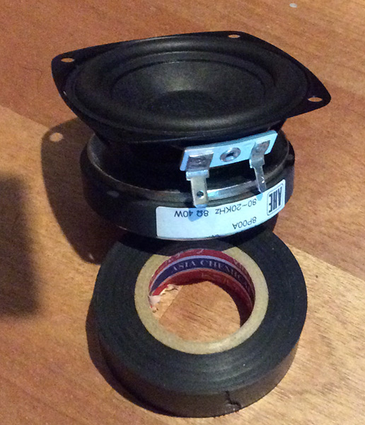

One more thing here. I'm starting to have second thoughts about the drivers I have. I've been on Youtube to try and listen to other 3" drivers and figure out if my 3" drivers can measure up, it's kinda hard.
Is there a way to test if my driver is suitable, other than building the array and finding out later? It would help to know before I shell out some more money for the extra 16 drivers on this project!

Perceval, I forget which driver you were planning to use. There's a lot to consider when you want one driver to run "wideband" (30 - 18kHZ).
Rubber suspension is a must, a vented spider and/or pole piece is a significant plus. Cavity effect can ruin an otherwise great driver when the half roll suspension sticks out too far (so they can have a higher Xmax). The shorted turn on the pole piece makes the high frequency response usable and the impedance curve flatter. A harder cone material has higher resolution, but also has uppermidrange and super sonic resonances that are very severe in many cases (always check the frequency response graphs - they should be pretty flat +/- 3dB, or at least very correctable with tone controls).
When using multiple drivers they should be mounted as close to each other as possible, so the nodal line of the interference pattern will be wider, so less annoying. You don't want drivers that have big wide mounting flanges that increase the distance between drivers. Xmax should be reasonable. The fancy new Dyminium (sp?) magnets are stronger, but the physical weight of the ceramic magnets help dampen any resonance in the driver frame better, and they're strong enough.
If an Engineer were to test a speaker driver, besides the usual frequency response test, they might use tone bursts inside a gaussian envelop, they might measure distortion products with a spectrum analyzer, they might look at a "waterfall graph" of the spectral decay.
Dispersion is important, but what's most important about it is you don't want an abrupt change in dispersion, especially in the upper-midrange, where the ear is most sensitive. You get an abrupt change in dispersion when a crossover switches you from a large diameter woofer or midrange driver to a 1 inch tweeter. The room reflections can work with that to color the sound in an unpleasant way. With small drivers you want to make sure the the vents on the back of the driver are pretty clear so that doesn't cause distortion.
Did I forget anything?

This is the 3" driver I already bought, and was planning to buy 16 more:

Here's the actual page of the 3" driver's info:
