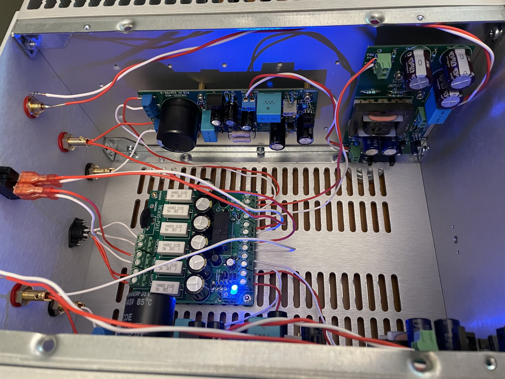

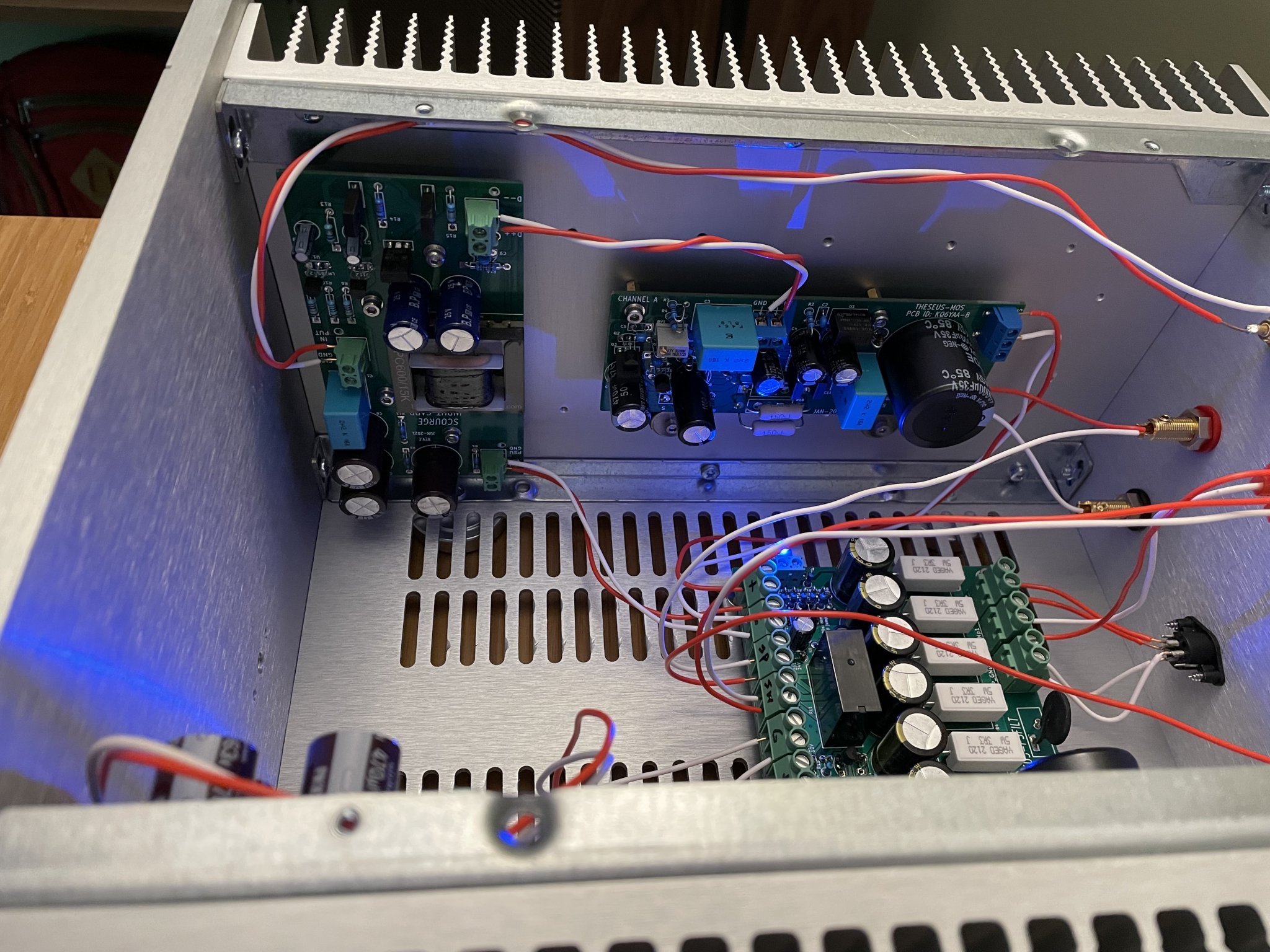

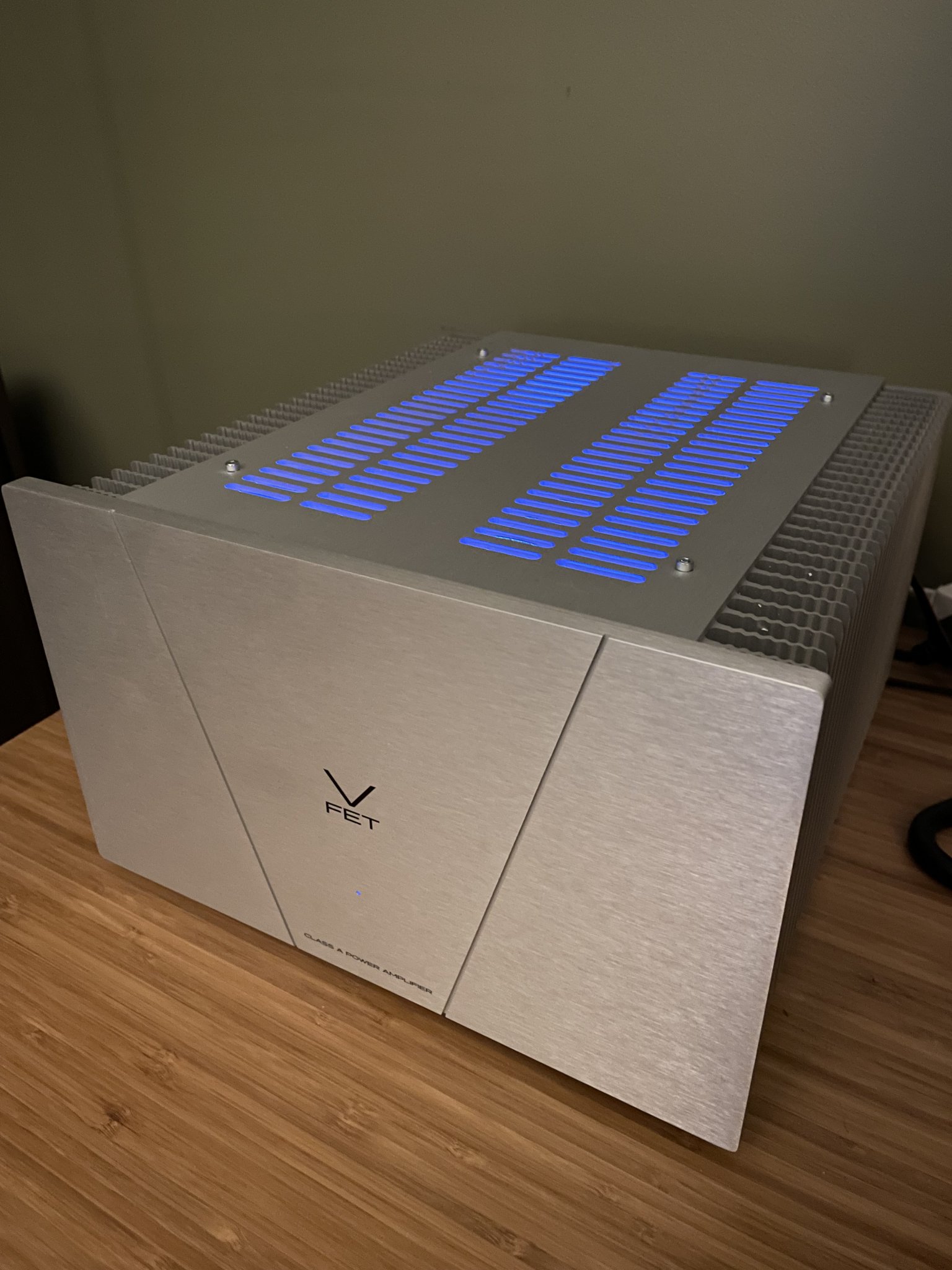

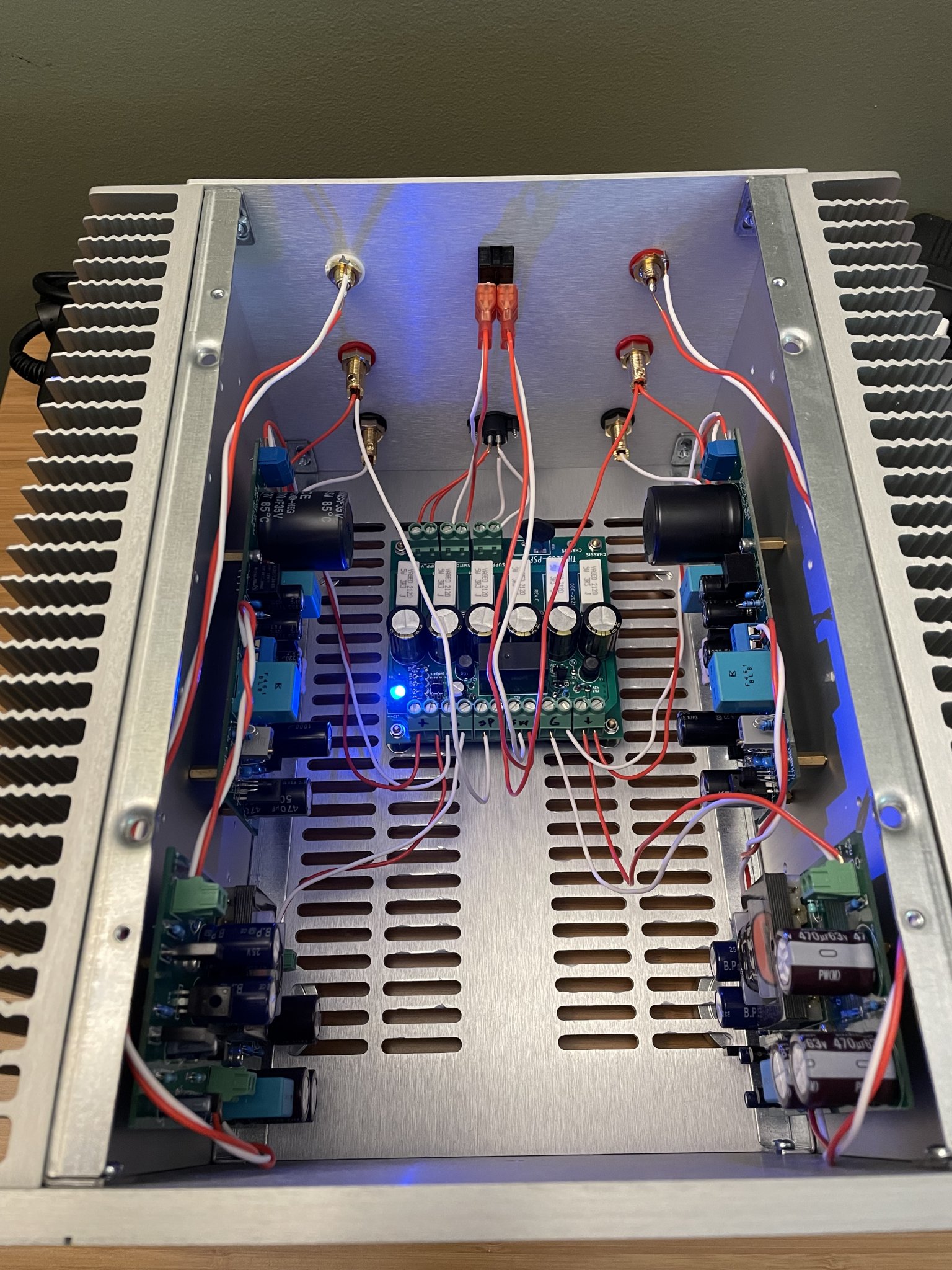

I didn’t think the V Fet cases would ship this early but since my cases arrived I figured I should get building.
I just completed my Ship of Theseus amplifier and wanted to post pictures to encourage or inspire others to do the same.
A big thanks to @Mark Johnson for so generously making all these designs freely available to us.
I currently have it running with the Scourge front end as that is the only one I have built so far. I have the boards and parts for a number of the other front ends, which I will build in time. The amp has only been running for a day or two, so I can’t say anything specific other than it sounds fantastic. I was planning to install an LED on the front panel, but seeing how cool it looks glowing from the inside I think I may keep it that way for now.
I have some extra amp and front end boards from my order that I plan to make available before too long for those who are interested in building this but don’t want to order a bunch of extra boards.
I told myself that I didn’t need the Sony version, but after hearing how good this amp sounds I am tempted to pick up some of the parts from the swap meet and build that version too.

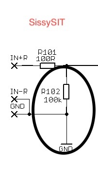

More difficult question, is there any set input impedance for the Front End boards? Why do I ask, I run a PL XP22 preamp balanced from source to amp with a 5M balanced run. 6L6 has previous suggested the best way to convert balanced to SE input signals at the amplifier level is to use a input transformer. When I was on the phone with the nice people at Cinemag ordering transformers for SissySIT they suggest their 15/15B for this problem.
https://cinemag.biz/line_input/PDF/CMLI-15-15B.pdf
Talking to them further and sharing the schematics for M2X and Sissy SIT they suggested changing out the Resistor tied across the SE input and ground from a 100K to 18K as the SE secondary of their transformer performs best loaded to 18K.
Snipets of M2X and SISSY input
The schematics on the VFET/Ship of Theseus FE boards seem to be much more variable and this newb can not get a good grasp on what is defining the input impedance.
Nimitz, guessing input R 330K?
Is the input R on Hornet and Marauder really 1 Meg? Seems like if it is there must be a good reason. If so, will I get in trouble switching for a 18K resistor?
for first two pics, it is 100K, value of resistor, and there is nothin resistiove after
for rest of pics, no, I meed to see full sch to give you specific explanation
in these cases, circled resistor is just bleeder, Rin defined with lower values inside,after coupling cap

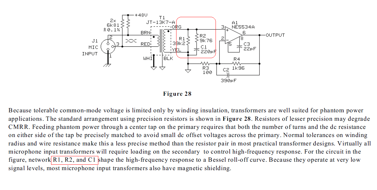

If I may shed my little light: :bulb:
The 100K just for DC reference, or 300K/1M is there to bleed the input capacitor in the last three instances; it is transparent in so far it is not loading the preceding stage.
The moment the preceding stage is a transformer (because that is what will happen if you have a bal-SE transformer #15), then that needs proper loading, i.e. 10K or often even a zobel. That of course will also load the output transformer of the preamp, but I expect that to be up to that task. It will not load the further input buffers.
in case I wanted to try vfet 3 (both 2sk60 and 2sj18) without the front-end, what load would the input transformer see? I need an input transformer as I use a pre with 100ohm balanced outputs ( and high voltage output )
Be sure to read the application notes by Bill Whitlock, on the Jensen Transformers website. They talk about the Jensen philosophy (or call it stiff necked orthodoxy if you wish), for choosing the optimum loading network / Zobel network across the transformer secondary. But of course D.I.Y. means do it your way -- not necessarily Bill Whitlock's way.
You'll see that the Front Ends with an output transformer, use a secondary termination with one R and one C ... unlike the attached figure below.
