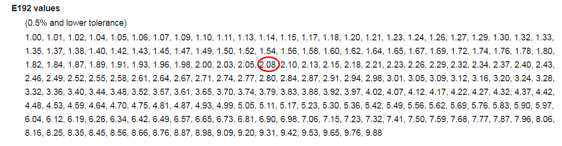

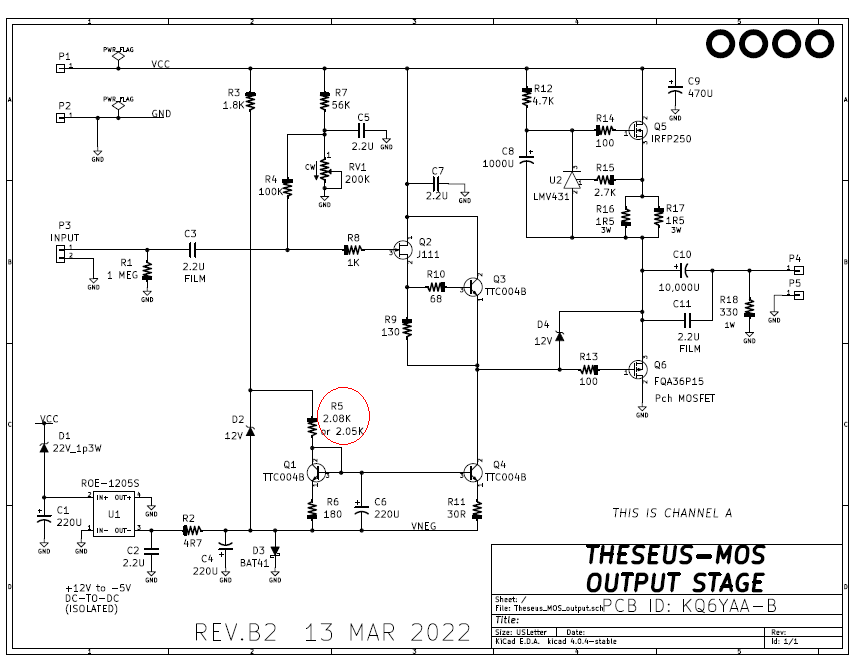

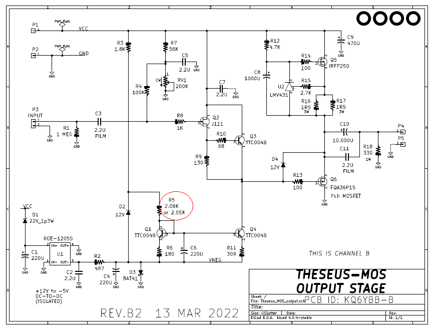

Hi Mark, getting parts together to see what I need to order. Can I ask a quick question - for the Theseus-MOS output stage pcb, the schematic shows R5 to be 2.26K, however on your parts list for this board you show R5 to be 2.08K and for the Mouser part number for R5 it says 2K05 (2.05K). Can you confirm the correct value for R5 thanks.
I have just read post #35 after writing the above - I assume R5 can be 2.05K?
Thanks for the heads-up; not one but two irregularities slipped through the final checks and into the .zip archive. I apologize for the errors. First, Channel-A and Channel-B schematics got out of sync; to see this clearly, print both, overlay them, and hold up to a bright light source. Whoops!
Second, although "2.08K" is a legitimate member of the E192 standard series of electronic component values (see attachment 1), there are none in stock anywhere. So I used 2.05K in my build, and I copied the Mouser part number of my 2.05K into the Detailed Parts List, leading to confusion: 2.05 is not 2.08! Horrors!. To repair the damage, I have modified the schematics (attachments 2 and 3) to indicate that either 2.08K or 2.05K is perfectly fine. I have also modified the Detailed Parts Lists (attachment 4) to indicate that either 2.08K or 2.05K is perfectly fine, and I removed all Mouser part numbers for R5. Builders can purchase whatever is in stock on the day of their order, without the distraction of someone else's ancient choice of part number, way back in February of 2022.
