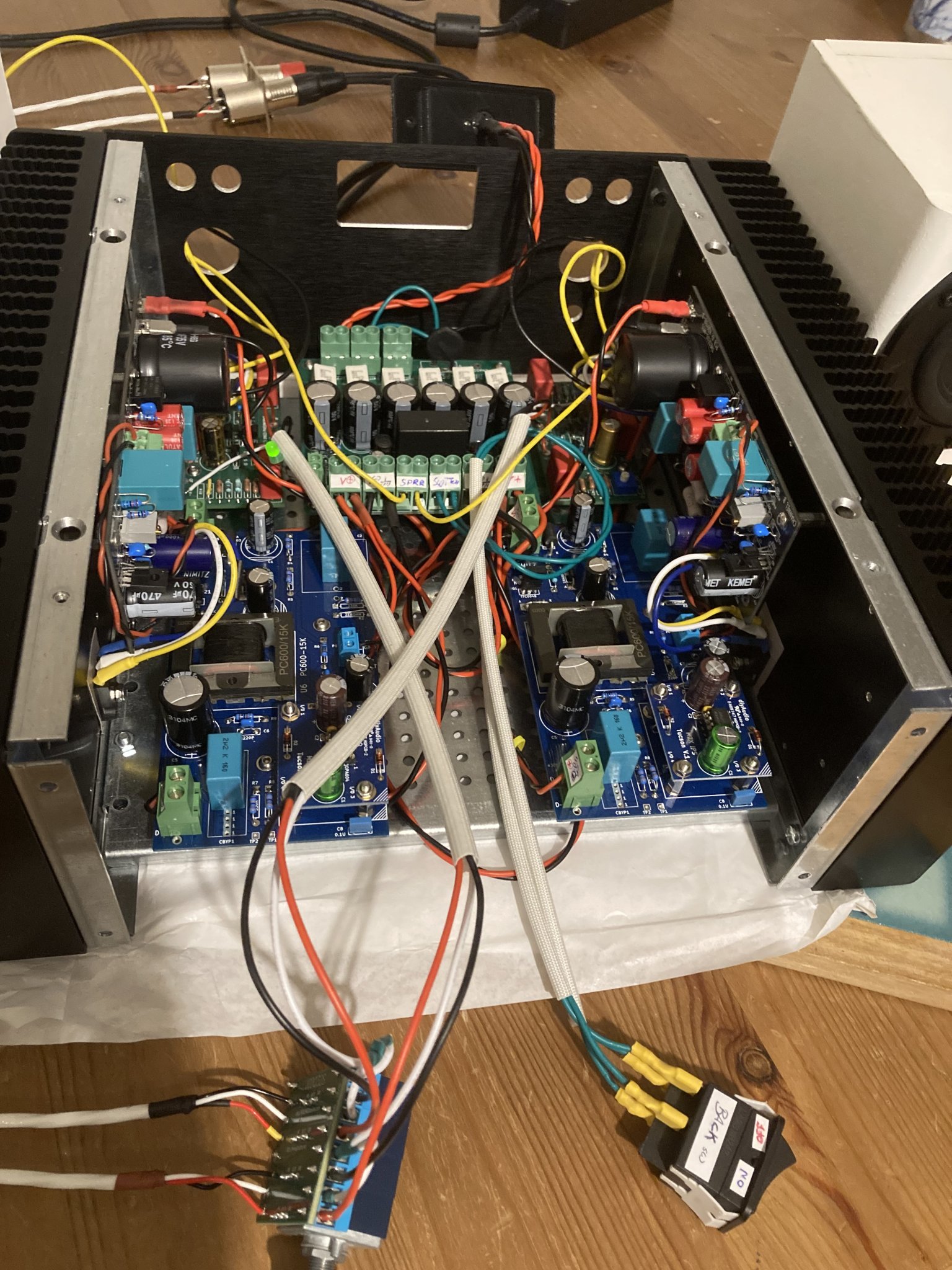

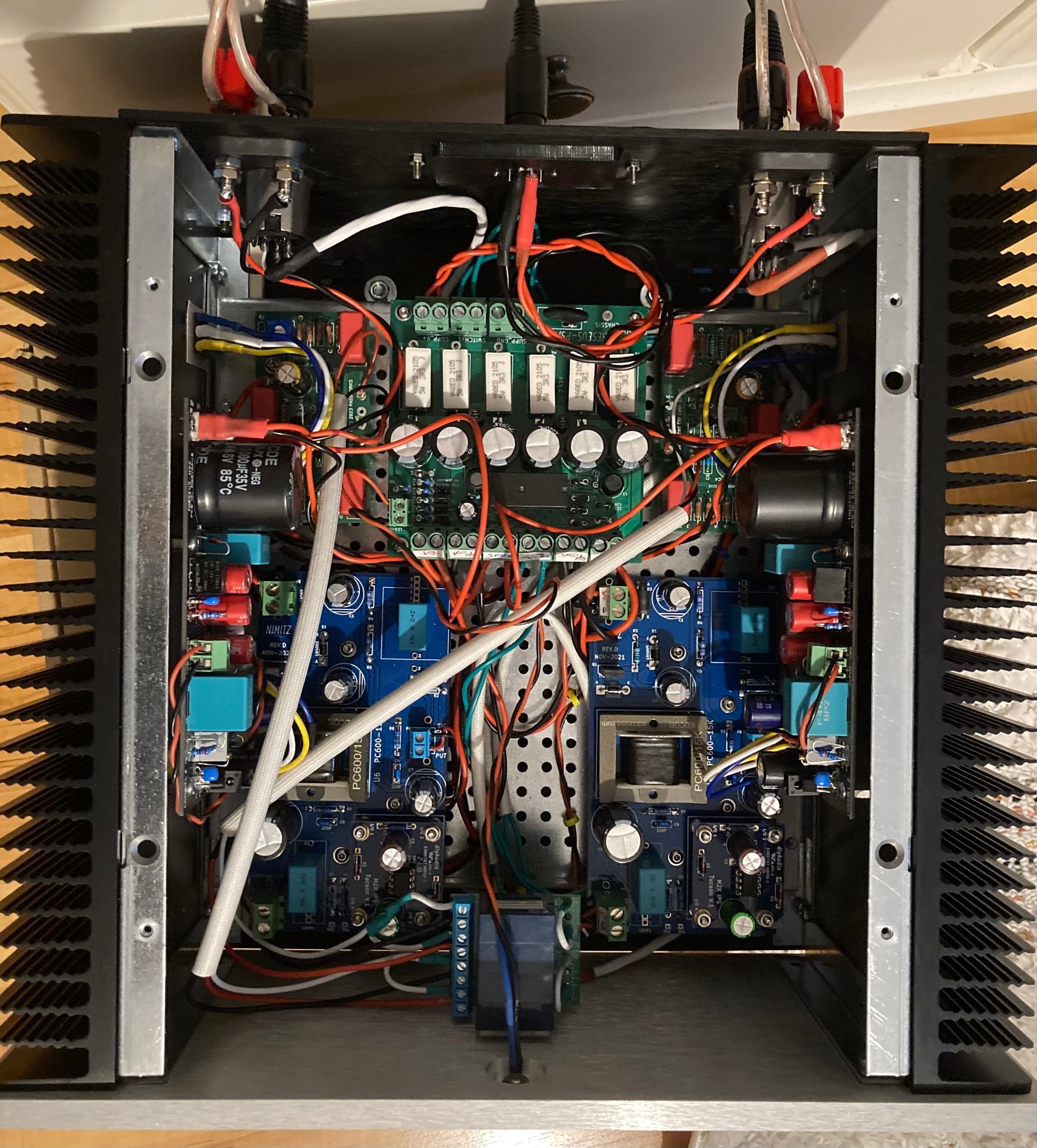

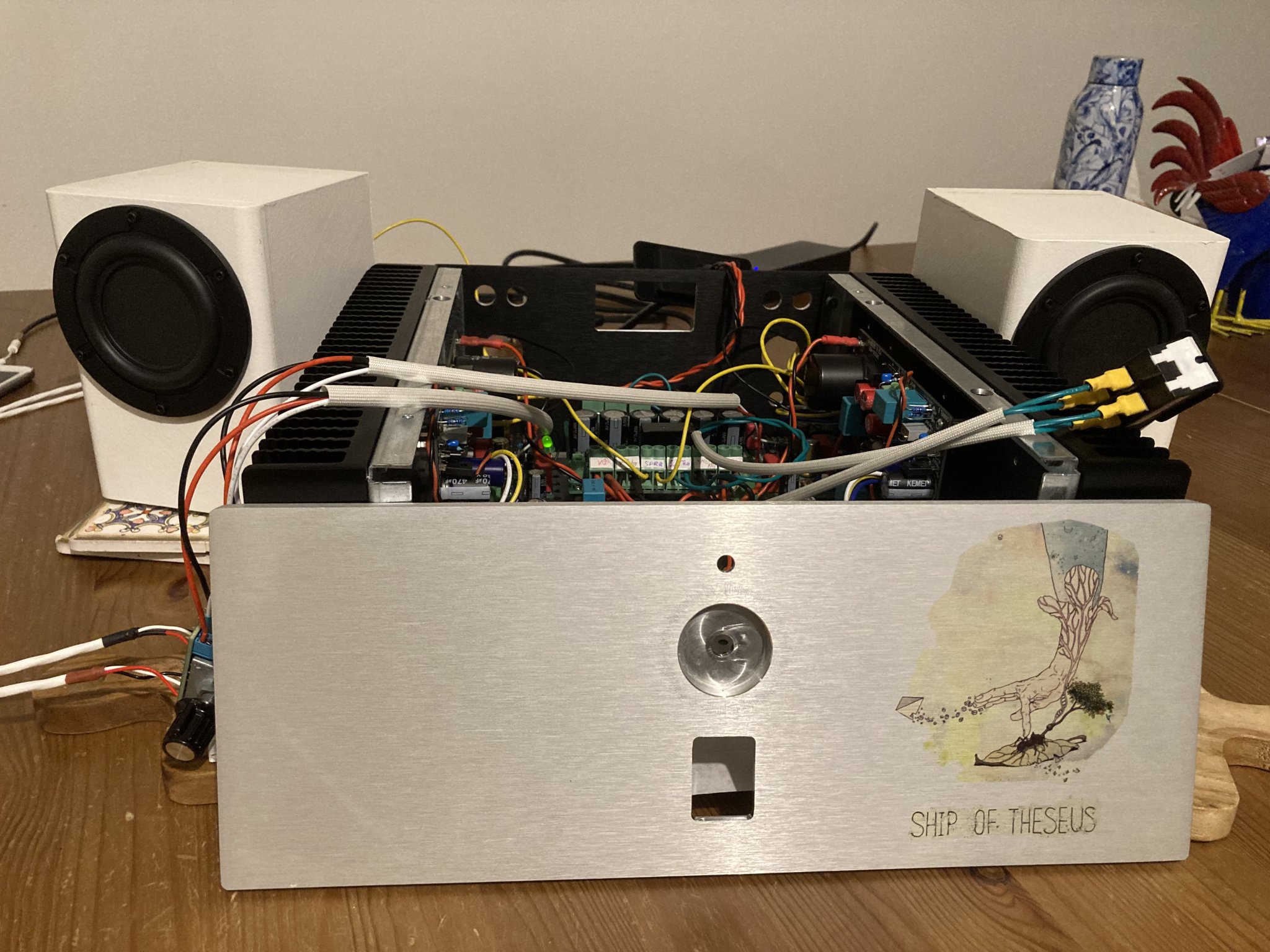

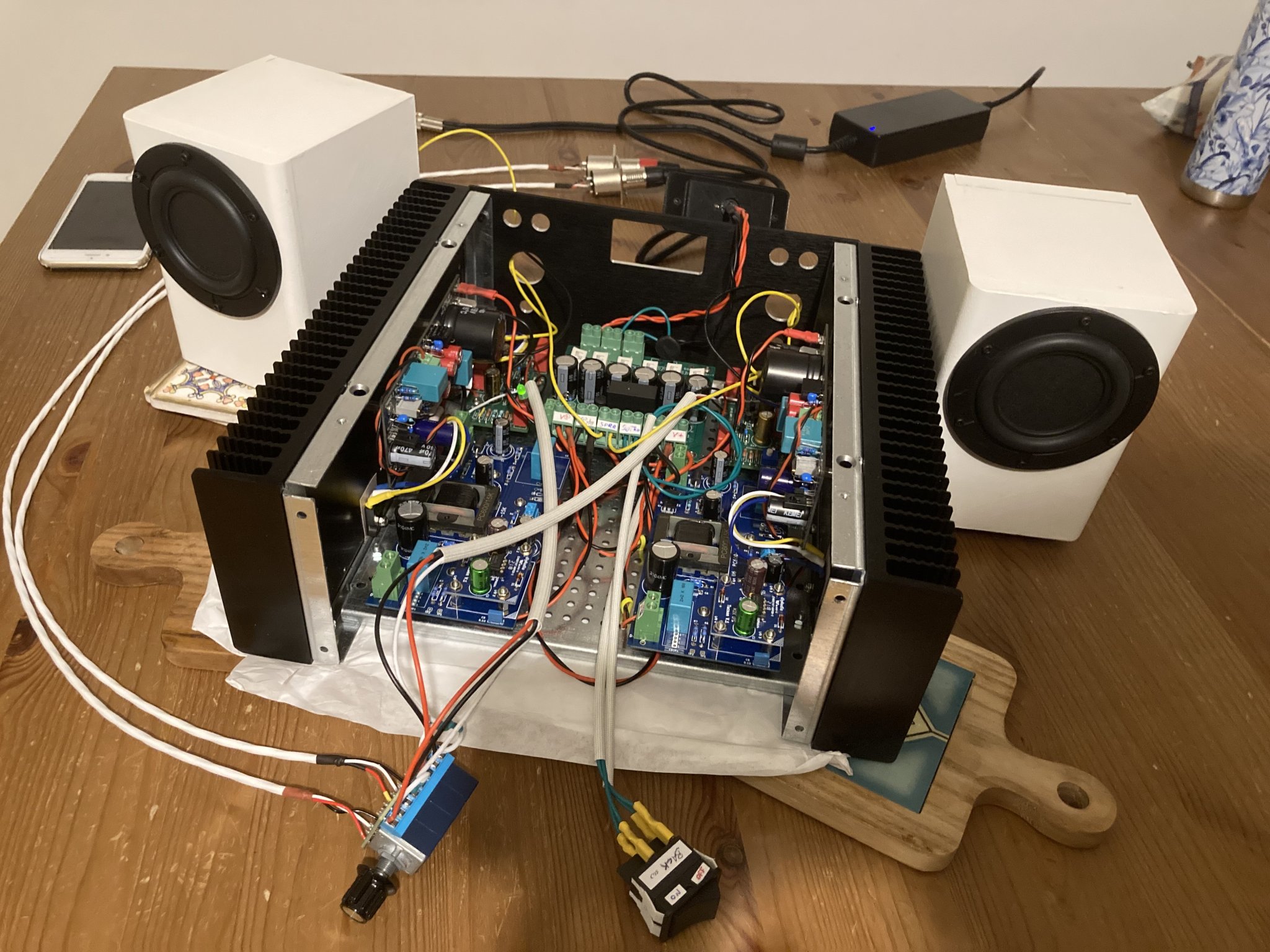

Playing music in a passive way (Mini Dissipante chassis received) after integrating most stuff inside. 30/40 minutes yesterday night

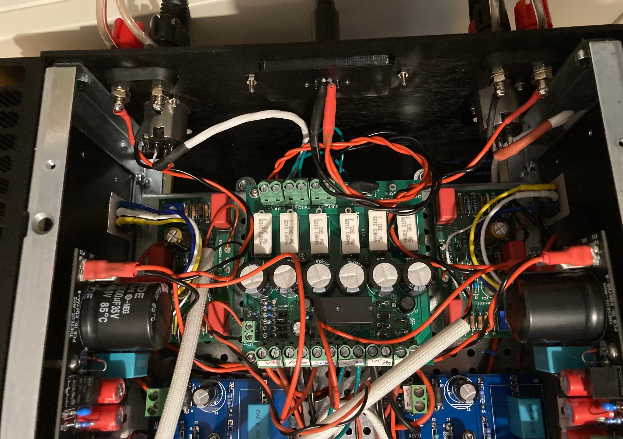

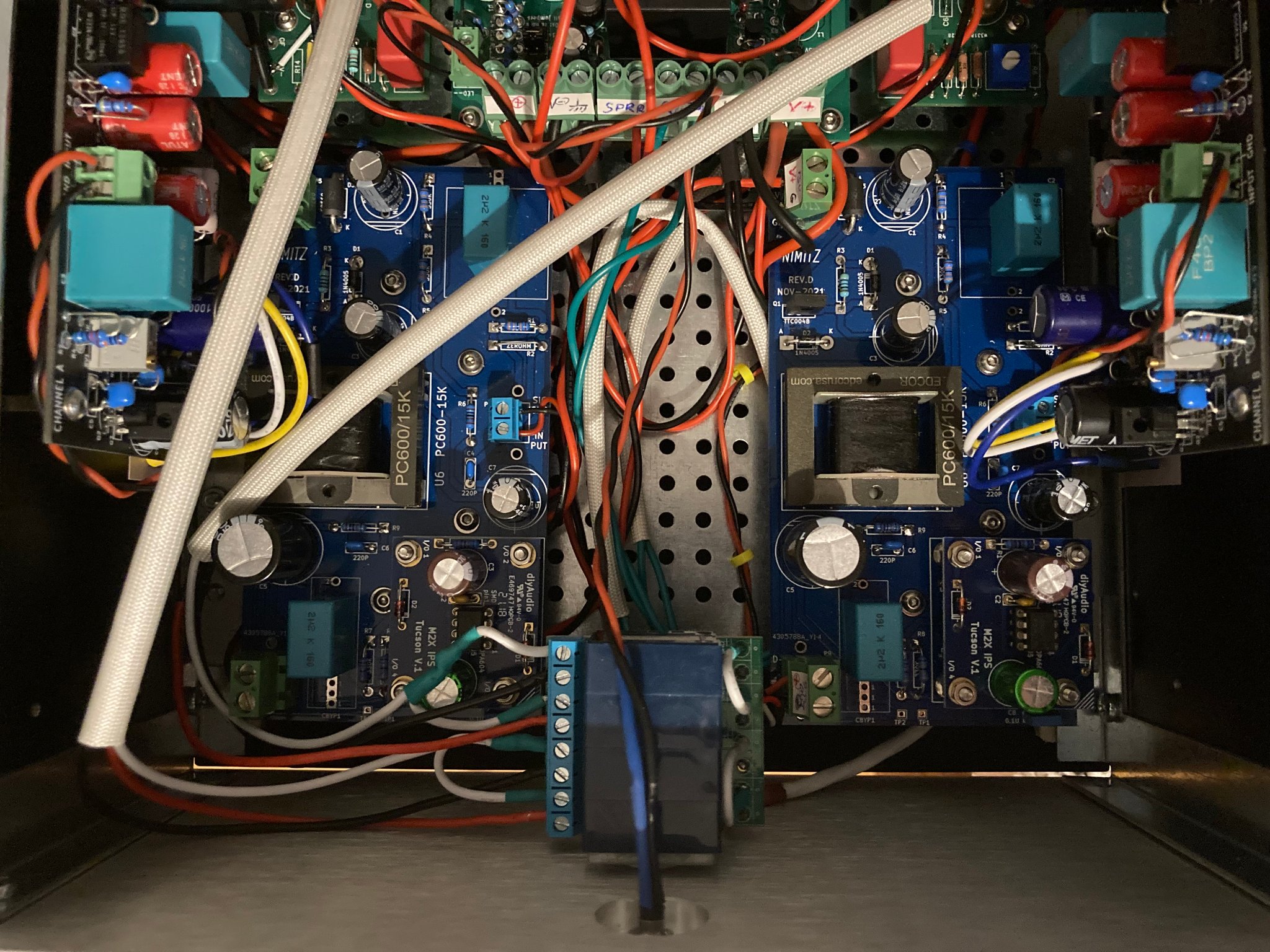

I had to put the power boards up compared to the usual/standard position, to let a bit of clearance with the components of the 1st stage.
I have different details to take care of, but, it is nice to know it is 90% completed.
Front panel picture is from the movie "Ship of Theseus" Wiki Link. Found it fitting...Haven't watch it
[learning point on this integration: cable material is important if you want to bend them easily. It can be too stiff...[white XLR cables from connectors to pot, some others wires...]

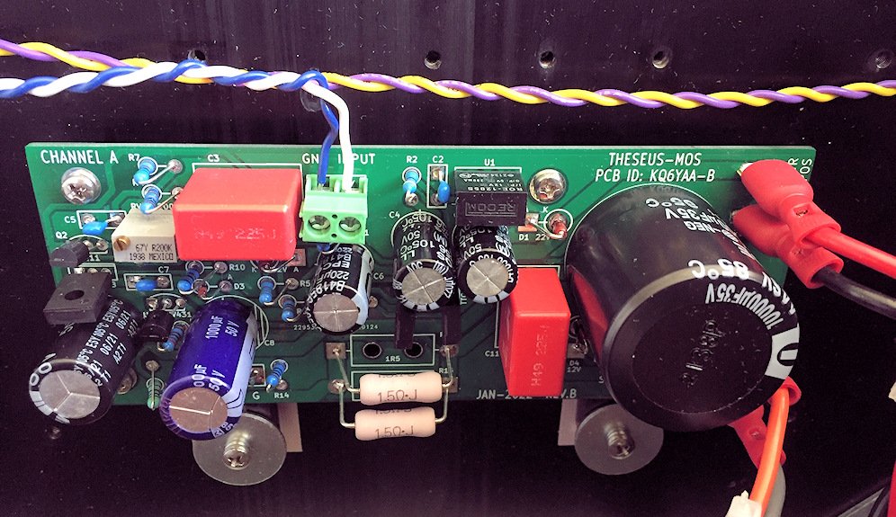

To make a Theseus "amp channel" board (picture attached) deliver maximum output power juuuuuust barely before clipping, you must drive its input with a signal amplitude of about 13V RMS.
Each of the Theseus "front end" boards (Nimitz, Lexington, Missouri, Kitty Hawk, Hornet, Bon Homme Richard, Pequod) has a fixed gain of 5 volts per volt. Thus if you've got a chassis containing
then you must drive the RCAjack with an input signal amplitude of about (13 / 5) = 2.6V RMS if you want to deliver maximum output power. Many preamps can do this but if yours cannot, you could consider adding another gain stage.

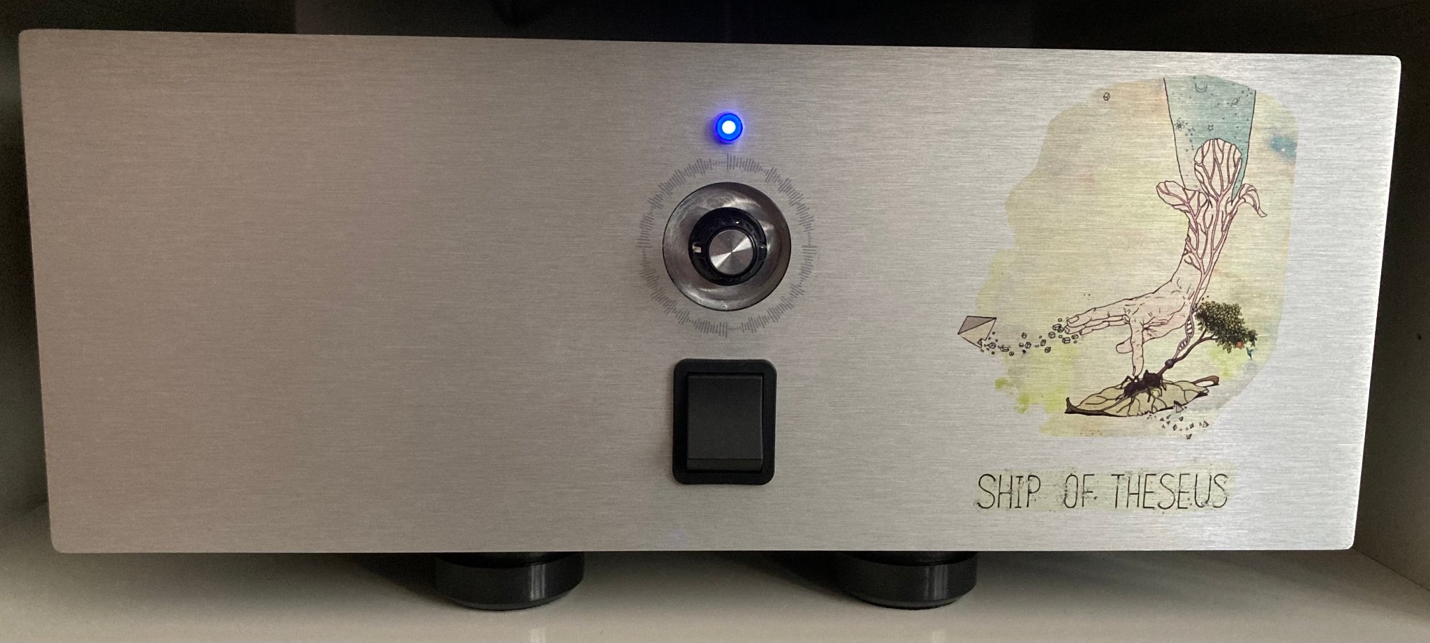

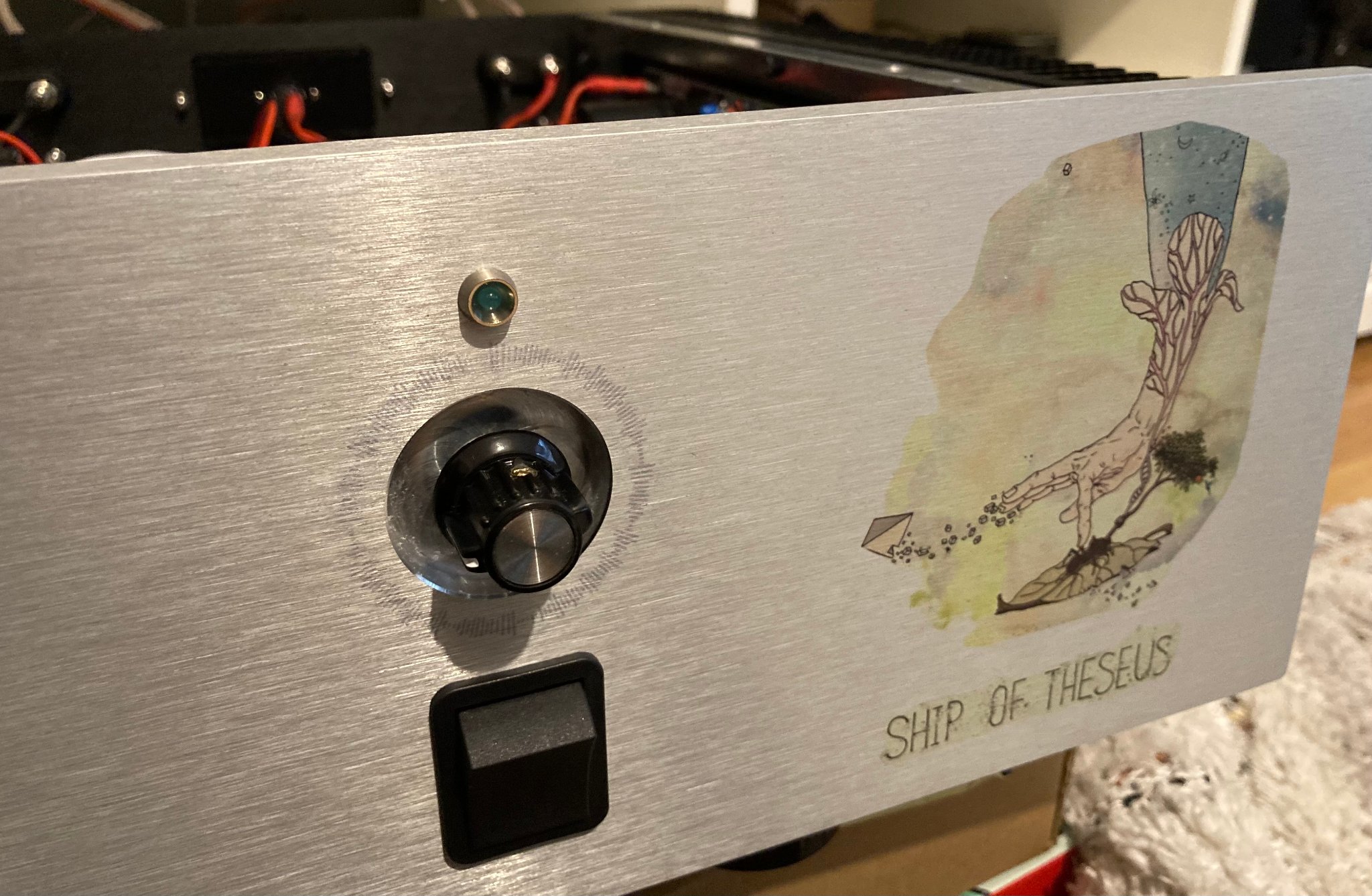

Hi.

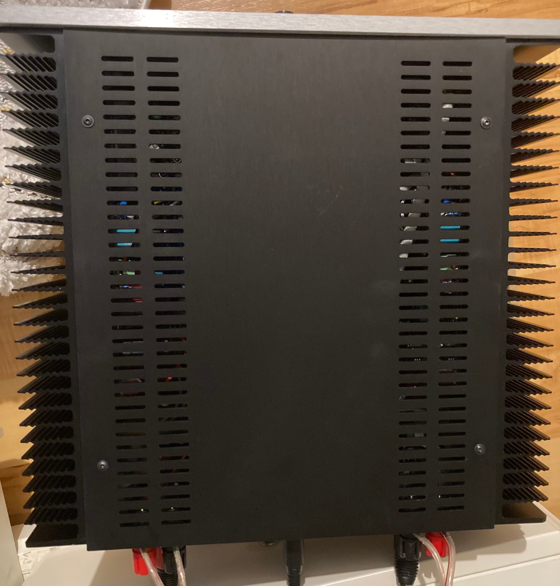

After a few weeks of listenning to it in "proto mode", i finally installed the front panel, XLR & power supply adaptation on the back panel.
Ship of Theseus with Front End 2022 also inside.
Here are the pictures.
Notes:

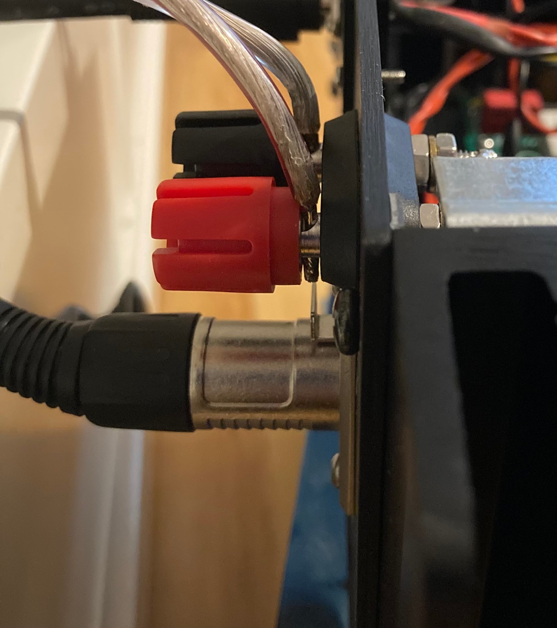

1. XLR just below the speaker connection is not a good idea (spkr cables in xlr cables in some arrangement)
2. i once bought 3wires cable for XLR to pot, which had a very very stiff plastic outer layer. Very hard to manipulate, so a pain to arrange internally.
3. Big switch is for a potentiel adaptation for a later amp. 3D printed plastic part to match bigger IEC model and the actual Ship of Theseus PSU inlet
(but given the mess of wire, i may never change the inside for another amp!)
4. Some screws access are a pain for the front panel...
5. I find the Modushop anti-vibration legs a bit too high. I might change that later
Goal of easily changing the input M2x-style card not tested, but i have vertical access (easier on 1 side than the other), which was the goal.
