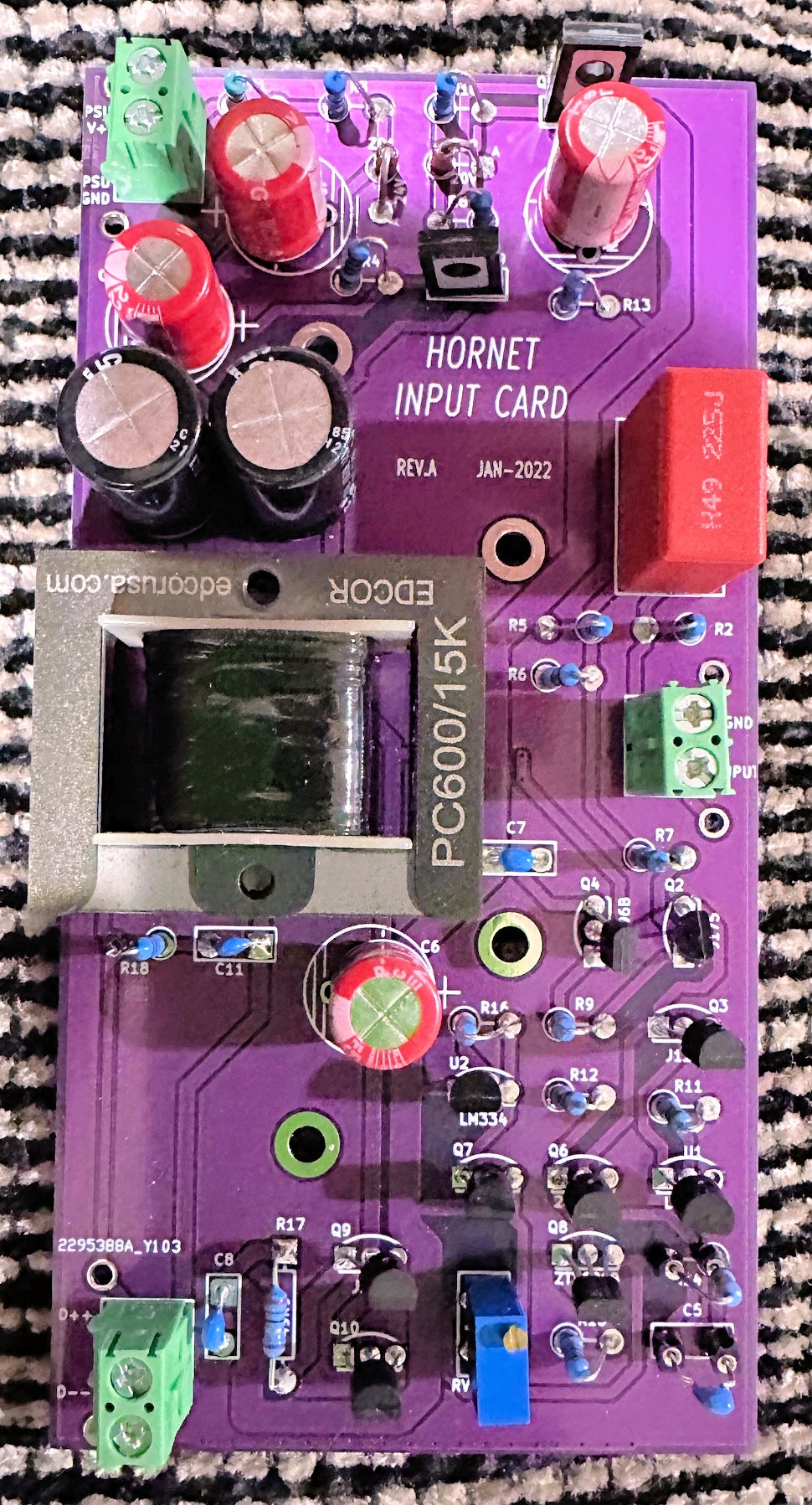

The Hornet input card is actually easy to stuff and solder -- components are pleasantly spaced, comfortably apart from each other, and it's not difficult to assemble. But you do need to measure (test) a few of the TO-92s before approving them for Hornet use. Think of this as the Pre Olympic Trials -- winnowing out only the best of the best.

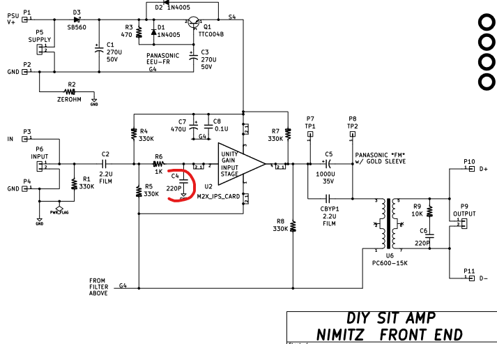

Just for fun and 1 question:
A] Just for fun: long term plan is to have a Ship of Theseus in a Mini Dissipante chassis, so waiting to have it done (as well as managing budget) while at the same time being able to study different configurations inside & carry it to a Maker Space for access to DC power supply, oscillo, spare heatsinks,... here is a picture of a laser cut plexiglass Mini Dissipante modular plate with a handle!
Amp channels will later go on the side on the heatsink
I prefer to play around with this kind of prototype than 3D work (too many hours spent on a computer already.)
B] Question
M2x is said to be a bit fussy with Valve Preamp due to C0 in front of the input stage
Would it be similar for the Ship of Theseus with Nimitz front end, this time with C4 ? (schematics with highlight in red. Arrangement looks somewhat similar to M2x, hence my question)
B] Question
Thank in advance
… hum … **** … but good to know !
So, once build, i would start using a transistor preamp.
I have a Noir and i guess a Nutube preamp with op-amp at output should also be fine.

Take out your wire cutters and clip both leads of Nimitz component "C4" so it falls away from the PCB and into the trash bin. Now attach vacuum tube equipment to Nimitz. Problem solved.

I would prefer to keep the circuit "as is" and just know the limitations & options.
Maybe it will push me to study the other front end cards to see if they adress this and it will be an opportunity to build yet another component.
