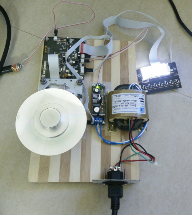

Hi all,
I assembled my kit yesterday. Initially I connected the cd transport to Chord Mojo via co-axial and listened to it for about an hour on headphones and it sounded good.
When I connected the Mojo to integrated amp the audio was cutting out, I hear audio for 2 - 3 seconds max and it cuts out for 5-6 seconds and plays again for couple of seconds before it cuts out again with occasional clicks and pops. Then when I connect back headphones it was playing fine.
Today it was not playing from headphones and hi-fi too and had the same problem as yesterday. Any idea what could be wrong?
BTW the voltage from the regulator board is 7.95 volts. The disc gets initialised properly and all the functions work.
I've two kits (one is mine and other belongs to a friend). The problem is consistent and can be reproduced with swapping the cd mechanism, main board and cables. The only thing I didn't swap are the transformer and regulator board which I don't think will make a difference. I use a co-axial cable with rca to 3.5mm adapter to connect to mojo.
Any help would be appreciated. I'll borrow another dac tomorrow from a friend to see if Mojo is failing to lock on the co-axial signal or any problem with the adaptor cable.

Could you please reverse DOUT output as per my above drawing post 1485.
This is also happen when your amplifier have a noisy power supply or is self oscillating. Shiga MKII do not have a galvanic isolated output. The downside of this is that your entire audio chain must be very low noise.
To clear such issues, you must use a s/pdif trafo. Scientific-conversion make some very good ones. I have used murata da101c with good performance as well. However, I recommend you to use Shiga MKII as it is, with direct output from resistor divider.

Thanks Tibi. Reversing the DOUT polarity as per the new connection diagram worked for me. It sounds very good as per my initial listening impressions.

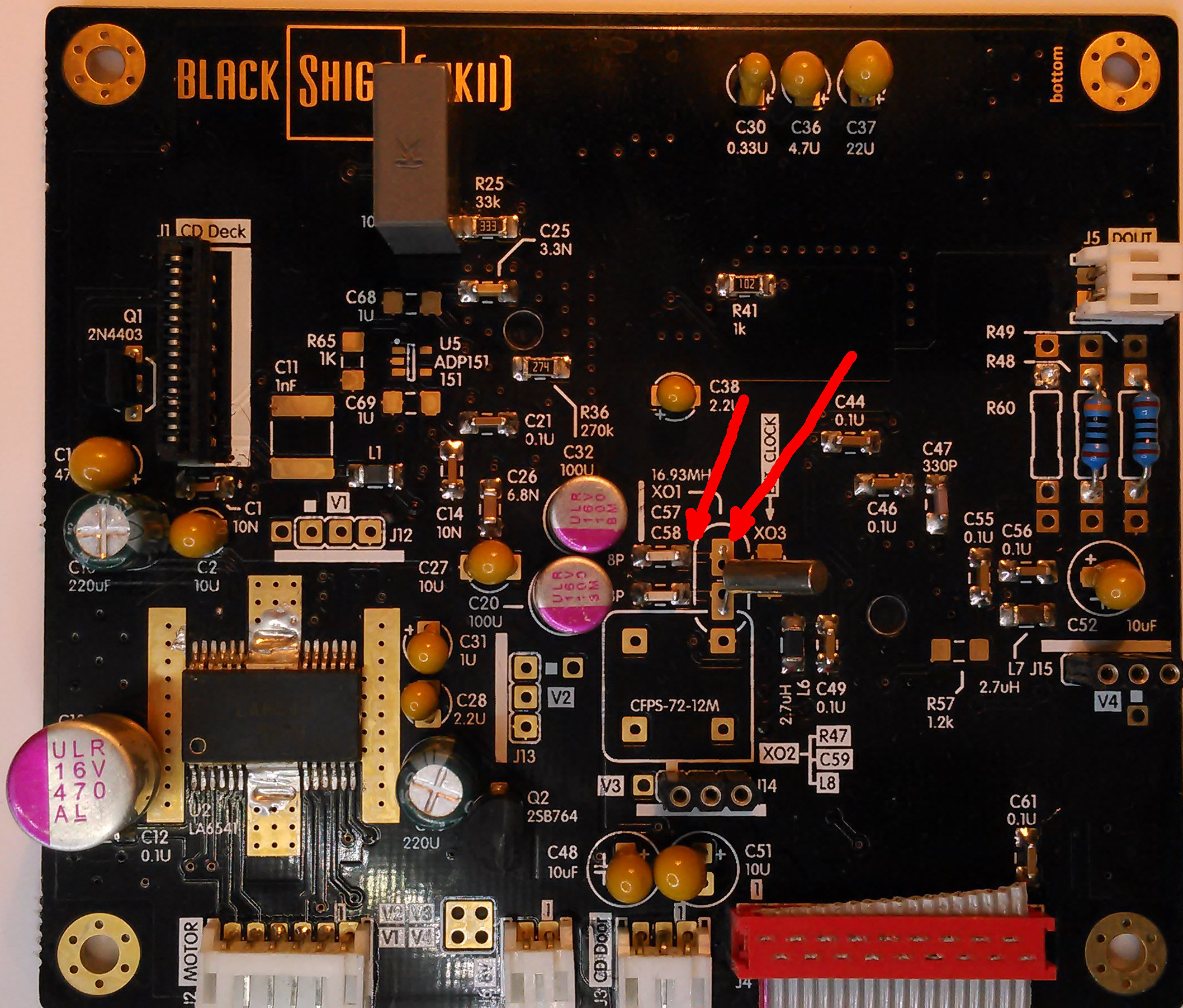

Remove XO+C67+C58 or Tentlabs and feed clock from Dexa via XO3 with an as short as possible pigtail connector. Make sure that your Dexa have a completely separate power supply from trafo to regulation.
Some more info here http://www.diyaudio.com/forums/digi...ii-black-builders-thread-119.html#post4352711
Tibi
Hi Tibi
Just getting back to this now.
Do you mean C57 + C58?
they are side by side on board and marked for use by X01
I could not find C67

Trouble in paradise
See attached picture. Red arrows indicate alternative soldering points.
Tibi
Thanks Tibi
I had worked that out for myself from the schematic for XO options on the assembly manual. I believe I have fitted neutron clock correctly but..
But for now shiga is kaputt.
- mechanism does not spin on startup
- display is backlit but no info displayed
Do these symptoms suggest the clock is not installed correctly or is something else at fault? If Shiga is not receiving clock signal are these expected?
Will go back to check all is as it should be again.
Thanks in advance for your help
