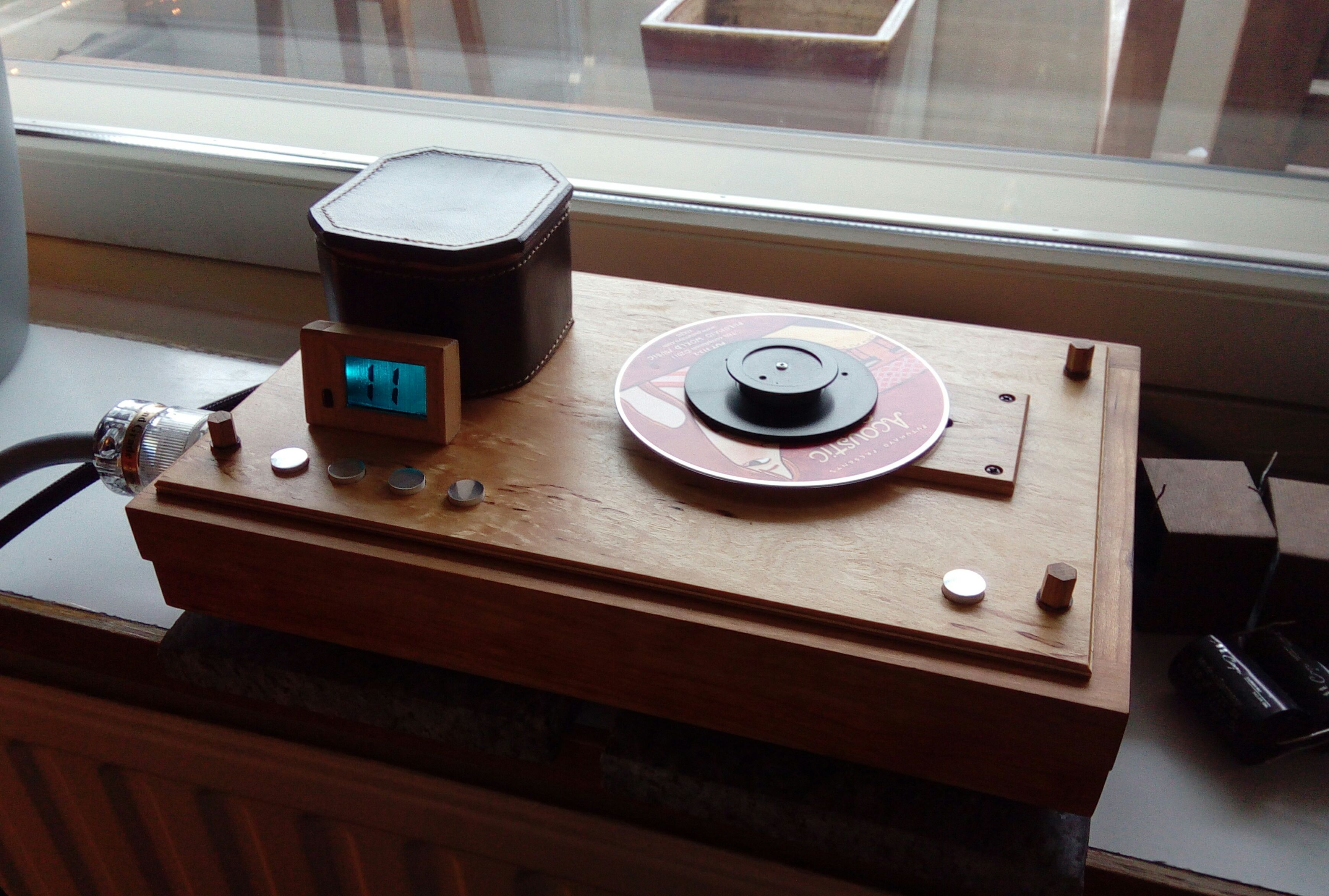

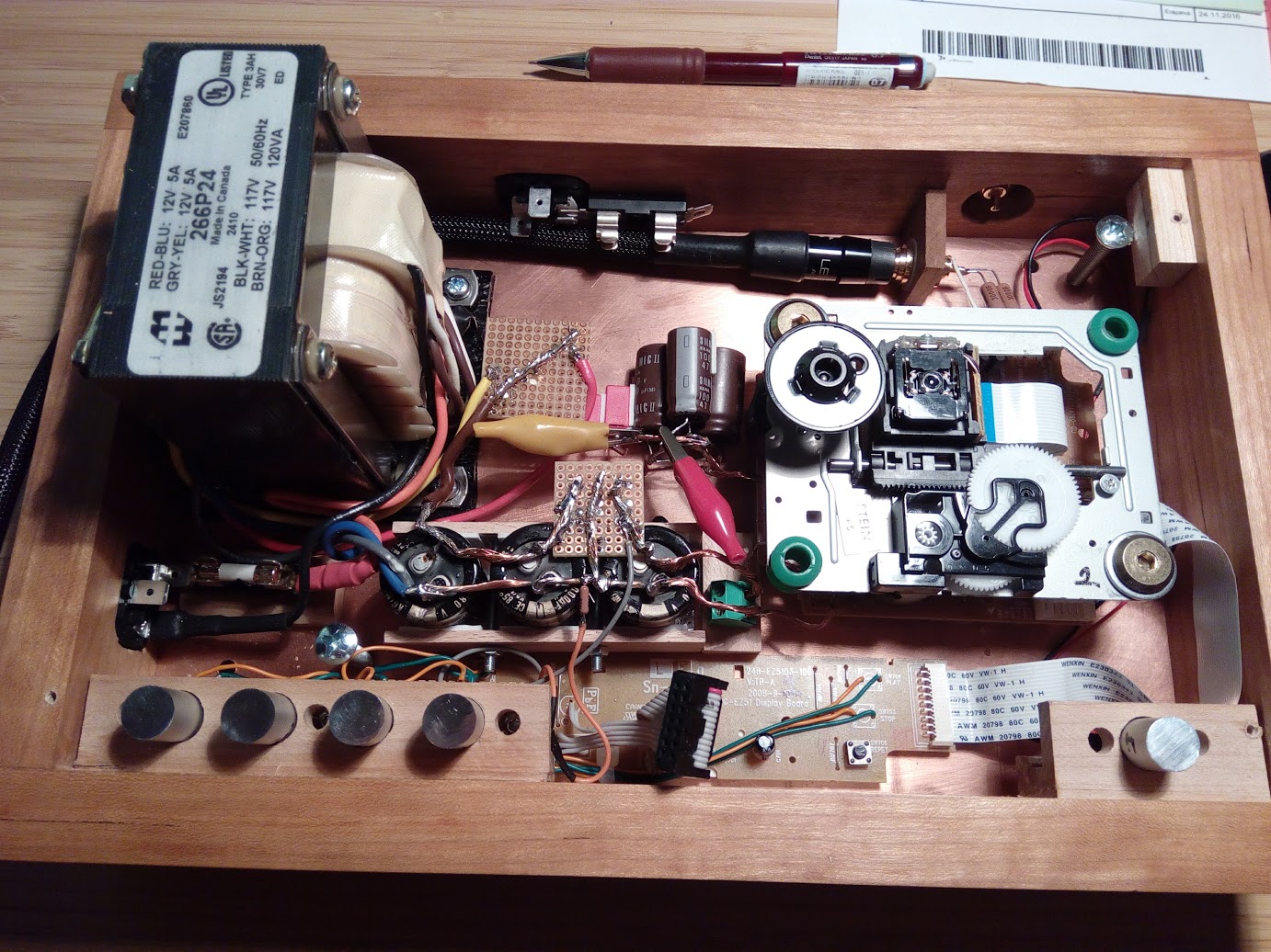

Hi Tibi,
Been listening to the Black Shiga transport for a couple of days now (had it on 24/7).
Very nice. Some things it may be doing better than my own shiga version (pics attached). A bit more clear and the upper midrange may be more resolving. =)
The bass prowness and easyness is still not quite there (maybe the more robust power supply in my own version), along with that enveloping soundstage. I'll have to test the effect of changing the transformer also - from torroid to the Hammond in picture. At least changing from 96V to 120V with Hammond made a clear difference.
I quess it's time for tweeking some of those parts and laser you guys are talking about. 😀
