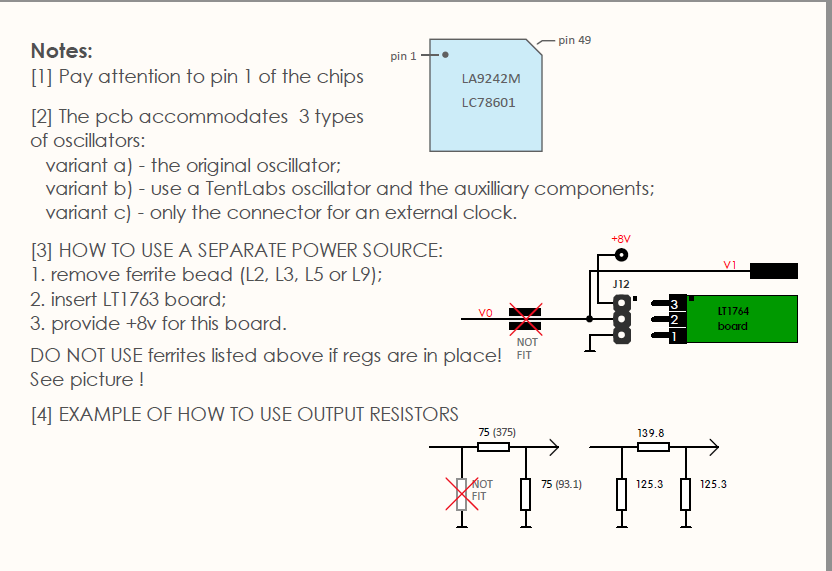

Hi Tibi,
V1 and V2 are in like the picture. The pin marked IN on the belleson regulator corresponds to pin 3 in the picture. It has the common pad next to it to put voltage (12v from outboard supply). Center pin marked 2 in picture is output, and pin 1 is grnd, which is common with pin 1 on J2, where the input voltage returns go for V1 and V2 power.
Now forget about V1 and V2. Lets just say they are in correctly. What would cause the Cd mechanics to run all the way out to the end and try to keep going when powered up? I'm thinking its a problem with the motor cable. Although it is a new cable. I'll check it out tomorrow. What do you think.

Hi,today I changed the Regulator from Main PCB to LM317 and the Resistors to 120 and 680 R as per Bom, I´m not getting 8V ,how close does it have to be?

DT,
LM317 is not the regulator I have recommended. The performance you'll get have nothing to do with Shiga MKII.
Main voltage is limited by LA6541, who is able to work between 6 and 13V. In this case voltage is limited only by power dissipated by LA6541.
With 120R and 680R you'll get ~8.5V which is also OK.

So you say LT Regulator is better (both are in Bom)? I just got Lt1086 with fixed Voltage,8 or 12 V.

There is no LT1086 with fixed 8V.
You can get LT1086 with fixed 12V, but power dissipated by LA6541 will be to big and you need to install a proper heatsink.
I suggest you to go for LT1086-Adj and use 120&680R. You'll get 8.51V which is perfect.

Tibi,
I never get to read TOC. Power off. No CD on transport. Turn on power, Laser moves all the way out and tries to keep going until power is turned off.???

Tibi,
This dinosaur doesn't have a camera phone. Will it show with a regular digital camera? I looked with it and didn't see any laser. I disconnected power to V1 and V2, They are still soldered in, and put L2 and L3 back in, to get back to where I was before new problem. I found broken wire on motor cable. Fixed it, but problem persists.
I buzzed connections from where connector solders to brd between Cd machanics and main brd, and push button brd and main brd, and have all continuity.
Symptoms the same. Power on with or without CD in place and laser moves as far out as it can and tries to keep going until power is turned off. I checked with a magnifier for broken patrs, but don't see any. I have been extra careful since I got the brd back.
Any suggestions? Thank you. I have everything ready to install into chassis, but I am starting to get disillusioned with this project. Besides having a bunch of money tied up in this project, if I didn't know how wonderful this transport sounds when working I would be just about ready to give up. Everything seems so delicate. And I have been doing electronic assembly for the past 40 years until I retired last year.

Tony,
To help you I need a little support from you.
I need high resolution, high clarity pictures. Use macro option in your camera. Pictures must be on pair with these made with my phone camera http://vicol-audio.ro/img/shiga-mkII/shiga-mkII_bot_det.jpg
http://vicol-audio.ro/img/shiga-mkII/shiga-mkII_top_det.jpg
I need to see CD inner axe as well.
On other hand, this is a SMD board, parts are small, you need to handle with care.

Guarnera,
Other people have had the sled do the same as yours and it was because the the 6 way ribbon was the wrong polarity.
