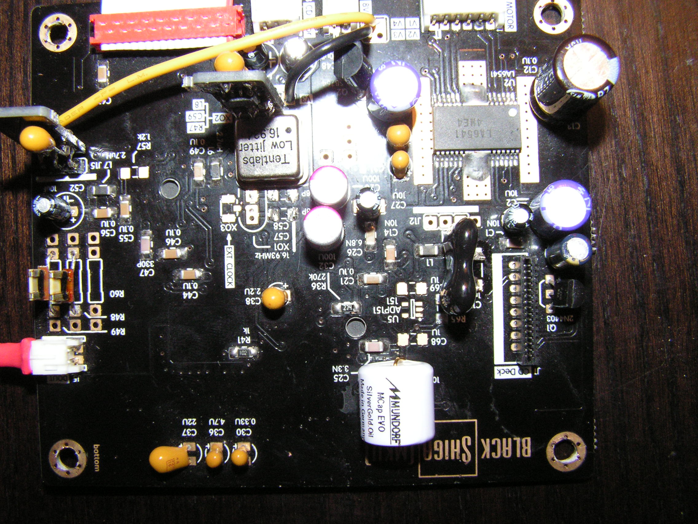

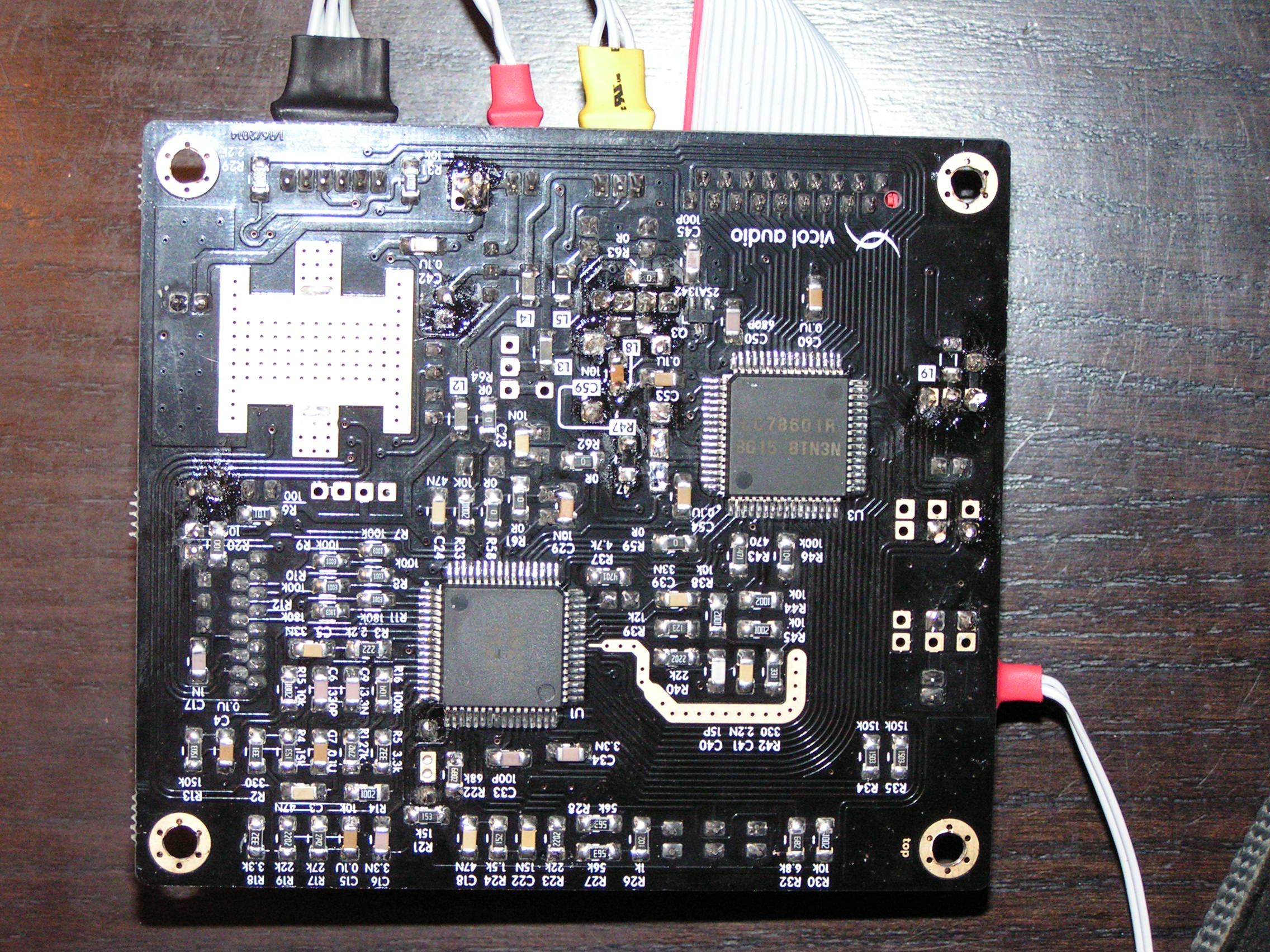

Hello Tibi,
I upgraded the my standard MKII to high grade according to your specs, but when I start it up only the controlboard lights up and nothing else happens.
I don't no what to do, please help.
Robert

Please post detailed pictures with front and back of board to see what is there and to help you.Hello Tibi,

Robert,
You need to clean all the flux off for starters. The soldered joint adjacent to C42 doesn't look very good but hard to tell with all the flux. Also all the other new soldered joints made for the mods are very poor and don't look like the solder has melted and wetted the joint properly. Think you have an abundance of dry joints.
Aleks

Hello Aleks,
Thanks for your reply. Somebody advized me to use Flux. I'am just an amature, how do I clean the flux off?

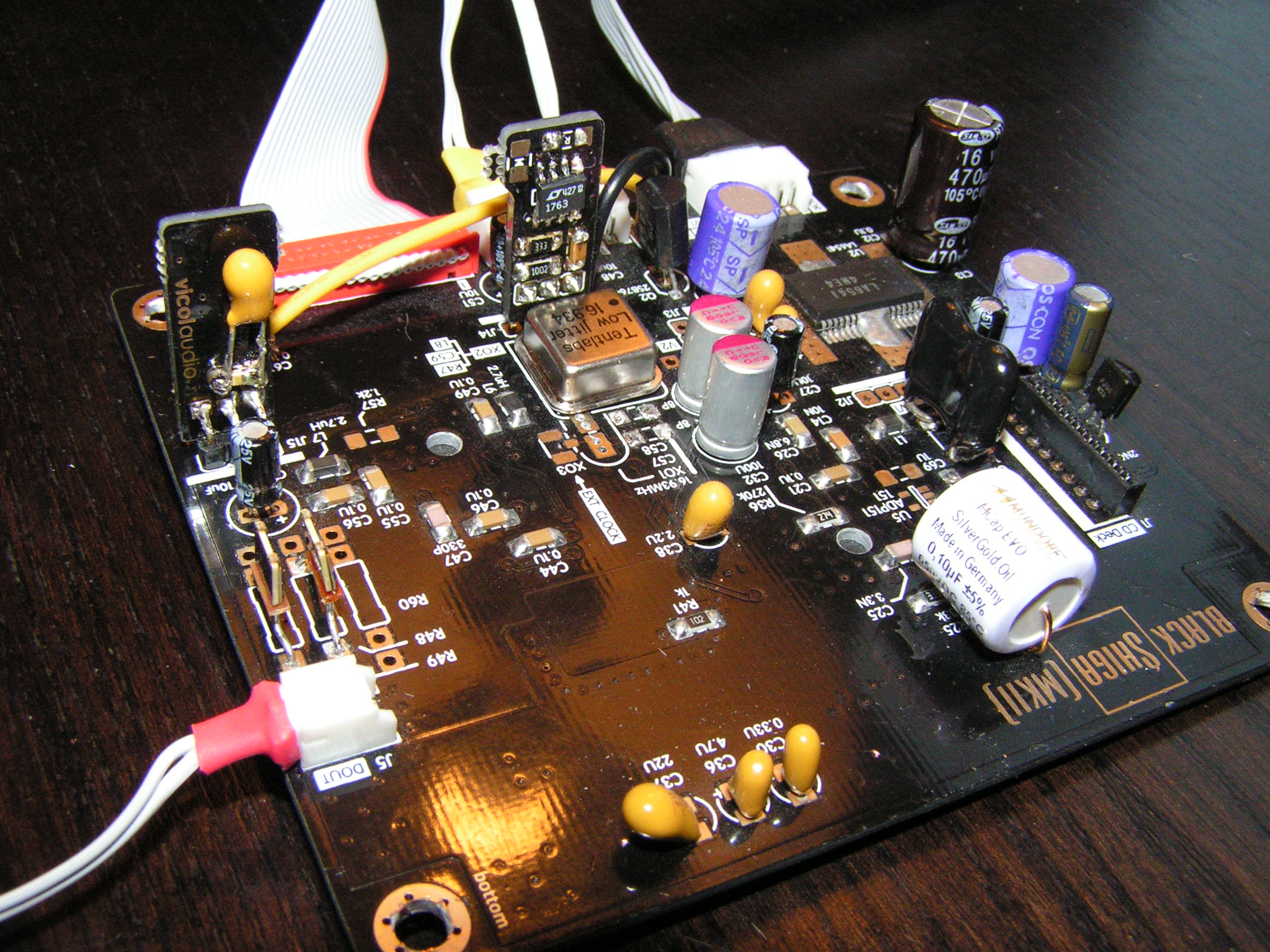

Hello Danzup,
Here are some pictures. Hope they are detailed enough.
Robert
You Tentlabs clock is wrongly mounted.
Have a look on me website and correct.
vicol audio : Shigaclone mkII high grade (click on pictures to get higher detail.)
Tibi

Sink entire board in isopropylic alcohol and use a brush.
Display must be protected, otherwise will be destroyed.
Tibi

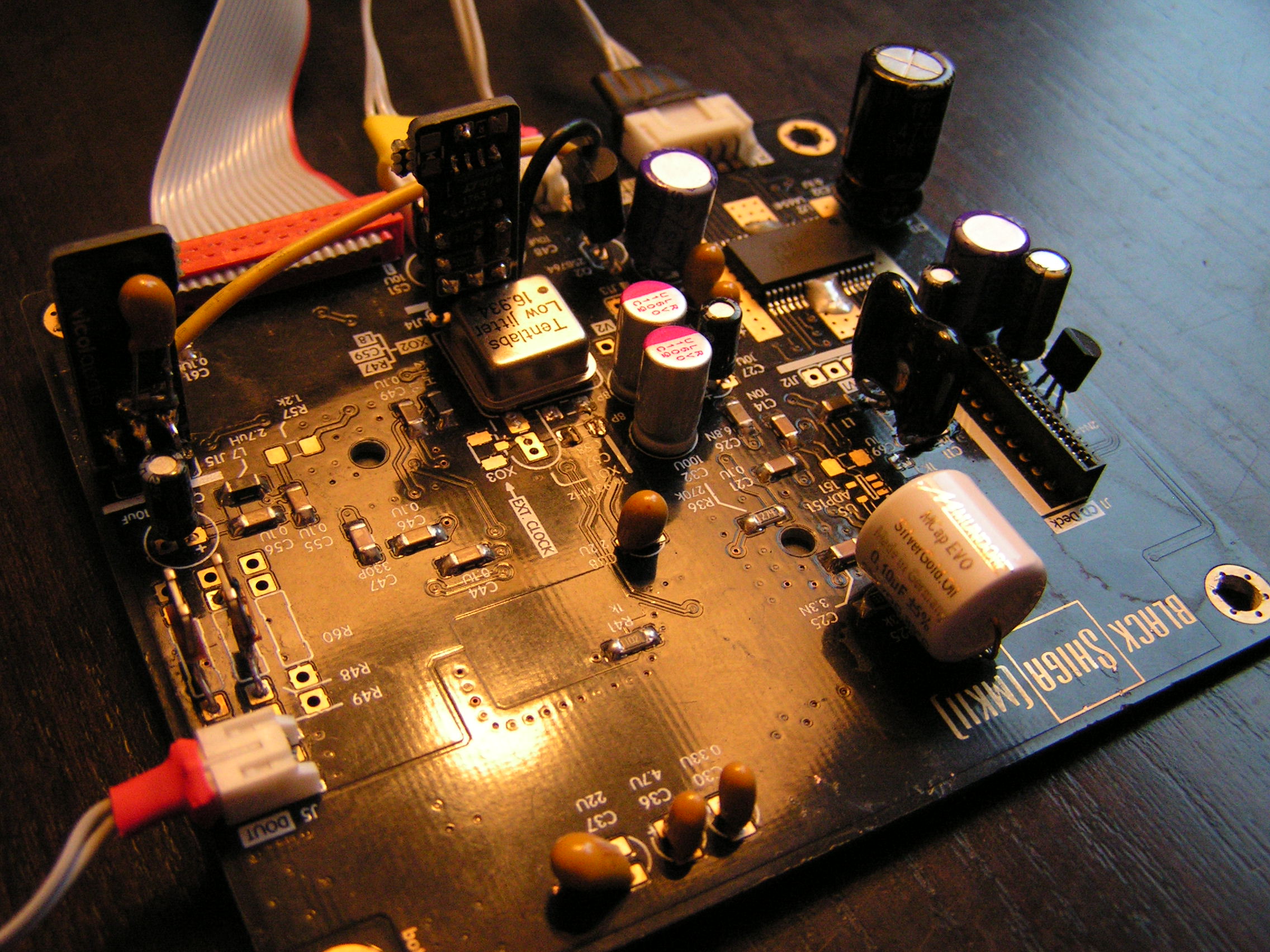

Hello Tibi,
Did not dear to sink the entire board, but cleaned as well as possible using a brush dipped in the alcohol. Took the Tentlabs clock out and tried to solder it in the right possition. Than I realised that I'm not good in solderering (putting it mildly) and ruined the joint for the pin right under the T from Tentlabs. The solder doesn't connect anymore. Can I hardwire that pin to another point on the board?
Robert

You probably refer to minireg V3? But which of the 3 pins of the minireg is +5V?
