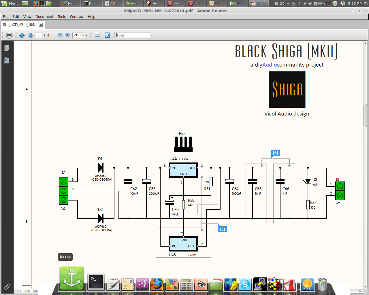

where can I solder LT1086 direkt,is there a Plan somewhere,got rid of some Pads on PCB.

Where do you want to solder LT1086 ?
If is LT1086-adj than you have separate pads on power supply.
If is LT1086-5 than you can solder on V1 and V2.
Tibi
It is 1086-adj and some Contact Pads are gone from desoldering LM317 -adj.
Post pictures to see what you did, of follow traces with a multimeter and solder to nearest points.
Tibi
Wanted to follow Traces, but when the Pads are gone there is no Contact.Today i got some 3 Dioptrin Glasses,now I can see where the Traces go from Middle and left,not shure where the right one goes:.(looking at the Print).
Thank You ,now I got it. Today the Mini-Regs arrived.Leds are missing,is it just as Power Indicator?

Yes, just a power indicator and is performing better without.

In case XO tentlab is on board:
on the schematics, for C59 it is indicated 10nF NPO (1nF Silver Mica). Would a 1nF silver mica be better than 10nF silver mica here? Or was it a print mistake?
If you are going to use a MLCC, use 10nF NPO.
If you are going to use silver mica, use 1nF.
