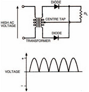

Thank you kind sir. However, transformers do not have a center tap.
115V in, and 12v out. Two terminals on the input, two terminals on the output. Easy to use a bridge rectifier, but if I want to use diodes, I guess one leg would be grounded, and be ground. With the filter cap between them. But I get confused about the diode, in this situation. Does the diode on the ground leg, does it fast the opposite direction, or do the both go in the same direction, as in your drawing. A little drawing would be greatly appreciated. I want to make sure I get this right. I have two 12V transformers, so I would like to make separate supplies for V1, and V2. Thank you very much. You all have been such a great help.
If your transformers do not have a center tap, you need four diodes
