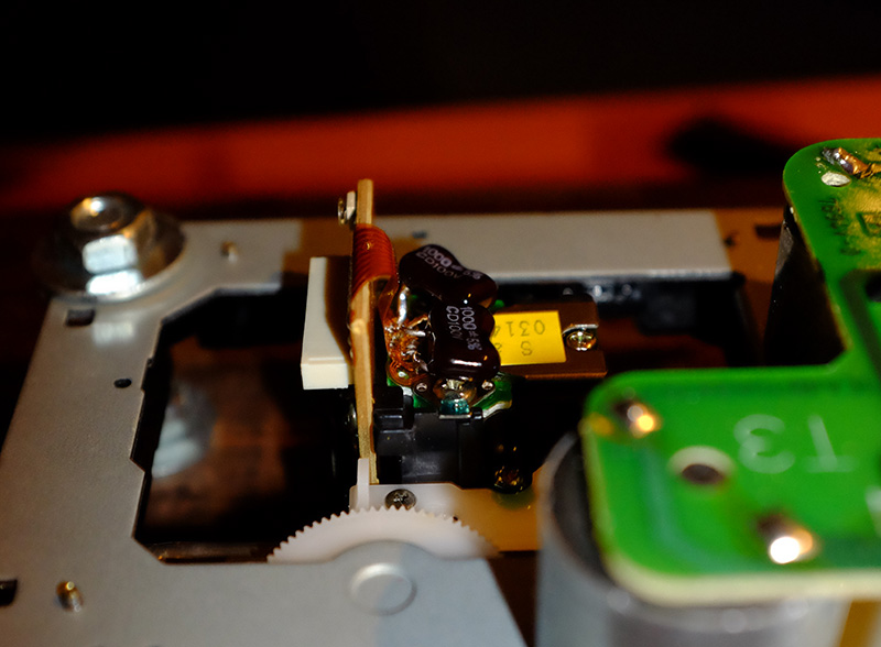

I just received an older version SFP101N-16P, it has the gold transparent ribbon cable and the 2 XLR5 smd caps are located on it. Does anyone have experience removing these and then what do you use as a landing for the 2 new caps for the mod. I have done this once where the XLR's were down flat and there we 2 very small pads left to work with. Also there is a partial cover over the pins that the mod attaches to, is it okay to remove? I hope someone out there has seen this before and can offer some advice. I think the dates are 2005 on motors if that helps. Thanks!
[camera batteries are dead so pictures later if it helps]

I am using this mecha
The toughest part is that you have no space to maneuver the soldering iron.
I do not remember which cap is which, but if you look at the leads in the ribbon cable it is quite easy to locate and use the solder points for attachment.
The ribbon seemed quite tollerant with heat. I used 350C degrees on my station and it did not even sweat
Don t remove the metal lid. It is protecting stuff. Both electrically and mechanically.
Ok, lasermods + one old idea done today.
The "bastard trimmer" as Dimitris put it is gone. I measured mine to 925R so I took an 820R 1% metal foil and sandpapered it a bit to 925R 🙂. - probably not 1/8W anymore 🙂. Tried to find an LT1086 to enhance the PS - got plenty of anything else 🙁.
Didn't have a 100pF silver mica so I put in an wima fkp 150pF for the trimmer mod whilst waiting...
