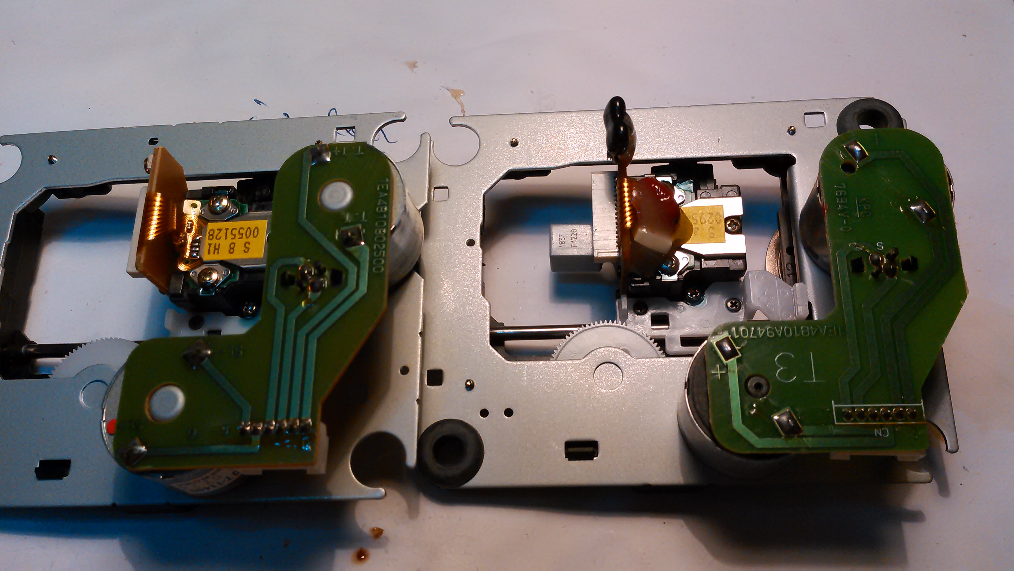

Have ordered few old Sanyo CD SFP101N-16P from ebay.
Interesting is that I got two different versions. One can be used with no modification in Shiga MKII, while the second need a small rewiring in order to get working. The easiest way to adapt the cable from J2 to CD mechanic.
The left mechanic in attached picture need T+(spin+) reversed with T-(spin-) and SL- & SL+ need to be switched with P-SW & Gnd.
In fact if you follow pcb traces is quite clear what you need to do.
So, in case you purchased a CD mechanic from ebay and this is not spinning at all, the solution si quite simple. 🙂
This will work for JVC EZ31 as well.

Hi Tibi,
I received my MKII. My package was squashed flat, but the boards and mechanism seem undamaged. I removed the solder blob and laser cover and applied power. The sled would not stop. It tried to continue advancing toward the turntable with the gears clicking away. All of my mechanisms do the same. Any ideas? Thanks.

You got the cable the wrong way. Just flip one side and it will work
Thanks Dimkasta. Fixed it. I'm listening to music now.
