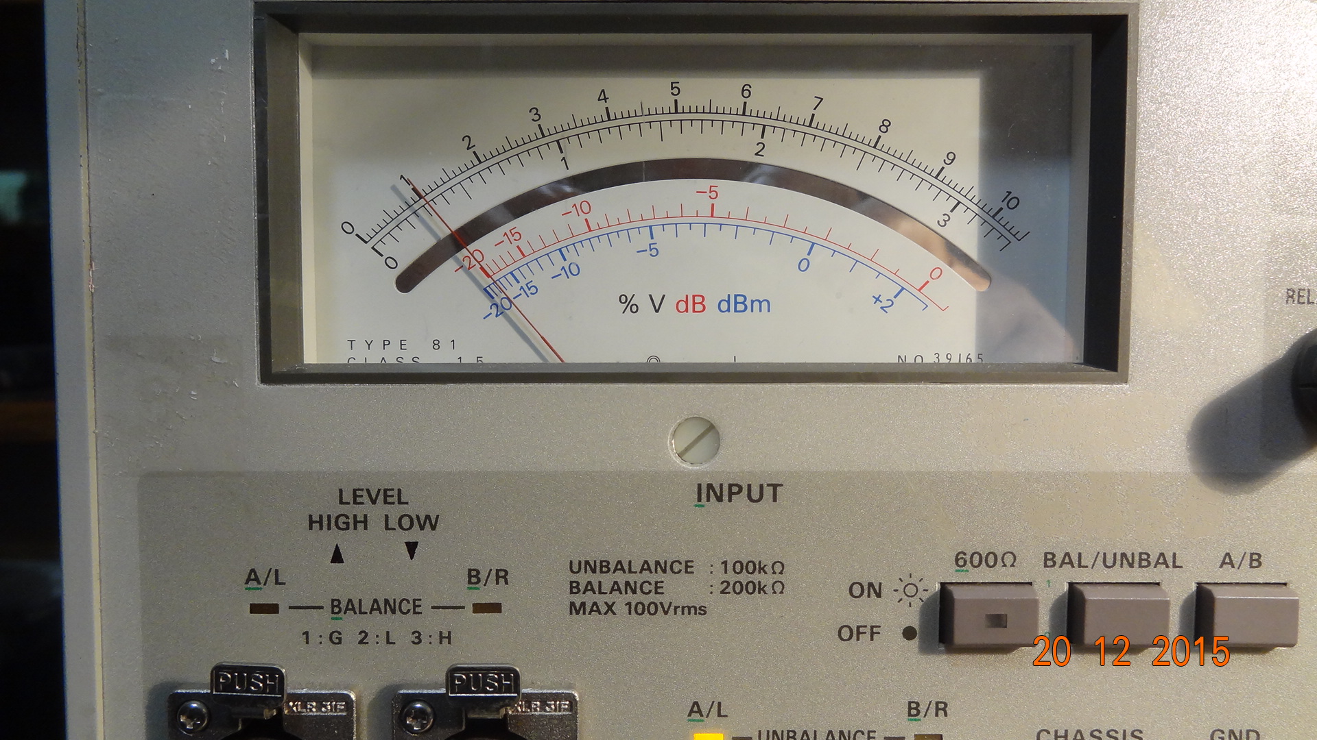

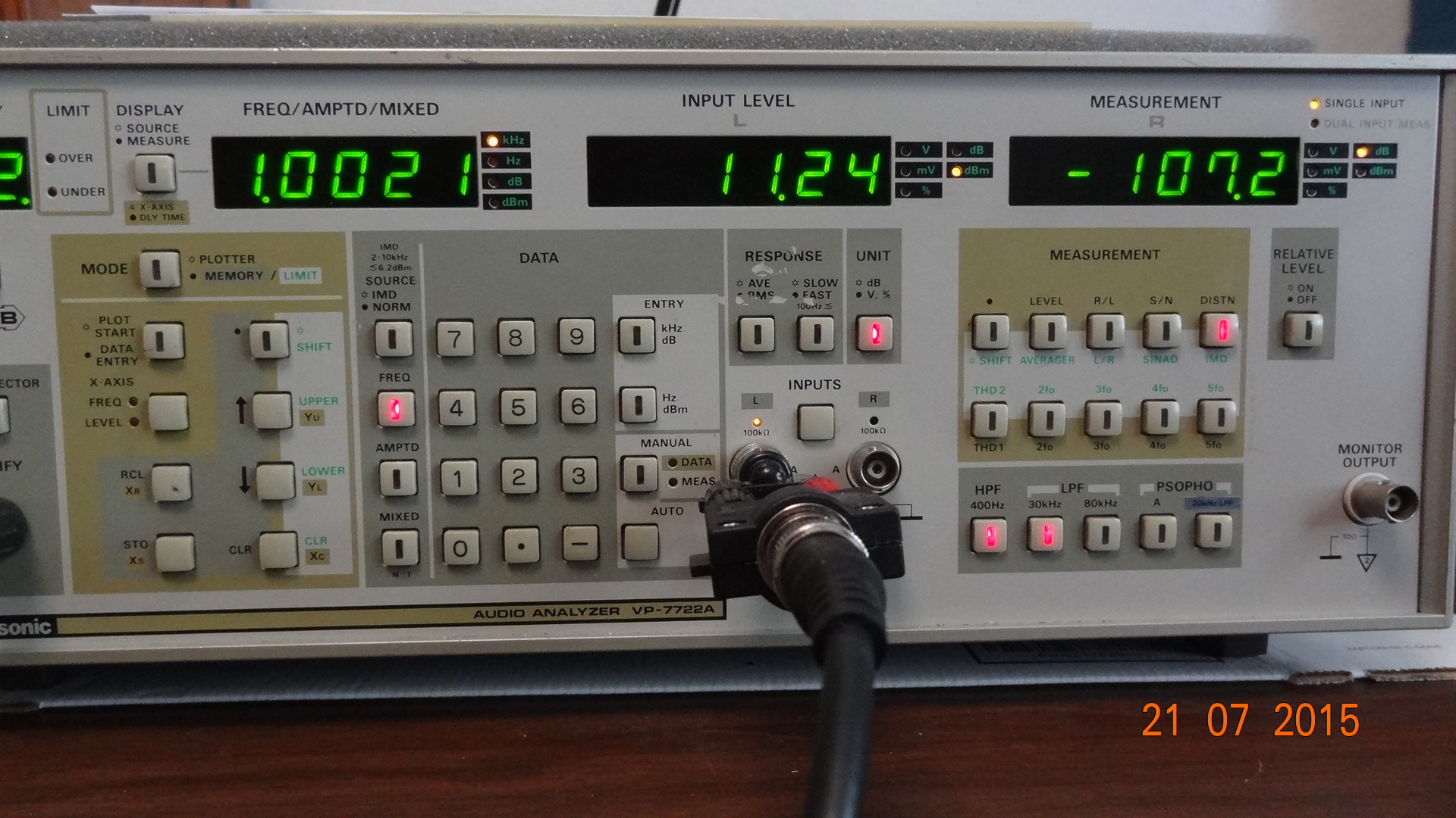

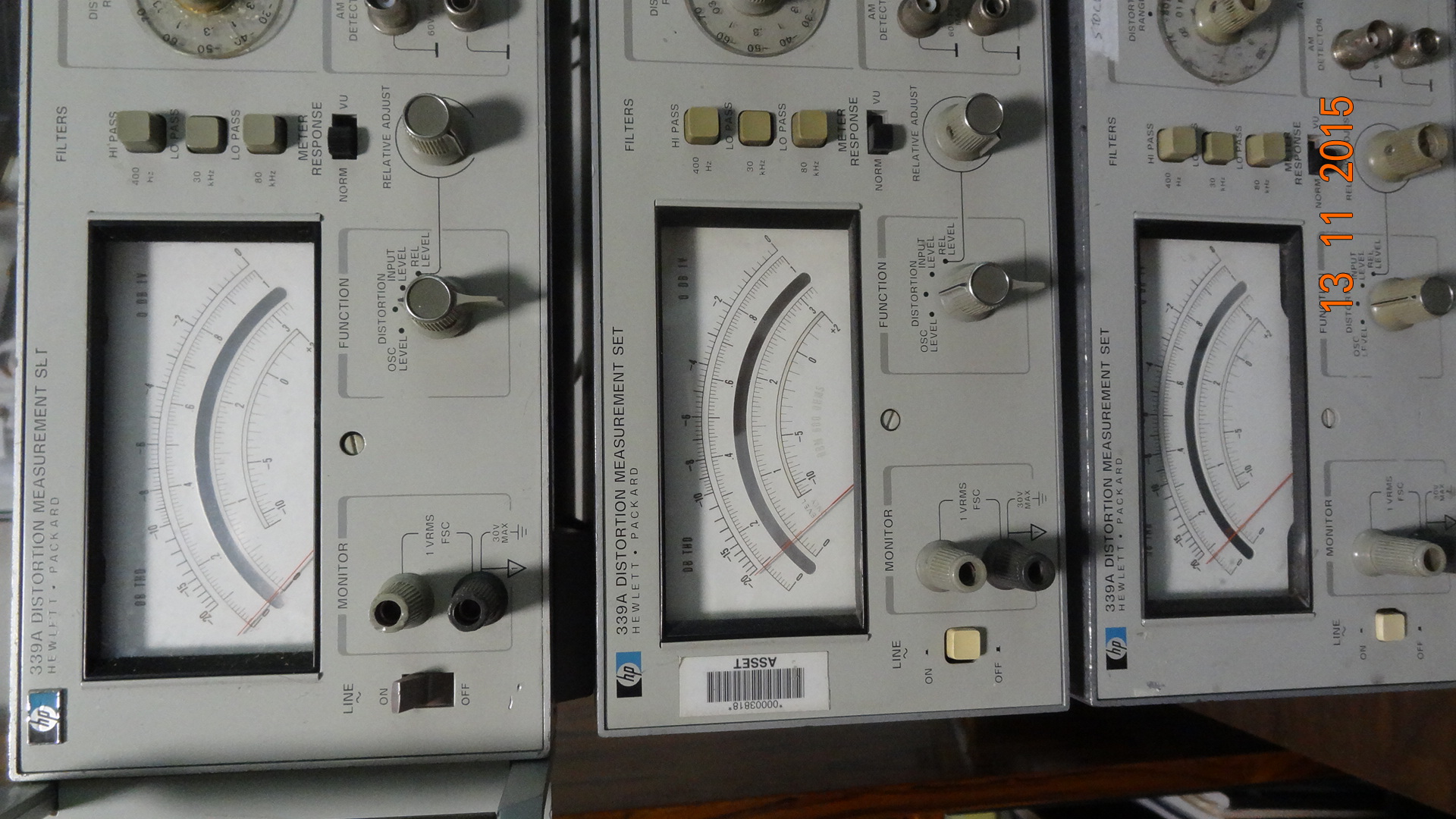

As a THD+N comparison.... the simple mod HP-339A does slightly better than -100dB while the full mods get close to -105dB . This is comparable to sound cards or external ADC. The unmodified Panasonic (which also does individual harmonic measurements like the ShibaSoku 725) does -107dB.
No idea how to or why the 339 pictures is side-ways. But it is right when you open it. (?)
To get better results than these leaves only the ShibaSoku 725 or Audio Prcision's best. The cost rises fast to get the very lowest test data levels.
Notch filters and an FFT can be added to the monitor outputs of the HP or Panasonic, however, to extend the performance. The cost of the 725 is about the same or less than the Panasonic. But the newer A-P is a lot more expensive.
BTW -- the Panasonic does IM and FFT as does the A-P. But A-P does many, many other tests. But for straight ahead THD or THD+N and harmonics (to 5th), the 725 is It..... and with some mods as David determined, it is even better.

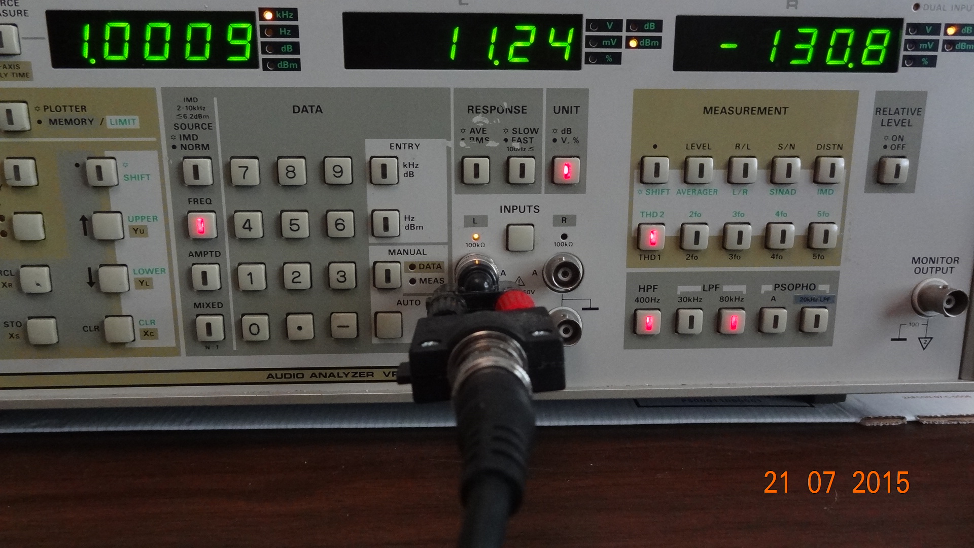

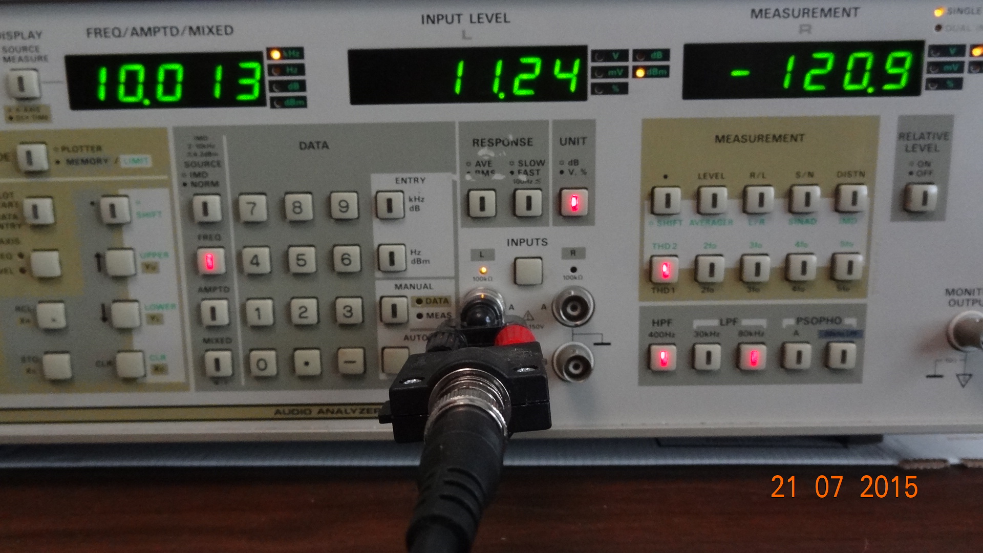

The Panasonic THD (Not THD+N) is shown here with internal osc --->
These are stock.... unmodified units.

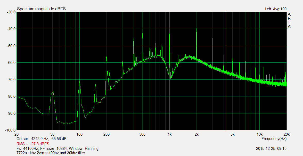

I took some quick and dirty monitor out spectrums of the Panny 7722A and the AM51B just for quick reference before I start tinkering inside. They are both using their internal oscillators. 0dBFS on ARTA corresponds to about -80dB (again, don't read too much into them, I'm not using a proper audio interface yet).
The AM51B looks pretty decent at first glance, interesting that it's missing the ~400-500Hz clock that the 725's use. There's some funny business at ~13kHz that I'll have to track down and tame.
I think the poor Panasonic desperately needs to be recapped and the notch filters retuned (same as the AM51B, a bit of the fundamental starts peeking through at anything above 1kHz). I'll post a BOM of the things needed to recap both units when I'm done with the teardowns. 😱
