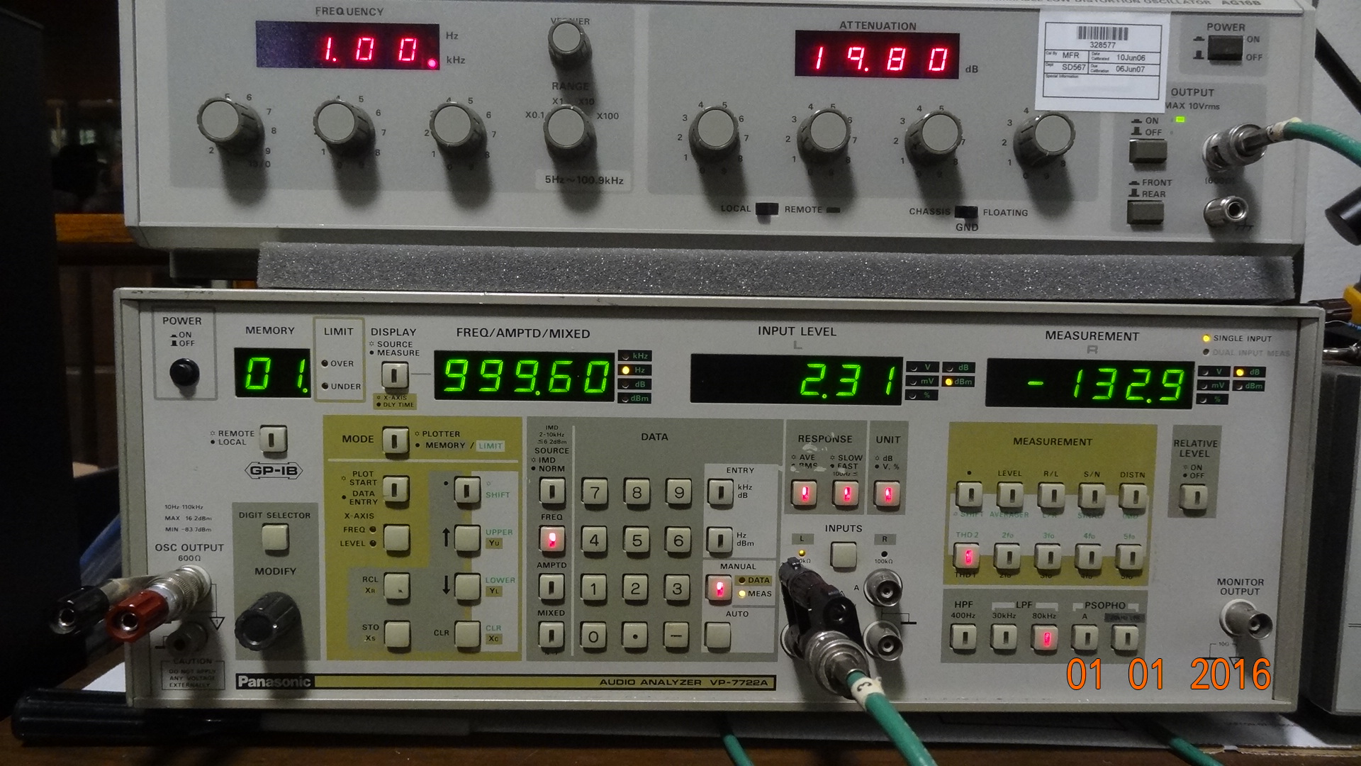

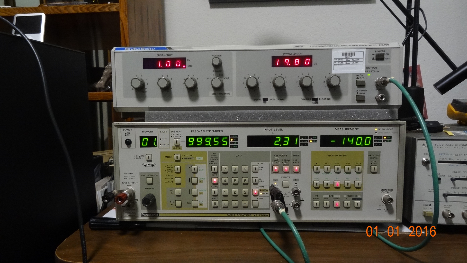

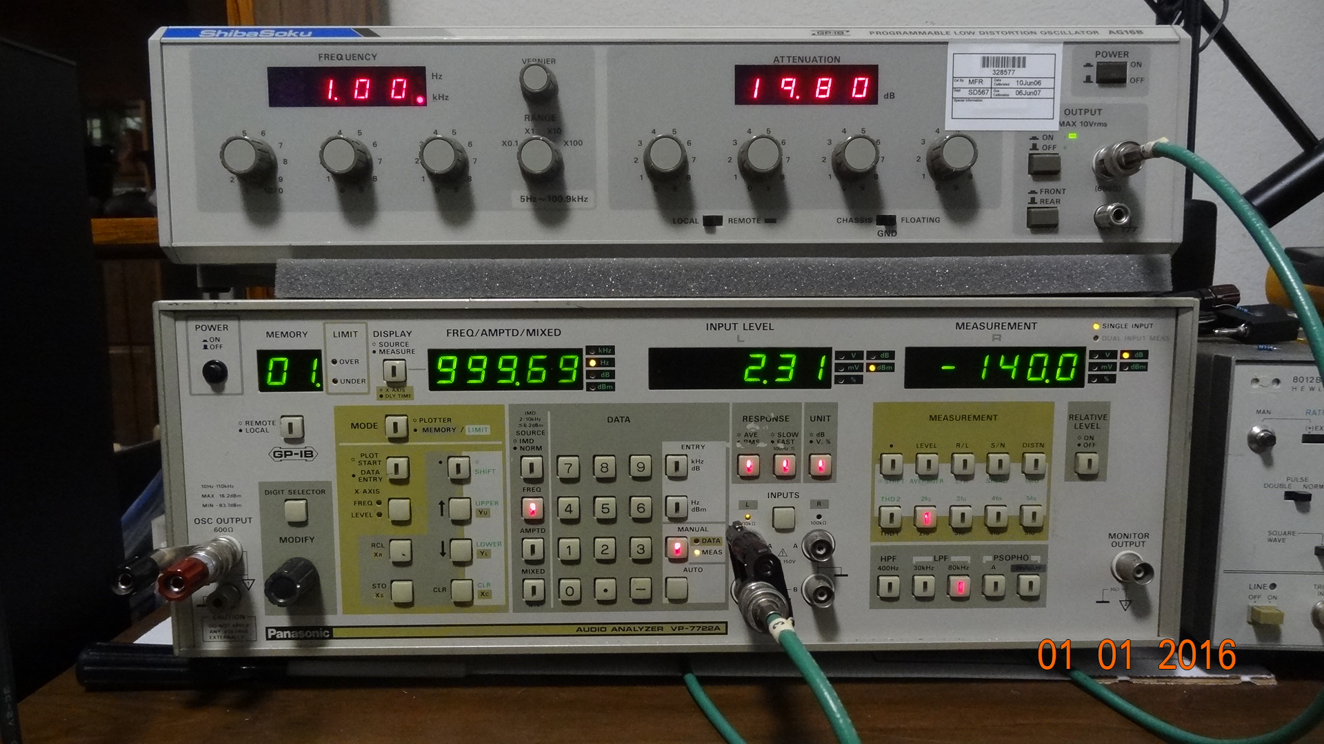

Tweeking the distortion on the AG16B; At 1KHz and 80KHz analyzer filter;
2h and 3H and THD;
OK but could be better.... 😎🙂
THx-RNMarsh
How did you tweak it? Putting a pot on JFET VR to trim D-G feedback factor?
I think AG16B do not have 2HD trim as a stock , as AG16A do not.

I used a probe into a VP-7722 and adjusted all trim pots to get lowest distortion at each osc/amp output stage (3 in middle).
I do not have schematic, though and could do more if I had one.

The distortion in the vp7722a is as low or lower than the AG16b....
Since the osc is included with the analyzer... it is a very good equipment package.
I am going to try to find the control jFET and add a trim pot from G-D to see what that does. A schematic would help a lot.
