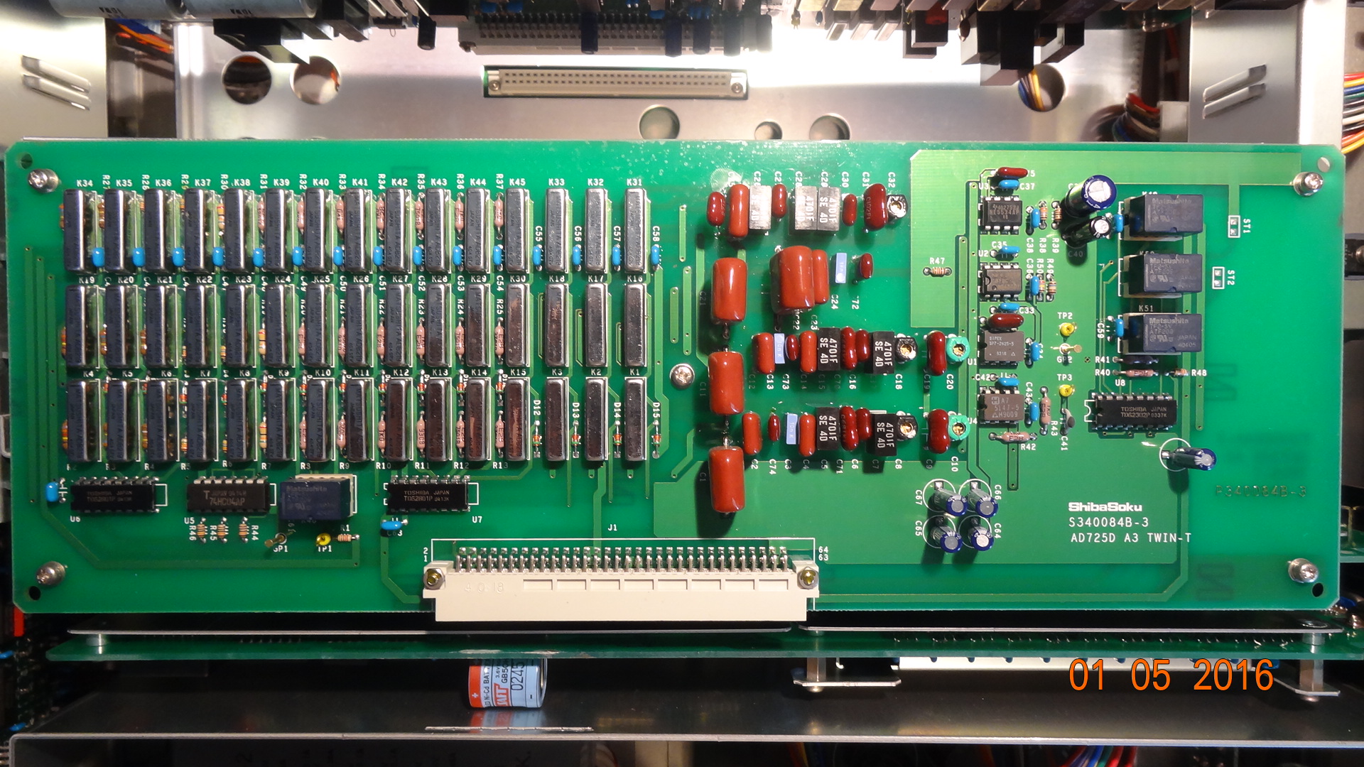

Can you post some pics of it?
Or, ADC board, but is that just the small addon board?
I found this of the A3 Board, look like this?

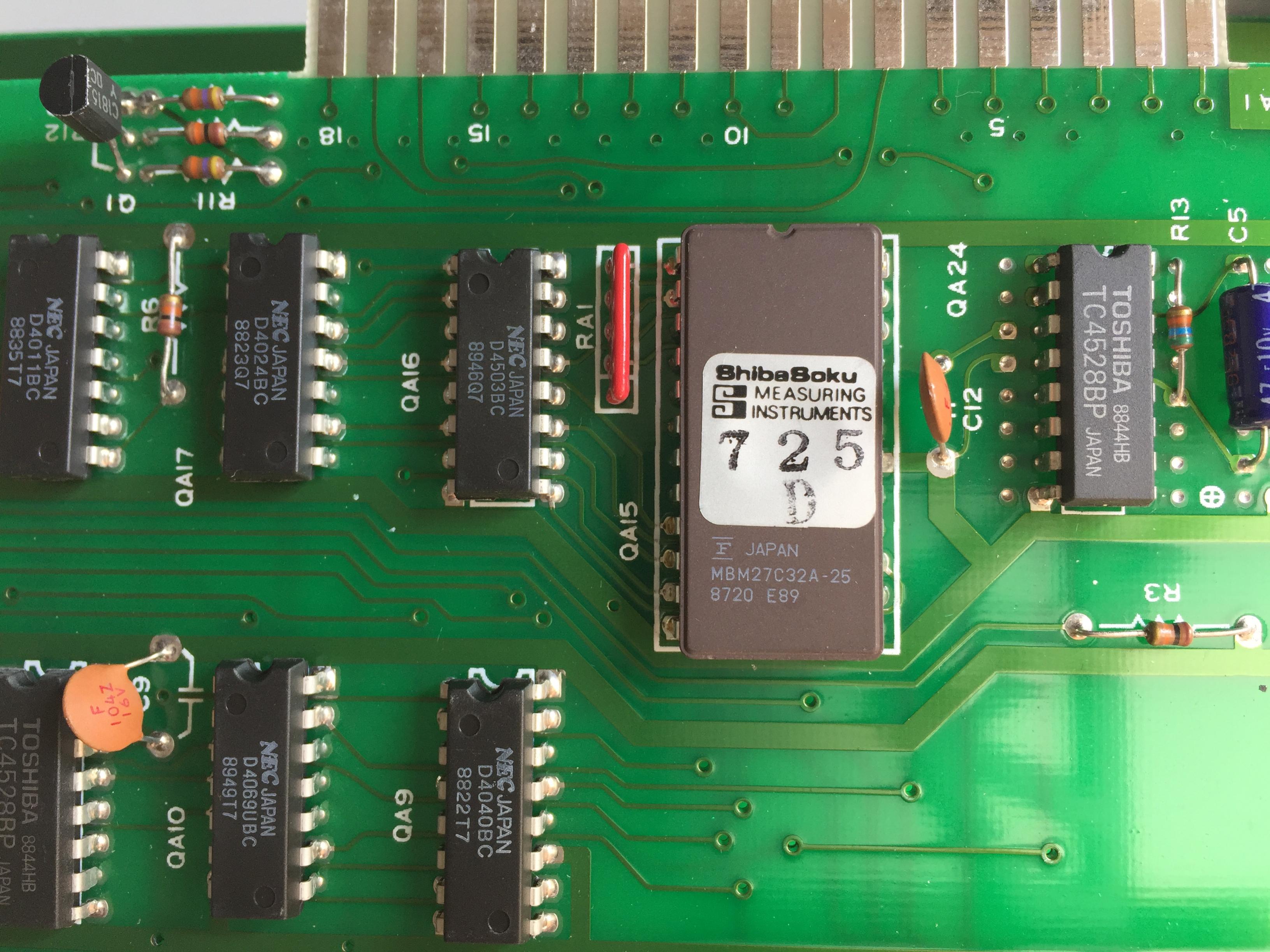

The 725 through 725C all use PC edge connectors. The 725D and other more current instruments from Shibasoku use a mix of Eurocard connectors.

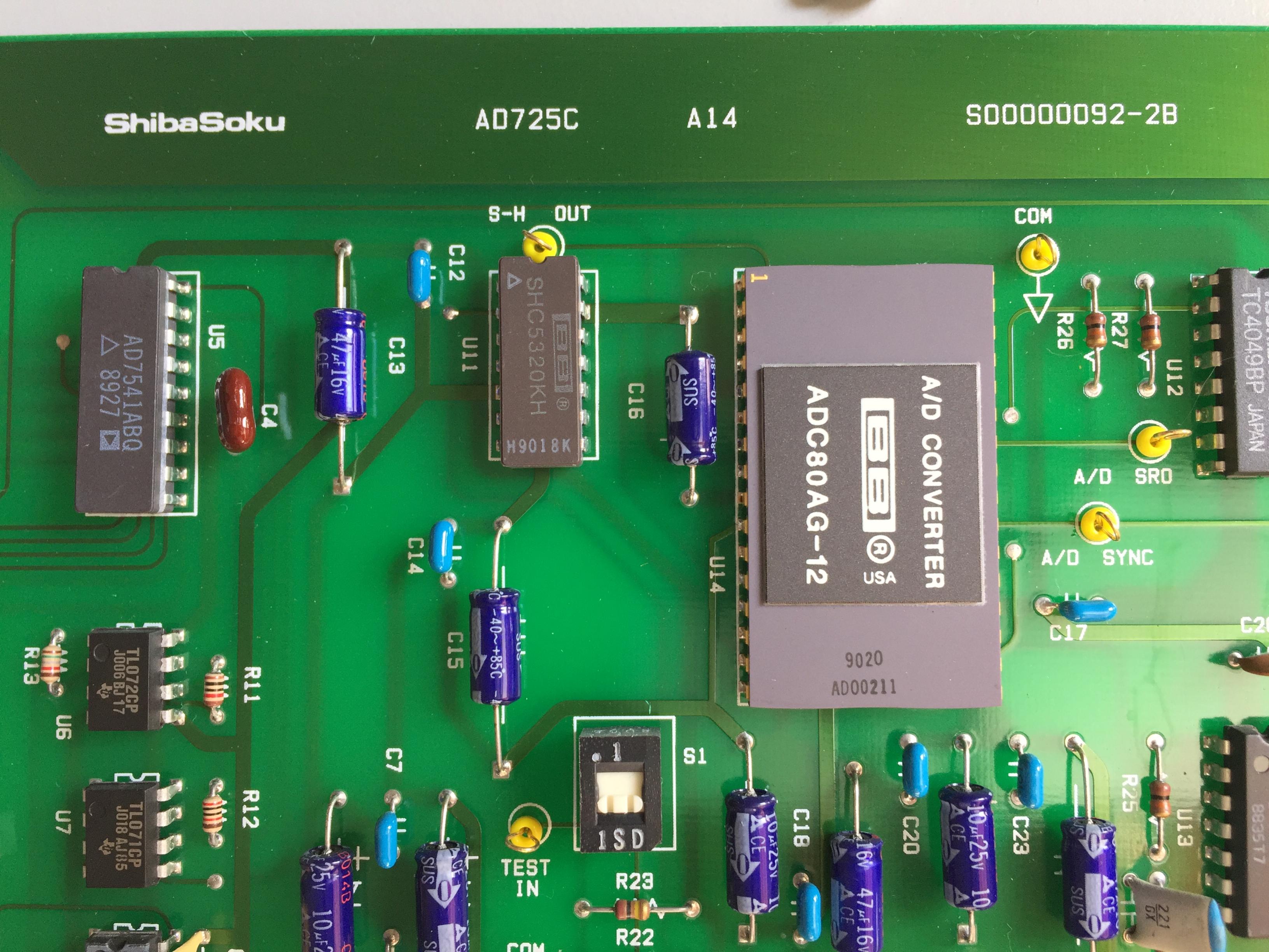

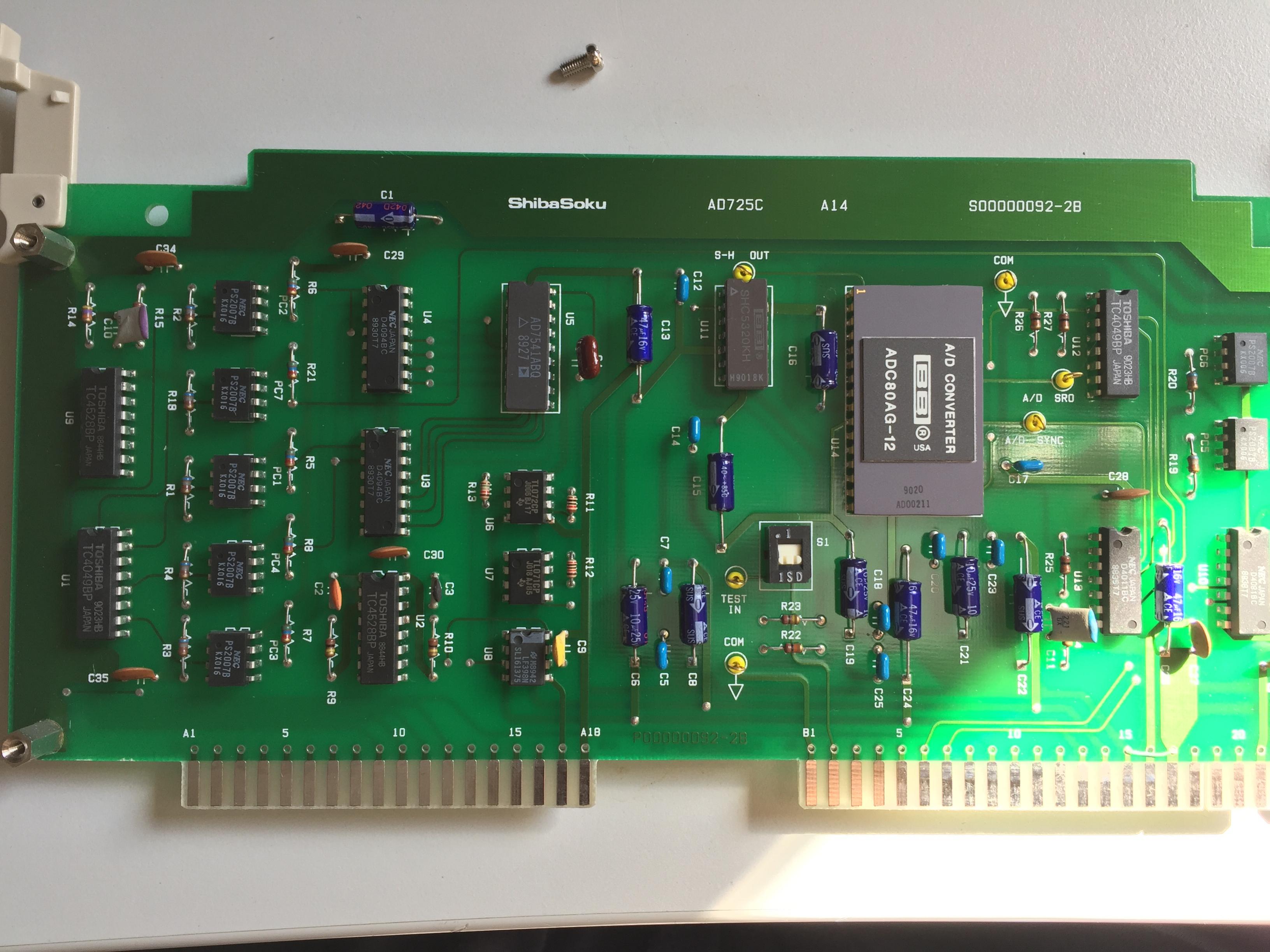

I would really like to see a picture of the 725C ADC assembly since my 725 has a failing ADC and I'll need to invent a replacement for a 30 year old ADC chip.
The 725C I got is some sort of hybrid.
A mix of 725B and 725C/D. The ADC has a label 725D on it.

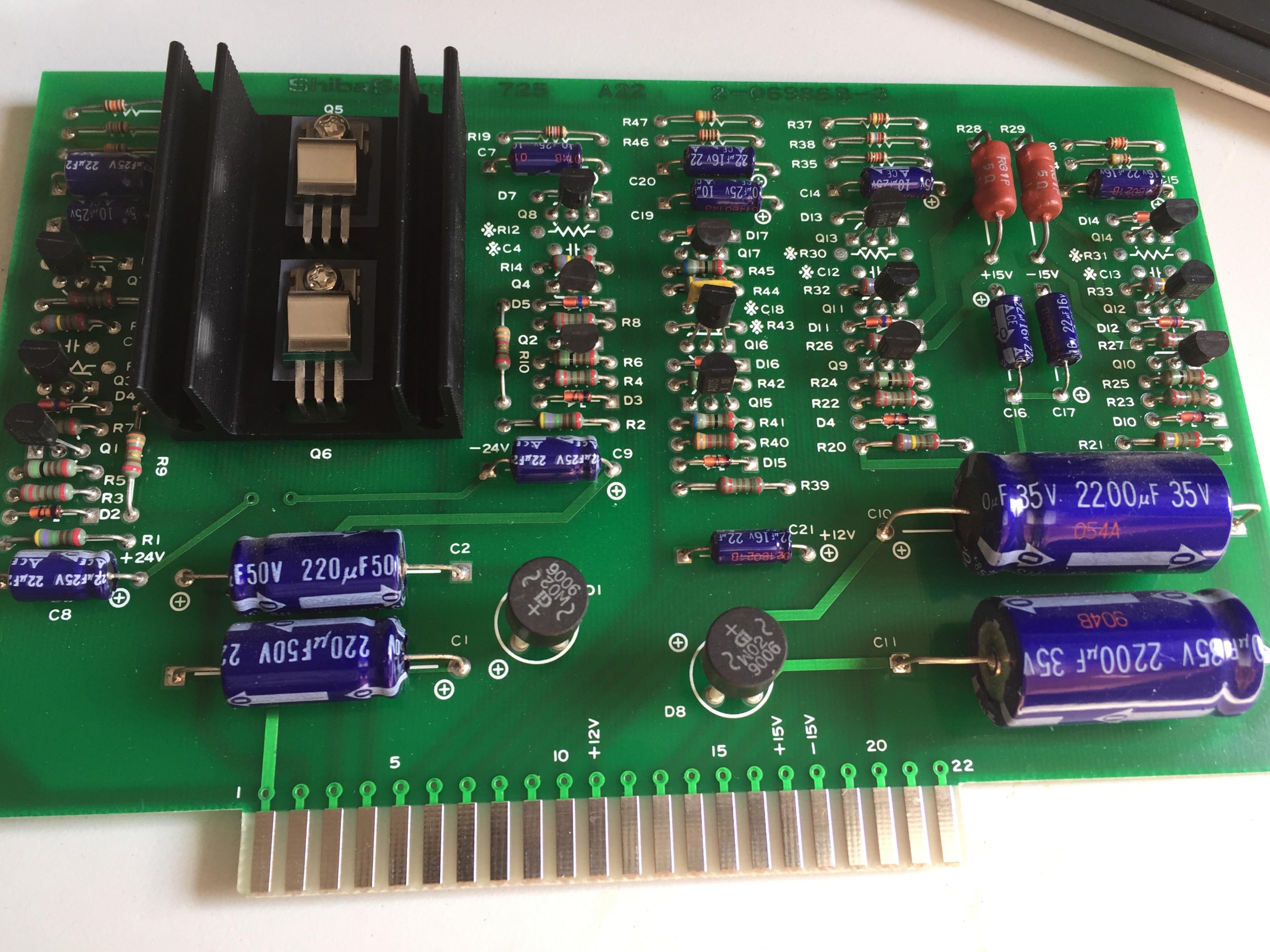

Might sound silly, but should I encounter magic smoke if I operate the unit without the "A" boards?
Believe one of my supply voltages is off.
The unit will be confused but it should operate fine with the boards pulled. I would do it one at a time and odds on you find a dead tantalum or electrolytic on the offending board. you should have +/- 24V and +/- 15V I believe for the analog supplies. A22 has the "regurator" for the analog supplies per the manual.

The 725D IC is on A13 board. ADC is A14.

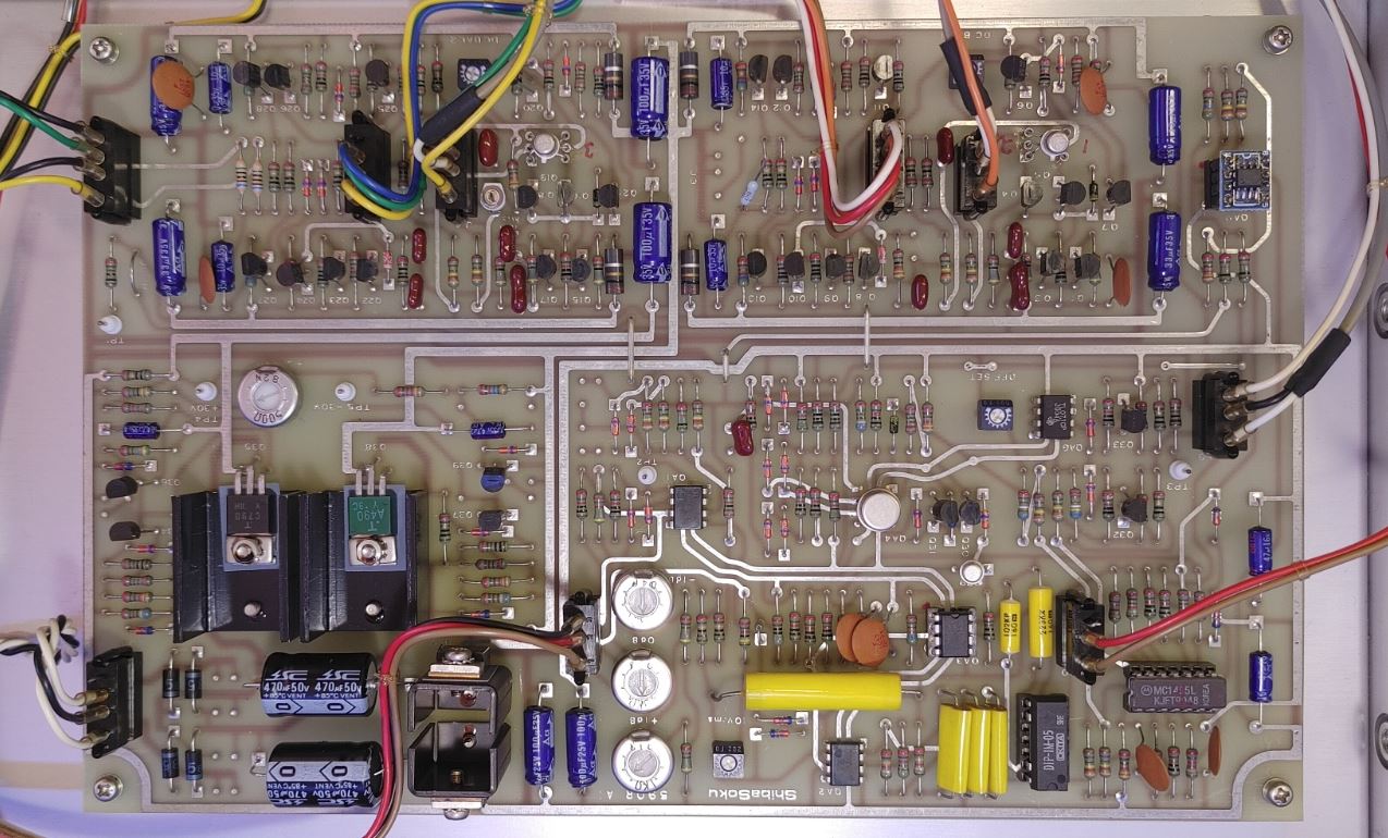

A22 PSU. Lazy to pull out the other one with 3 regulators (78/7915 and 7805).
Powered the unit with the GPIB board installed only.
Voltages are decent, some +/-15V ones are off by .3V.

ADC can be socketed and replaced easy.
The regulators are very easy to replace, decent space around them.
Modern variants of the old 78/79 design are much better, the Vdrop across them will be higher, however the currents are small.

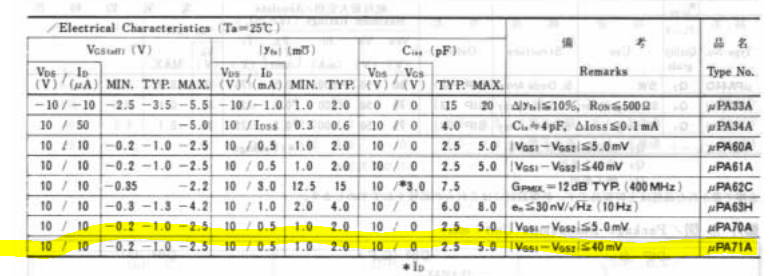

I know this is quite off topic, but while reading this thread, happened on the VP-7221A manual, which I went through. Seems it uses a dual jFet #uPA71A, it has four of them that I noticed. I have a blown channel on a B&K 2190 scope, where that part is the culprit. Has anyone ever located a good sub for that (unobtainium) part? I have been considering the LSK389x dual as a possibility? Any other suggestions? Thanks.!

Attached is the spec for the uPA71A. The key spec would be the capacitance and second the IDss. Too much C and the circuit won't work right on your scope. The linear Systems site is not an easy one to check specs but there should be several matches. Good luck.

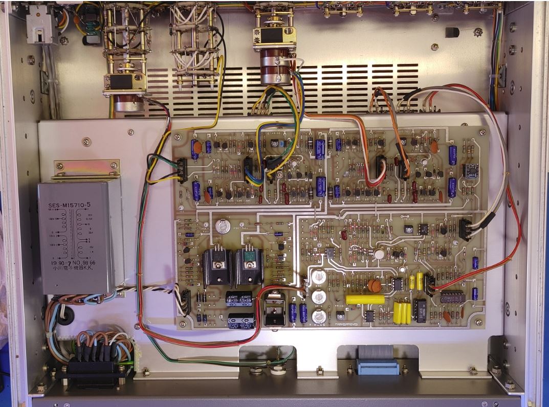

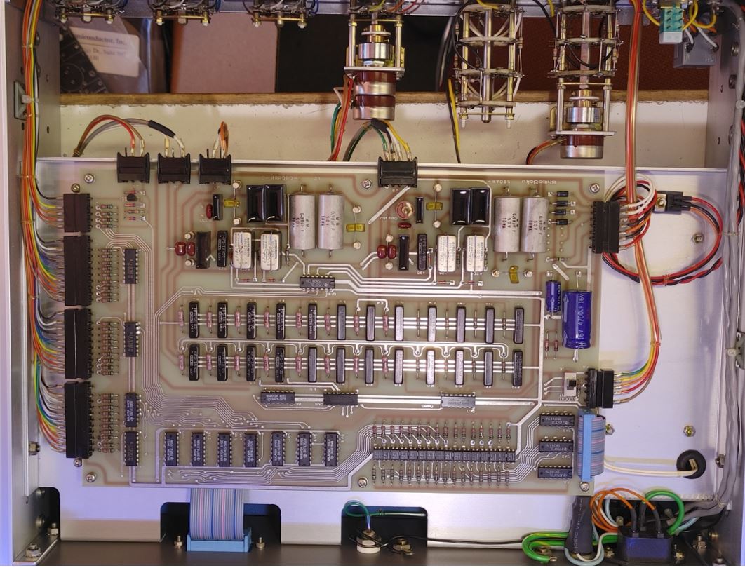

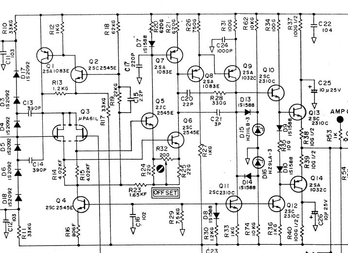

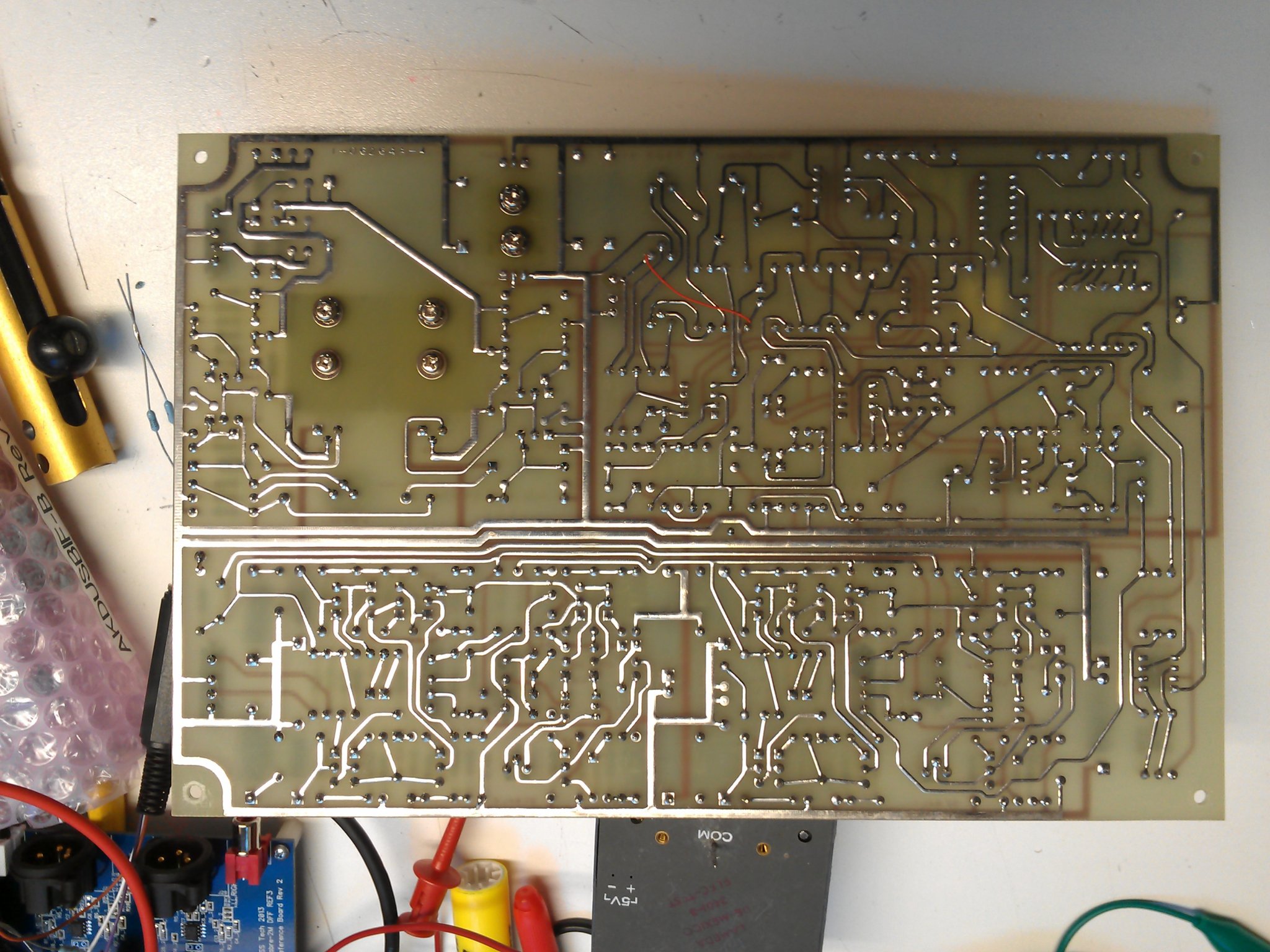

I have had a request for info on the Shibasoku 590AR oscillator. I'm sharing here because its the companion oscillator to the 725 analyzers (before the D version). Also because it shares basic circuit design with the 725's.
The 590 is a state variable oscillator with relay controlled frequency selection. The output comes directly from the second stage amp, no buffer amp. Internally it operates at 10V RMS from +/-30V supplies. It uses a passive attenuator for 1 dB and 10 dB steps. The +/- 1 dB adjustment actually adjusts the AGC reference voltage.
Adjustments without a really good analyzer will be pointless. I found a slight improvement with adjustment of the offset trimmers. The system level adjustments in the AGC are straightforward but the 10V adjustment and the "0dB adjustment do almost the same thing. Unless there is a serious level instability with frequency I would not touch the AGC circuitry. proper adjustment would be setting the sample time and sample width optimally to catch the peak of the waveform. And with no docs or instructions you could end up in a hopeless mess. Mine, which has not been touched in 30? years is flat to .01dB from 10 Hz to 100 KHz.
The circuit drawing is from the 725 but its used in the 590.
